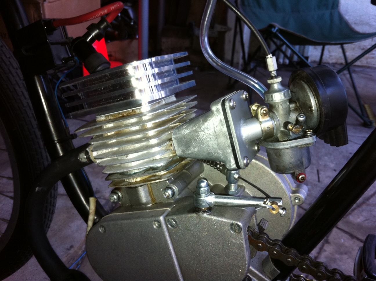

Here's my first post about how it worked... I should have just bolted it on & tested it without doing any mods; but i didn't...![]()
What I did right out of the gate was to remove the cylinder & cut a wide groove down the inside of the cylinder (from the base of the intake port straight down) to keep the intake manifold open to the crank case 100% of the time.
What I found from doing this was that the engine lost 80% of it low end power, but it gained noticable power from the mid RPMs all the way to full RPMs. It didn't gain any top speed, but now it has a lot more power! With the revs up, it can now climb hills that it couldn't before.
I'm going to experiment more when I get some time.
