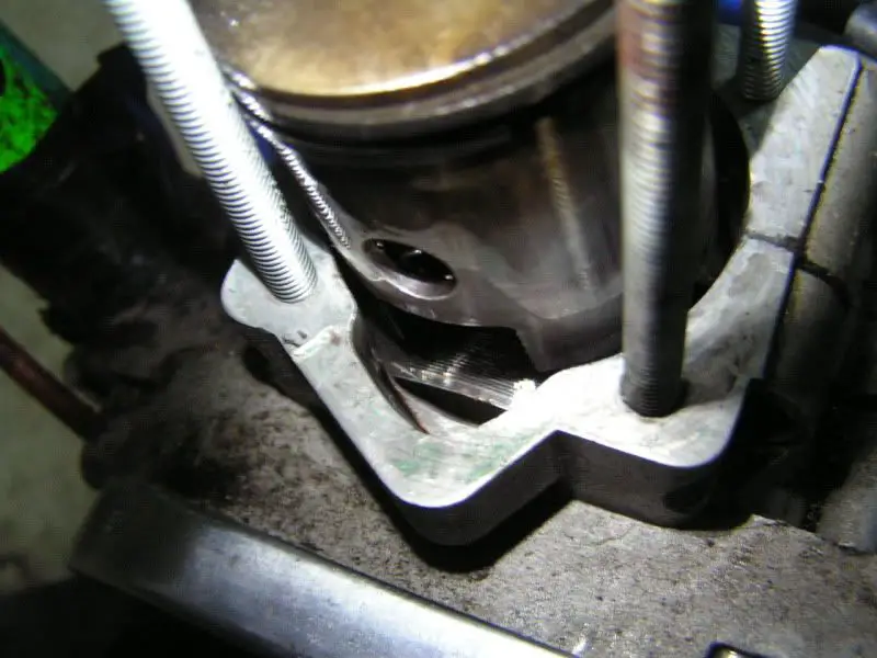

Hi there guys,

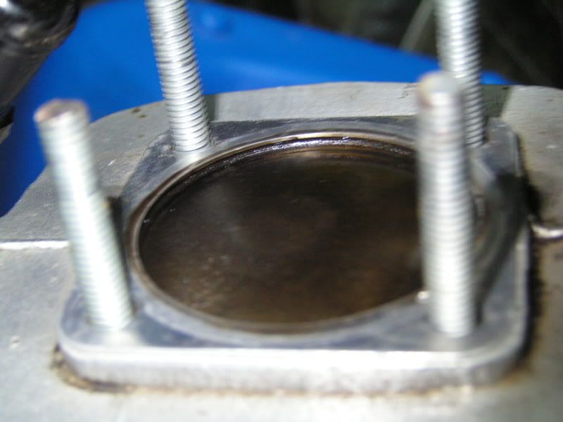

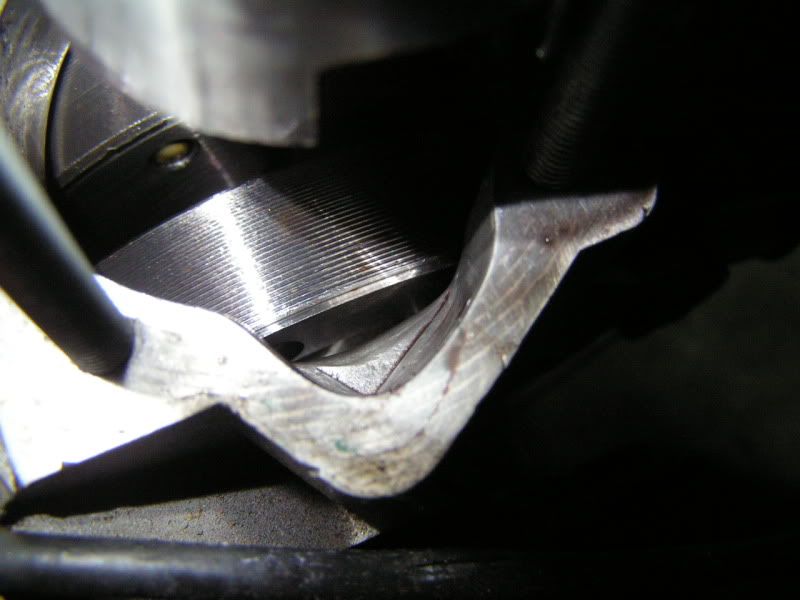

My first motor, 60cc, has broken the piston rings, and i opened it up, installed new bearings SKF, polished and port matched the transfers ports, installed a new base cylinder gasket, a new head gasket, installed all with stock exhaust, and stock carburetor.
The thing is: the idle is near the perfect (not really perfect) but is very constant and smooth. The problem is very simple, a tremendous lost of power. In idle it revs more or less, but in the road (with shift kit installed), it has lots of LOW power. it doesnt bog, it doesnt die, but revs very very slowly, what you guys think?
My misture ratio is 5%.

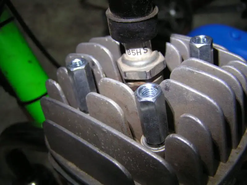

Other thing, i think the engine is very very hot when i take a ride of 1 or 2km.. (430F i measured on spark plug)
Thank you,
Daniel Maia

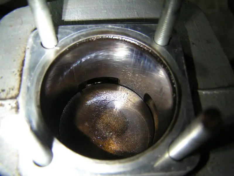

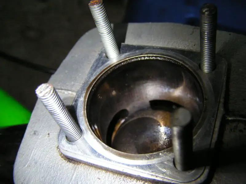

I have installed new piston and new 2 piston rings, new base gasket (original thickness) new head gasket. The cylinder is the same (it has a little surface scretches, but no big deal).

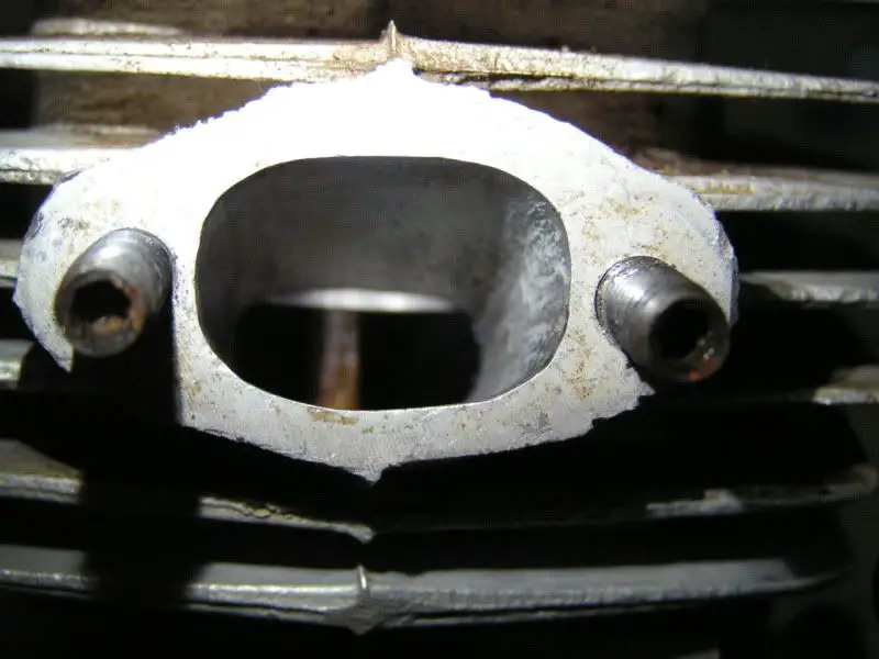

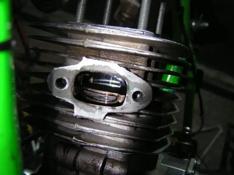

The only thing i changed it was the exhaust port, the transfers ports (the cylinder not changed), and nothing else..
I put a new seal on the clutch side too..
The working of the motor is completely 4 stroke. Only at climbing a big hill i heard a nice 2 stroke sound, but the power doesnt change at all..

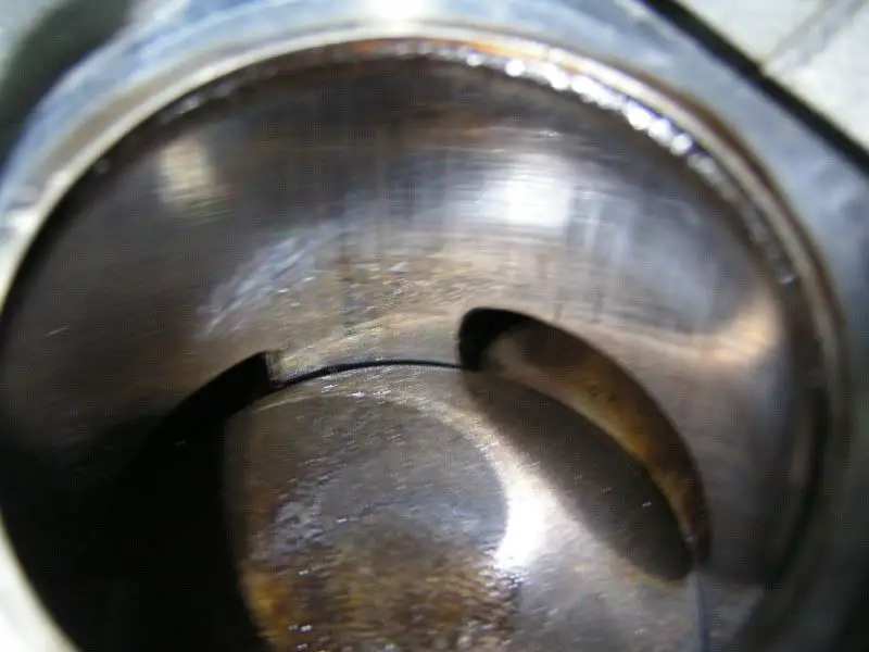

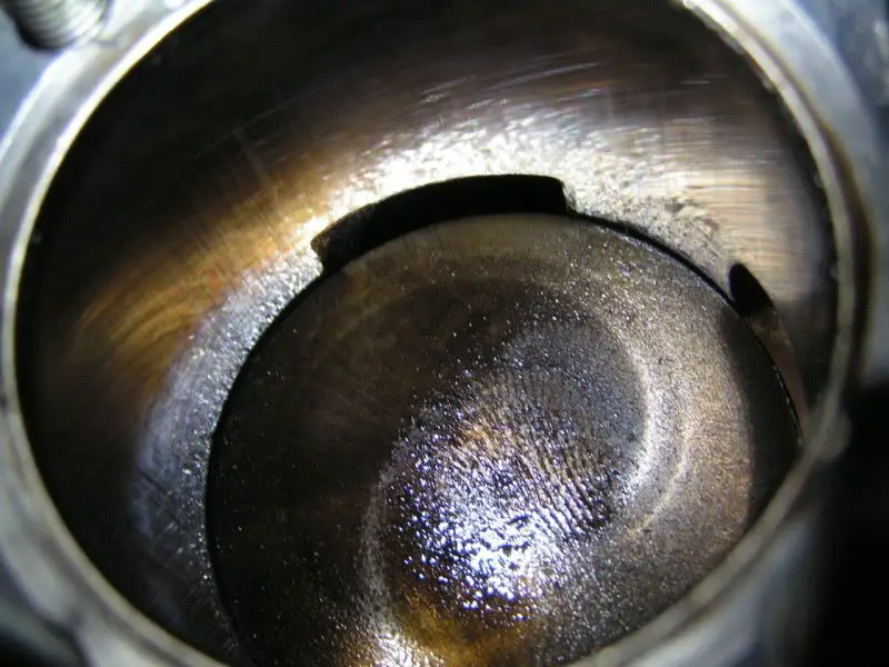

Those little scratches could be killing it. They allow the burning gases to blow by the rings and piston causing excessive heat.

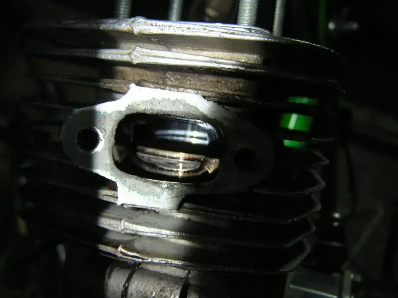

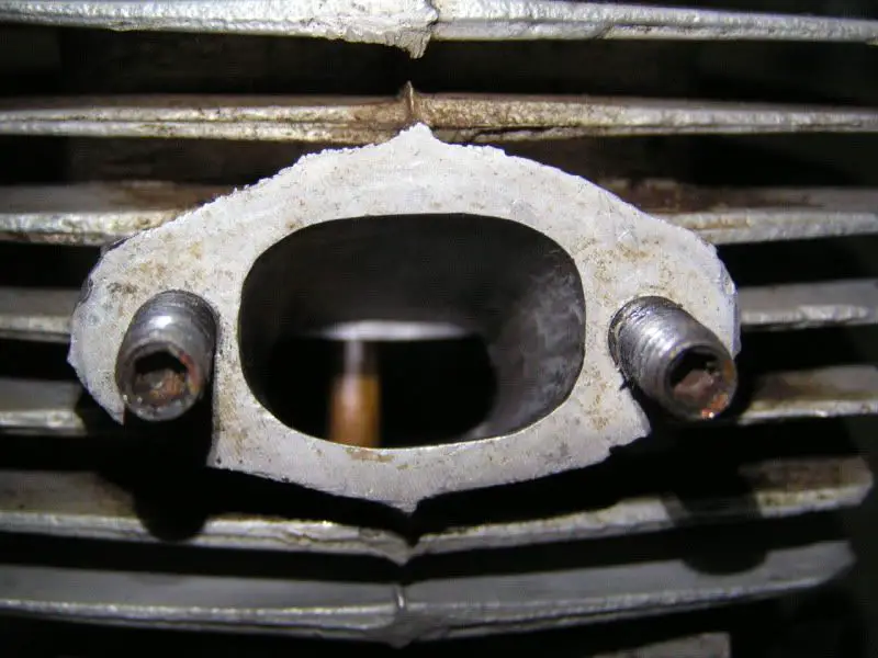

you said you modified the exhaust port? hope you only made it wider messing with the top or bottom will change the port timing.

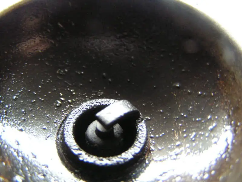

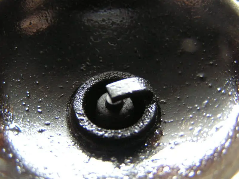

Have you pulled the spark plug to see just what it looks like? oily? If so then your running it way rich.
need to do a wide open for a while if you can chop the ignition check to see what the spark plug looks like.

Hmm, maybe i will take it apart, to see the cylinder, but its weird..

The exhaust i only polished it around, and i think i take 0.5mm on the top..

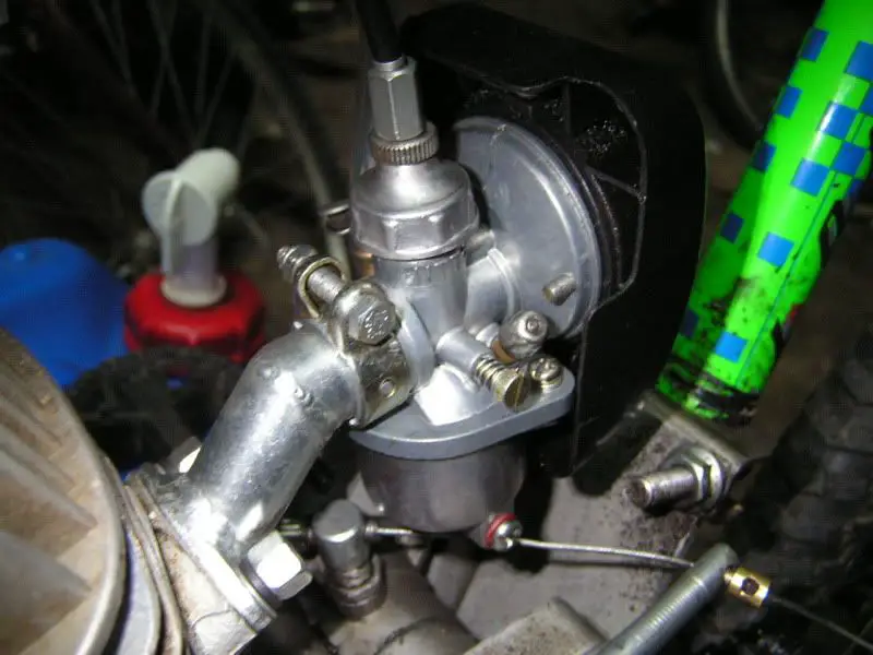

did your engine run good before all of the problems?
Do you have the carb needle set at the usual stock setting on the c-clip?
could be your carb isn't set properly.
One of the guys had a carb where it would idle good but would not rev up. He sent me the carb and it did the same thing on my bike I found that the needle was tapered wrong and it was only like 0.003 off on the taper I chucked the needle in my dremel and using 600 grit wet/dry sand paper , put the right taper on the needle. Plus a lot of measuring it with a mic against a known good needle. That is or can be a very sensitive needle and just a little too much or not enough taper can make the engine run either very well or terrible.
So you may want to look at the carb. I doubt if your carb is too small as long as its the carb that came with the engine, if you've put on a different carb then it could be too small or too large or even just not set up properly.

I said that because i ported the 2 transfer ports in the "case" (im not remember the correct term). I mean, the 2 transfer ports on the engine (not the cylinder) was port matched and polished.
I think that is nothing wrong with the port matched because is only that: port matched.
Leaks, i think it dont have at all...installed with strong threads, with all new gaskets, and stuff like that.
Yes, you may be right, because this engine it lasts 2500km, never run so good (very very "leakage"(lots of air leaks, but my knowlage was not so good)) as my 66cc engine, it vibrates a lot...but even so, its very weird..

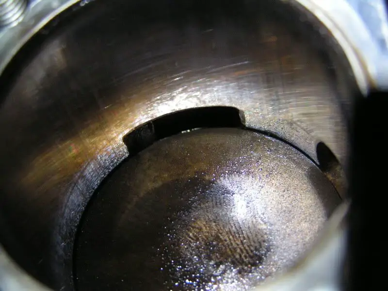

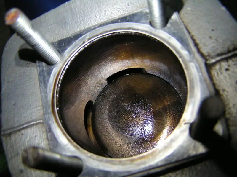

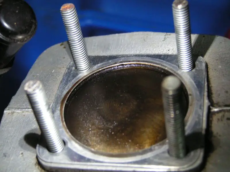

From what I can see it don't look bad.
You probably need to change the spark plug, I don't know what your running for spark gap but try 0.020 to 0.017.
You may also try 32 to1 fuel mix. I looks a little oily and to me the plug looks a little oily and maybe a little cold you could try a hotter plug( only go 1 step hotter) or just a new plug with the gap I recommend.
You got some nice photos.

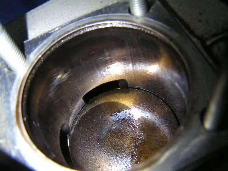

Thank you Norman, and i can say it's problem solved :)
The gasket of base cylinder was leakage, installed 2x new gaskets, and it's near the 2 stroke sound i like :)
