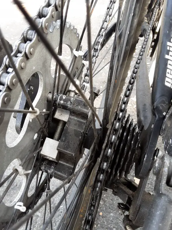

Lewdog- I’m not completely sure what you did with the hub adapter- looks like the Allen bolt is being used to pen against the hub? Then an extra clamp, the silver piece- screwed to what?, the sprocket or back to the first clamp. I do like the idea of increasing the surface area on the hub as rick mentioned.

First thanks for the props & you're welcome! Next I think Lew. has strengthened the adapter grip by his mod. It appears that he purchased a very narrow hub adapter as did I once long ago. I couldn't get mine to hold at all and later modified it for a disc rotor mount...worked well for that. The best hub adapter I've used is the Sportsman Flyer adapter that is three piece clamp, wide clamping surface, larger bolts and the sprocket towers are longer to help clear wider tires. These cost more but are worth every penny, well machined for a tight fit as far as I know they are only available to fit 1.5" hubs. I won't build a bike with skinny hubs one reason being lack of surface circumference to hold a hub adaptor in place and typically weaker bearings.
All the other adapters, which are made like two piece Manic mechanic, are knockoffs & may be poorly machined tolerance wise. The original Manic is a well machined adapter, but lacks the added design features of the Sportsman mentioned earlier.

Also the metal piece between the adapter is just an aluminum clamp that I put there to prevent the clamp from sliding towards the spokes which makes the sprocket miss align and then the chain problems begin, AND yes that is an Allen bolt I inserted taped and threaded ,so as for clamping to the hub the extra bolt helps big for the different diameter hubs ,

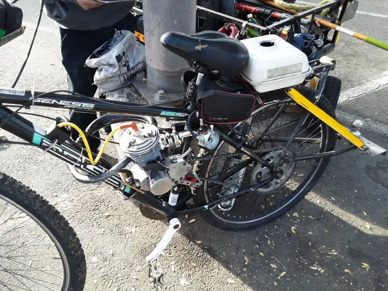

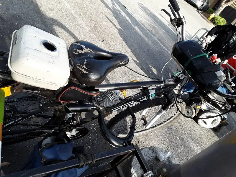

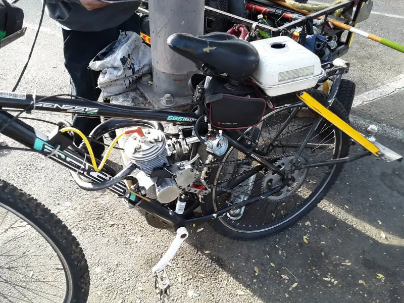

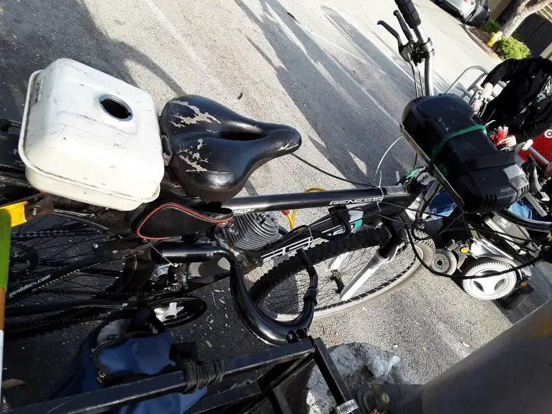

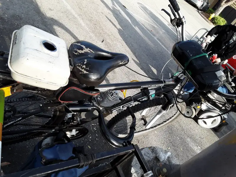

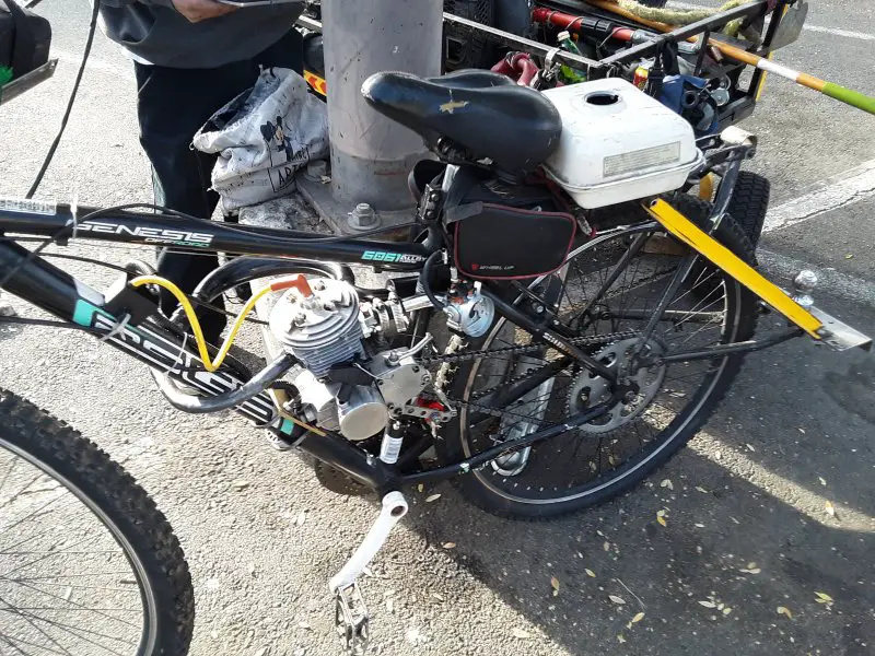

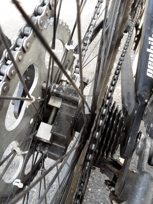

update I have completed the work bike build with the hub adaptors one I purchased from b.b.r,,one I made to work with , details , Coleman gas tank ,I think 49cc exhaust I think small expansion chamber bad buy but for now its working and top end rebuild 66 zelda parts not ported or polished but open transfers and the ex,Int portsare bigger,raised the with2 gaskets to clear the ex port and b.d.c., and trimmed the piston skirt to clear the int at t d c and so more squish and hi comp head ,pee wee exhaust and rung tung carb is total garbage but it gets me to work for now ,ultimately 21mm pwk ,better exp pipe with muf ,and gas cap
Got some picts
Got some picts View attachment 102878 View attachment 102879 View attachment 102880
Lew that adapter should stay in place. The bike is coming along famously. Getting the motor sorted on everyday transport is a big deal. I've built several motos over the years with rear mounted tanks and there is a plus to this when it holds more fuel. The other thing I've done is run a kit tank up front on long rides; then I'd never worry about find fuel along the way.
You've done well.
Rick C.
