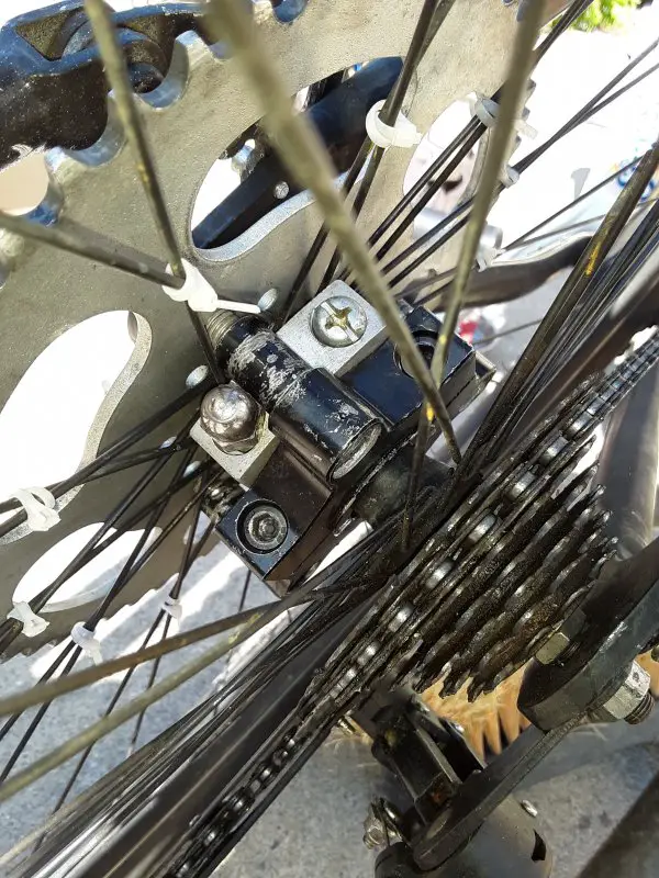

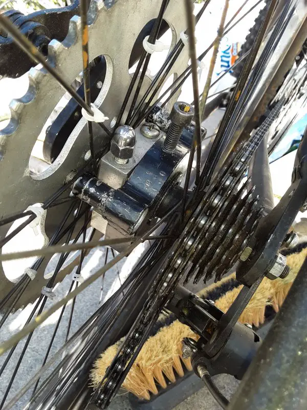

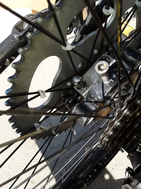

check it out guys I got the hub adapter but I drilled a hole taped it and put a bolt in there to tighten to pretty much any sprocket and the spacer in between the spokes for the gap it works well
This is the easiest solution. Sprockets from 40 to 60t, brake, freewheel, 17” tires can be found just about everywhere from moped tires to small motorcycle tires. All setup for a 12mm axle. And it’s a rear wheel you can grow with. No sudden problems when you move up to a bigger motor with a rag joint.

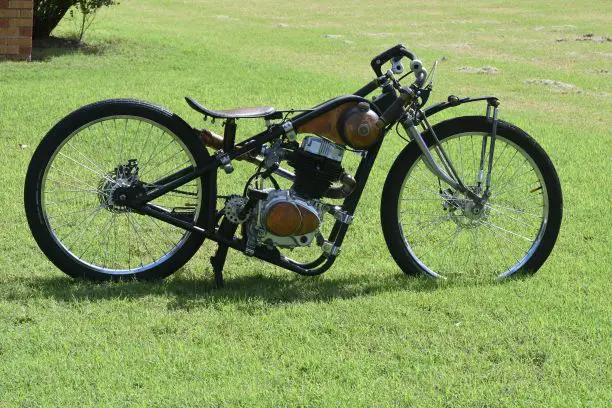

Since I mostly build vintage style bikes that have the early twentieth century look. I've used mostly bicycle "clincher" wheels and tires to capture the look of what was used in those early days, not because they are better...they are not, but with quality tires & tubes I've found they handle sustained 30 to 35 mph cruising speeds well. Relatively stock kit motors using 36 tooth sprockets can typically do this on flat roads without too much engine strain and in some states 30 is still legal if I'm not behind on legislation rules and regs.

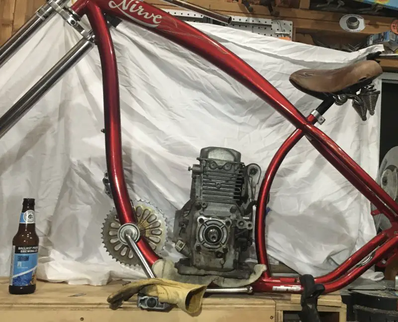

Not confused at all- thank you. I will be using a handy CG160. I actually bought 3 of them - $50 each. I’m debating how to mount it now. Thought about welding (I need to learn to weld) in a mount, but if I find something bolt on I might do that.
Your thoughts on trans and sprocket?

Well I'd probably go with the 3 D manual clutch using a bottom bracket style reduction sprockets & wide pedals. The GC 160 make about 5.5 hp at 3,800. So I'd try 12tooth motor output to 24tooth reduction input to 10 tooth output and depending on what cruising speed I want....select a rear sprocket I'll calculate whatthat looks like with a 26" rear wheel and get back to you in a bit .
That's theoretically 45 mph with a 38 tooth rear at 4,000 rpm, just as an example that will give you an idea of what to expect. I'd not spin the GC faster than that with out some valve train works especially stiffer springs. If you disconnect the governor you have to go easy on reving this thing. Single speed.
Moto Mags did a GC 160 with a CVT and he likes it as many have using various engines.
High end cent. clutch like the Bully is also a proven way to build a drive train and using the reduction drive I described above, but with different drive ratios. Jack shaft can be used in place of the bottom bracket reduction drive as well on the 3D and the Bully clutch ...Sportsman offers a specially modified version of the Bully for use on moto bicycles rather than go carts that are setup way different for small diameter tires.
None of these are inexpensive setups & all have proven they work. These are three of my favorites, but there are others like the final belt drive with no clutch that are frequently built classics.
Pick your favorite and deal with it, all use 3/4" outputs.

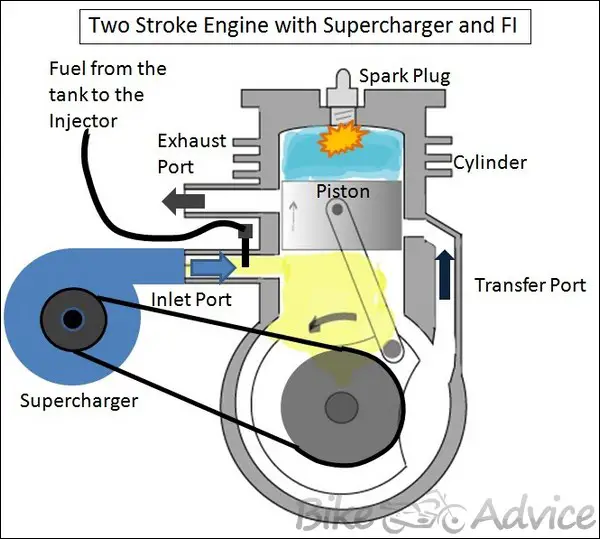

The 2stroke supercharger on a 2hp CG won't work well, requires too much power to get it pumping. However the new electric driven superchargers powered by lithium batteries would pump instantly on demand. It would be costly. Zeda has a video of a CG, highly modified, billet block CG (80 cc ?) on their dyno that puts out almost 17 hp @ 9,000 rpm also quite expensive. I'd think that would power a purpose built bike 90 plus with a small fairing.
