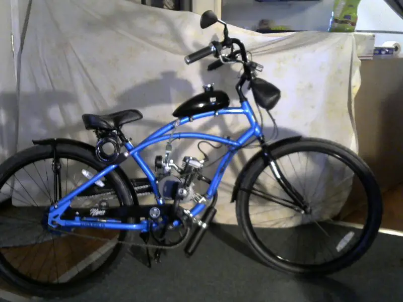

I've built 2 using new bikes ordered from walmart, a 26 inch hyper beach cruiser and a 26 inch kent avalon. I havent had any more trouble than is going to be common to any china 2 stroke motorized bicycle. anything that isnt locktite or double nutted is going to vibrate loose. to my view maintenance is just a given with this hobby.... kelly

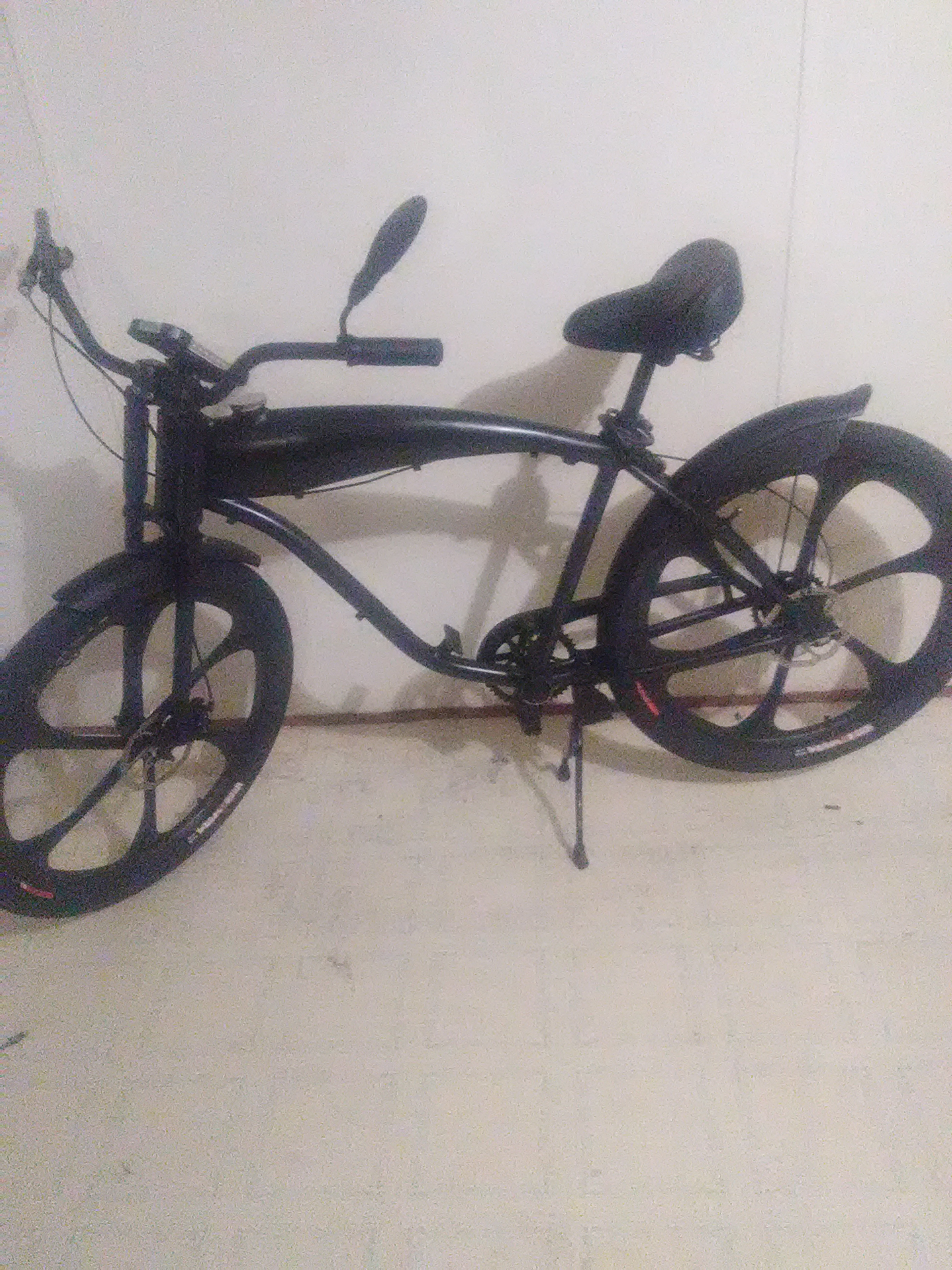

I'm trying to get one with a steel frame so down the road I can mod it for more power. How can you tell if it has a steel frame? I was thinking about this one.

RUSTY - Use a magnet on the frame. I would however, not feel safe on any motorized bike with a single brake system, and I will avoid a coaster brake completely. Good luck and have fun and be safe...

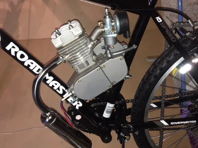

Here is one on a roadmaster, doesn't get cheaper than that. No problems, it worked out perfectly and was a comfortable ride. I do suggest you find a bike with front suspension, you will be very happy if you do and unhappy if you don't. Larry

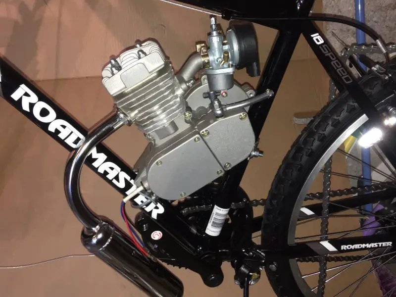

Is this the same Roadmaster bike? Has 26" wheels? It's $98 at Walmart? If so, I'll probably get this one since its cheap and would be able to do my build on it.

Not sure about model. Would look at a few bike assembly videos. Small things can make your ride safer.

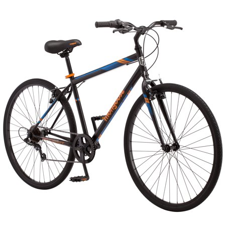

Built mine on the 29" Mongoose from walmart. Put over 100 miles on it so far, no troubles.

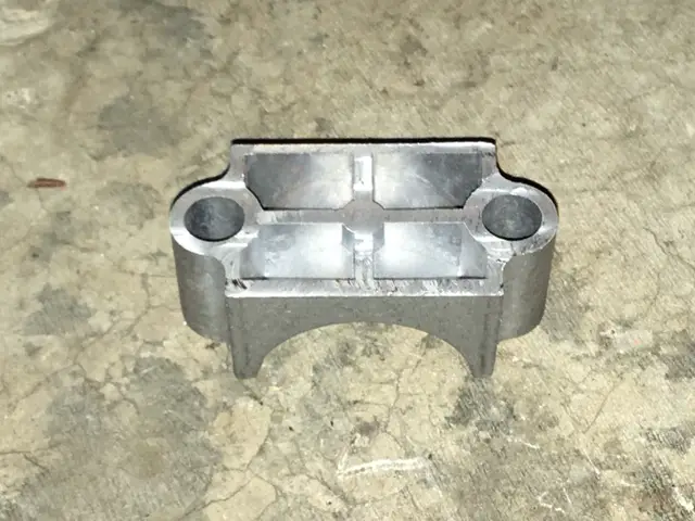

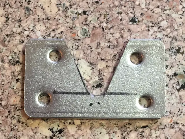

The only thing I had to do was to slightly modify the mounting for the engine so that it would sit lower in the frame to allow the air filter to clear the top bar. On the cast part I shortened it some, I have a milling machine so I milled it off but a hacksaw and file would do fine, the mounting plate I cut a v in so that it also would go slightly lower in the frame, this worked out perfectly for me and the bike was very comfortable to ride and is probably one of the smallest frames that will let the engine fit without major alterations.

I also did have to do a little shimming at the rear wheel to help align the sprocket but that happens on other bikes also. I remover the derailer on the front sprocket but left it on the rear. You will definitely appreciate having some suspension on the front fork. Larry
