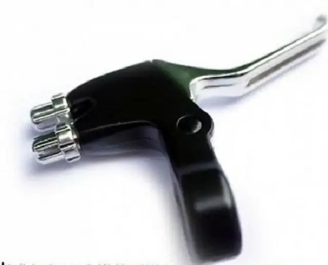

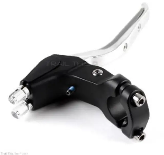

It will also make life much easier if you get a double pull brake lever. There are a couple of types that look very similar but are really quite different. There is a vertical stacked type and a horizontal stacked type. The vertical type pulls on the center of a bar that has the cables attached at each end and the horizontal one pulls on both together hooked directly to the lever. The vertical type with the bar evens out the pull on each brake by allowing the bar to pivot on the lever, this seems good however there is a little flaw, if one cable breaks or comes loose the lever will then slack off on the remaining cable take away some of it's travel which may make the remaining brake less effective. Not sure what is best, but just be aware of how they work. You can find both for about $11.00. I use the horizontal one. Larry
