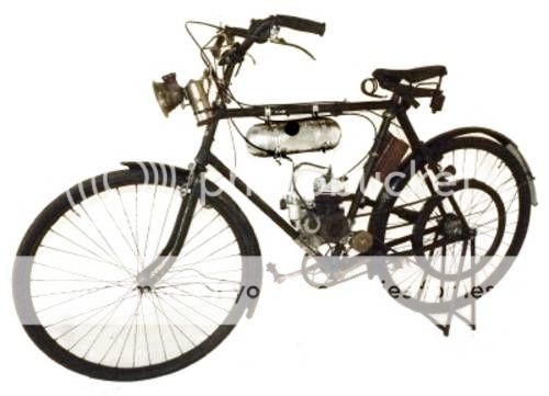

And it will be mounted in the frame in a similar way to this ........
I see you are a devotee of the Baby Champion.
I particularly like the way the engine is mounted Ludwig. All going well I hope to make a set of similar mounts to suit a Villiers engine.
Depending on how low you can mount it, you mat end up with a tank over the top tube like the Rivendell. Keep your eyes open for what may be rare in NZ, a Motobecane Model 7. It has a 3l tank which is long and flat.
