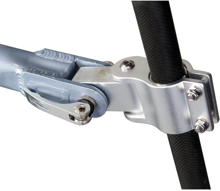

    • Trailer hitch will probable be a swivel universal joint at the seat post.
