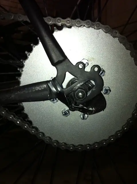

Break-in time on the Cranbrook. Installed a side pull break on the rear. I've barely been using the coaster. Very light pressure. Most of the heavy duty work has been done by the hand brake. I just installed my Dax RT carb and finished dinner (5 hr smoked baby back ribs); decided to take the Scuffed Huffy for a small spin around the 'hood. Was running awesome, pulled up to my driveway, applied slight coaster and full hand brake and BAM! This happened:
Outta nowhere, the thing folded into a pretzel. Mind you, this is with the entire hub being tore down, bearings repacked and assembled with the utmost precision. I had been paying extra attention to not relying on the coaster for stopping. NO big stops or lock-ups had been made.
So now here I am. The hub is in good shape other than the arm. I figure I have a few options. Some a lot more pricey than the others.
1. New "stock" replacement arm, then bend back to working condition. -$10
2. Prebent arm from Pirates. Which are currently out of stock. -$15
3. New Shimano 110 hub/complete wheel. -$40
4. Complete new HD wheelset with coaster. (Most costly, but honestly leaning towards this)
5. Springer front end, V-brake adapters, free wheel hub/single speed on rear and front use brake set from my Giant STP2 dirt jump bike that's just sitting in the corner collecting dust. -No adapters available on danscomp anymore.
6. Springer front end, V-brake up front. Make rear wheel free wheel with side pull as is.
I honestly feel the Cranbrook frame/head set/bars are good to go. Wheelset is questionable...brake well...that didn't work out so well.
Any opinions and help would be appreciated. So bummed. The thing was running so well going into the 2nd tank!
