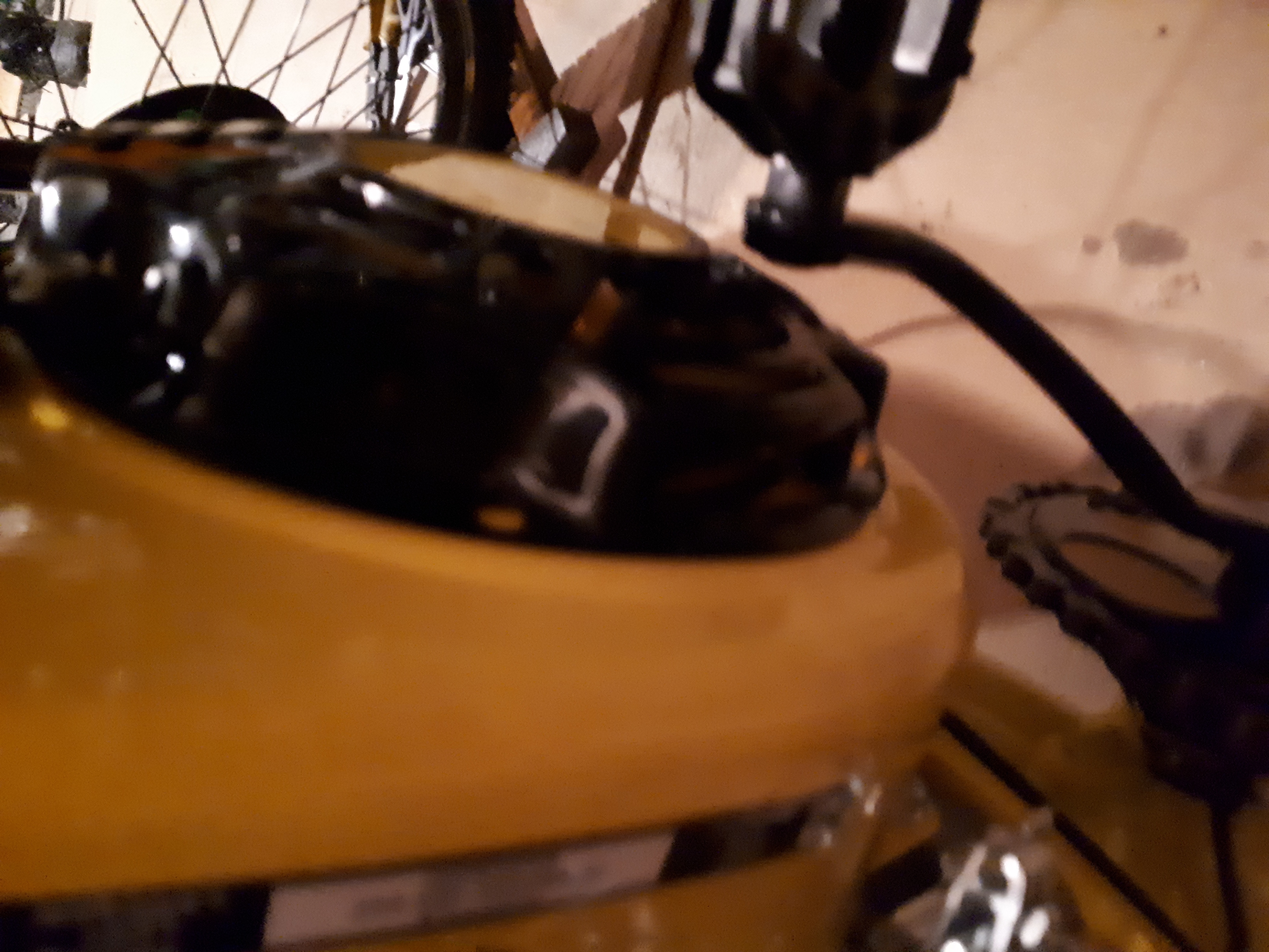

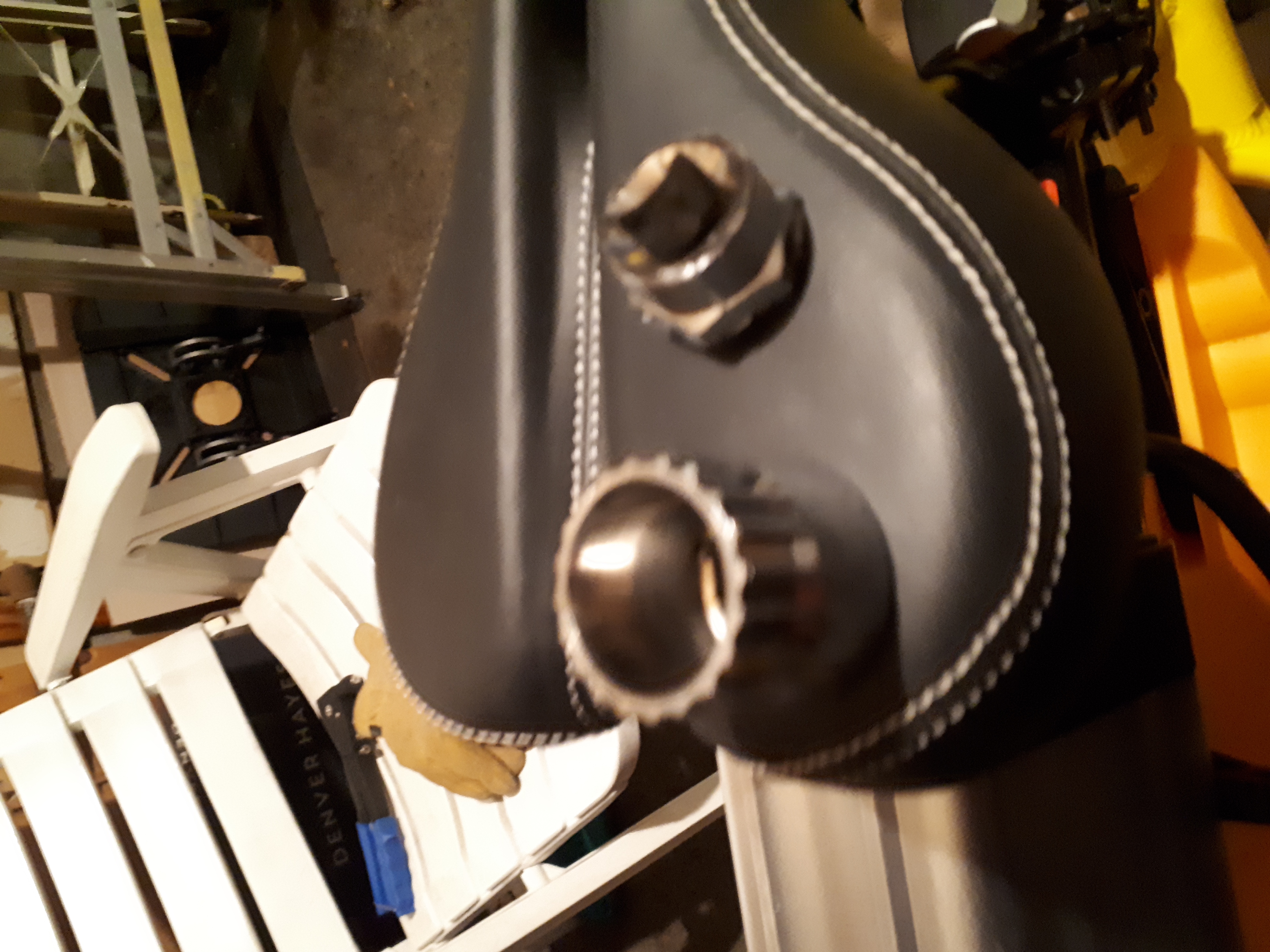

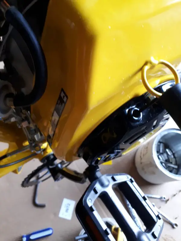

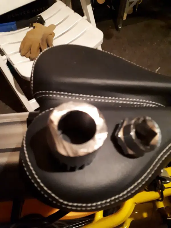

After receiving my new bike from Gasbike.net I discovered to my sorrow that the right pedal interferes with the pull starter housing by at least 1/2 inches. If anyone else is having this problem you may be interested to know that I have found the solution, at least it solved my problem. I found that during manufacturing the crank shaft was inserted backwards in the bike frame. Because of the length of the protruding shaft the standard removal tool will not reach the retainer nut so I had to grind off the wrenching end and use a large pipe wrench to remove the retainer nut on each side of the shaft. Then insert the shaft the correct way around and tighten everything down.

It’s hard to see but maybe the Bottom bracket is in backwards. Is the shaft longer on the other side ?

Thanks Moto! Sorry for the poor pictures but you are correct, it was in backward and since I inserted the shaft the correct way around , now both ends are equal and now the right pedal does not strike.

I never did find a long shaft for the the pedal asm. so I ended up using heat to rebend the pedal arms to clear my engine case and CVT. :(

Seeming to have this issue as well... interestingly enough only having this issue after crashing and having to get a new bolt for the left pedal. now the right pedal having this clearance issue. Sigh. What's the name of this tool?
After a crash, I'm guessing that the crank arm is bent... Remove the crank arm & bang it straight with a hammer. ;)
