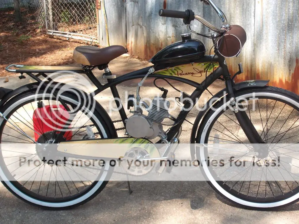

I just got the Flying horse kit and it came with everything I needed. It did not come with the extras that you mentioned such as the gaskets and bigger tank. But it did come with the extra mounts for a bigger down tube. It also came with a gear puller and a spark plug wrench, and a gas filter and came with some really cool grips(black with chrome ends) I just posted pictures of my build in this section on page 2.
Very good 2door,LOL.I know I have a little cleaning to do.And its a Dax 48cc and the coaster brake was the biggest pain so far,it has to be bent in 2 different spots to clear the sprocket bolts and lign up with the chain stay and either make or buy a large front tube adapter.Even after 14 builds,not one, was the same as another,which is good,they all have had their own challenges to overcome,keeps it interesting.
I finally got my motor shipped today. I started by putting on the sprocket. I agree, the coaster brake is a HUGE pain in my ass. I'll have to grind part of it down to get it to fit, and then bend it. Not today though, it aggravated me enough for one day.:-||
I feel your pain on that coaster brake, I finessed one with a vise and wheel grinder to a perfect fit, only to have it break on me after a month or so during some braking. rember that thing needs to be pretty strong so in making it fit try to preserve as much metal as you can - my 2c.duh.

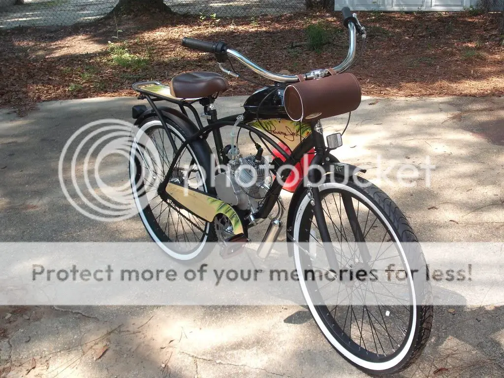

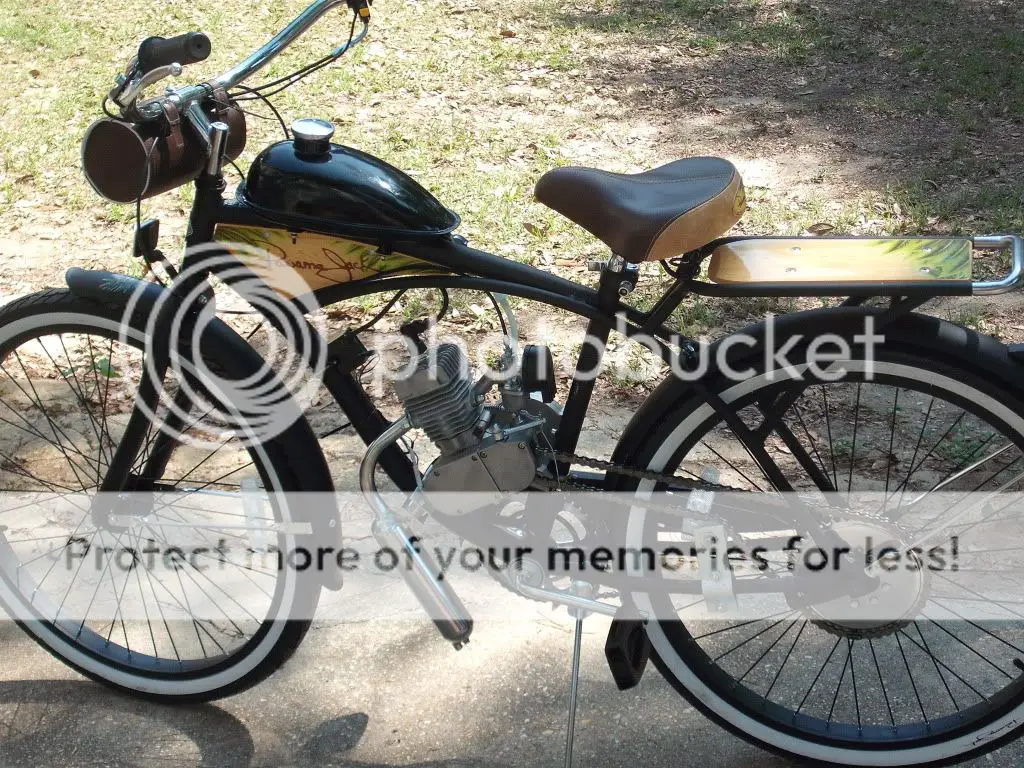

Didnt do much work to the bike today, just bolted on the exhaust. I still have yet to grind down the coaster brake, and in the meantime will do a little painting. I'll post photos when its all finished.
I just bent mine in a vise, use a hammer to pound in certain angles, mine works fine without any grinding.
i like the build a lot the wheels look pretty beefy.that used be one of the huffys week point but not anymore.
Thats one of the main reasons why I bought this bike, the rims are very wide and looks like they can accept large tires brnot
