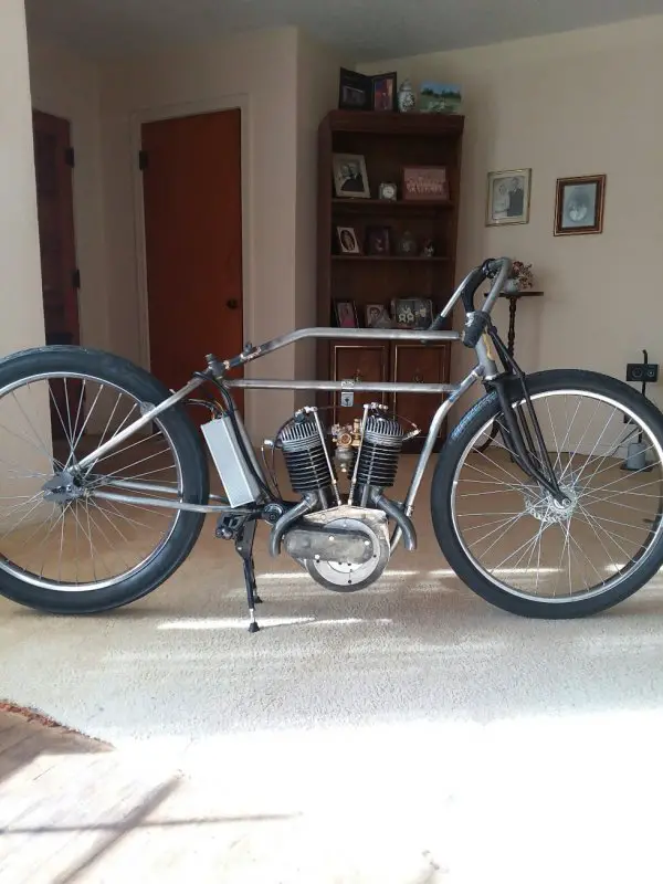

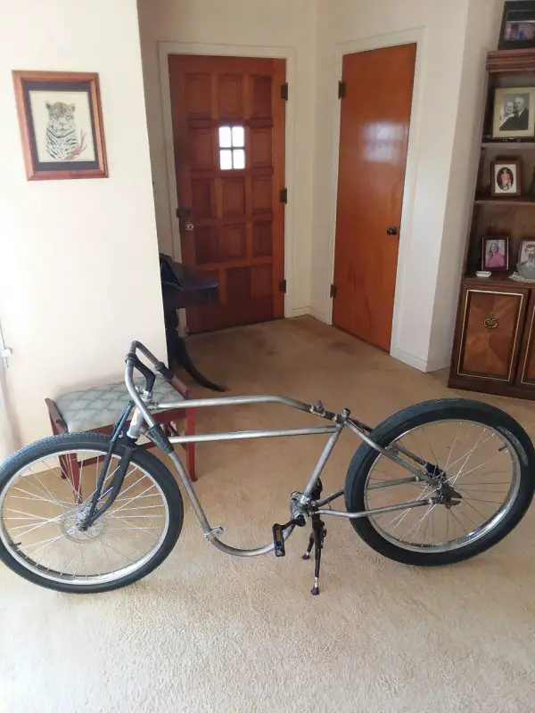

I just came in from a productive afternoon, beautiful day here in I.T. and I have a Sportsman roller to show for it. Just stuff I had, but it's what I needed to mount the motor case and I hope to have the electric V twin mounted in the frame by tomorrow and if all's good. I can go forward with the completion. Just eyeballing it and taking some coarse measurements things look pretty good for motor fit up.
Photo with the handle bars 5" to high, only stem I could find, chrome wheels, no saddle etc. won't be there when I'm done, but gives me a frame and some perspective of how it's coming along. I take the color photos and edit them to black and white so I'm not distracted by all the miss match.
The mounted tires are 2.125" x 26" front and 3" x 26" in the rear and I may stick with a 3" on the rear, not this Kenda piece of junk, and run 2.50" on the front. The diameter of the 3" is almost 29" which is pretty close to the height of the early tires.
I'd have to modify the drops in the front fork to accept much over 2.5" tire not because of width but because of height. I'll kick that can down the road.

Thanks Curt. I forgot to add that ground clearance for the frame is 4.5" but the motor clearance is only 3.5" as it sits over the frame. I'm hoping the battery pack only weighs about 17 lbs. more than a full tank of gas. The motor controller added 4 lbs. and the magneto another 3 lbs. so motor weight is now 58 lbs. batteries add another 25 lbs. (estimate) so 83 lbs. total and that's about the same as the 125cc 5speed and a tank of fuel in my Simplex or the Harley Peashooter. They both handle well with the low center of gravity.. The Peashooter and the electric V-twin should weigh about the same while the Simplex is quite a bit heavier.

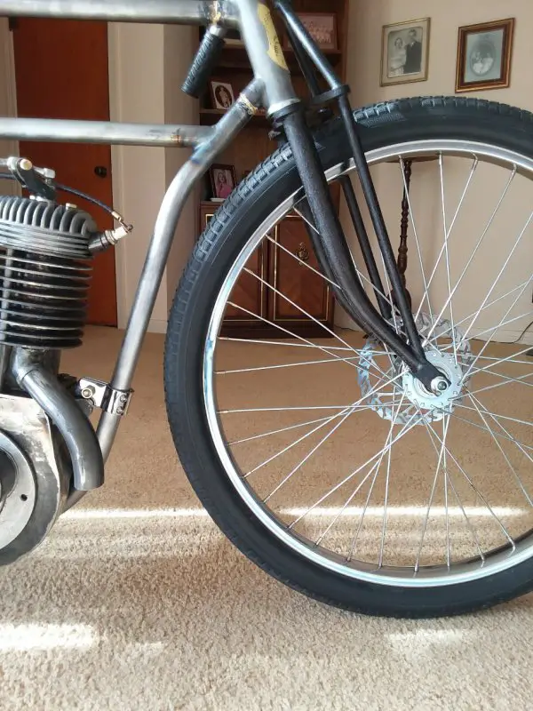

Man, that fork is short.
I see two engine mounts. Are you planning a third? Heads to center tube.

Hmmm, I'm betting maybe the fork isn't short. Possibly just the camera angle - and perspective being exacerbated by that longer temporary stem.
For me I see how close the front tire is to the down tube. Big difference from the forks I use. It will certainly make for a steeper steering angle as this lowers the front of the bike. Over time I have lengthened my forks to relax the steering geometry for more stability. This fork Rick has should still work but will have quicker steering. It will be interesting to see the bike sitting on its tires from a direct side view so I can see the angle of the top frame tube relative to the ground. I also need to keep in mind that the front part of the down tube on this frame is further forward. I lowered the loop and raised the upper bend higher just under the center tube which has also brought the down tube closer to the wheel. I have another frame just like this one with longer forks installed and can post a picture here if people want to see the difference.

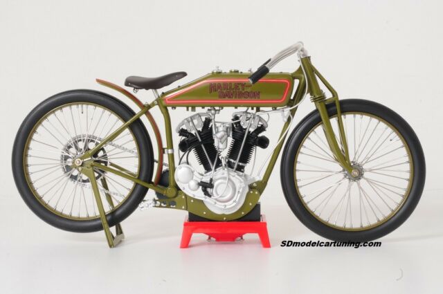

Pat, I'm a huge fan of your work and bow to your knowledge, so please don't think I'm trying to tell my Gran how to suck eggs, but isn't the front tyre snugged-up tight to the frame downtube how Harley boardies looked back in the day?
No misgivings from Rick when he posted the roller pic, so I'm thinking he aimed for the authentic look - along with the quicker steering rake/trail.

Thanks for responding. It's nice to bounce ideas around and I need to consider all angles. Your picture above shows a tire scraper, also. Tank is pretty much level to the ground. I need to remember why I do what I do. The above bike is certainly a race bike. There is simply no room for a big fender on that machine. It has nice steep steering for quick response. On my springer forks I now buy spring material in bulk and can simply cut the spring length to change ride height. A cruiser needs fender room. A land speed bike needs a shallower rake. A true boardie, which is like a flat track bike in many ways, needs a steeper rake. In my drawings I just knocked an 1" off the spring height and steepened the rake by a full degree. Lots of ways to set up the same basic frame and seeing Rick's Flyer frame set up with a very short fork, shorter than any I have ever tried, really reminds me of that.
