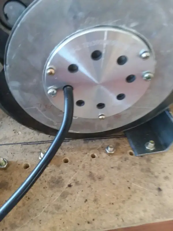

The photos show that I've left the motor case open on both ends of the case, with room around the various case covers to flow fresh air. The bottom of the case is also open for internal air flow as well. I've not drilled the direct drive motor cases for ventilation but that's an option if required. Of course the hardest thing to do is also the easiest to implement and that's just self control in refraining to max out the limits. The 4kw @72v. & 65 amp is 4.68kw which is 6.22hp and that, while not continuous is sustainable for 10 to 15 minutes, and that would drain a 20 amp hr. pack in a hurry. using 80 amp only bumps this to 7.66hp, but an extra 1.4hp required for a few moments could save ones life in traffic situations. Getting hit from behind has always been a big concern in any vehicle. A motor bike stopped and underpowered makes that my biggest concern in traffic. I'll trade speed for torque any day!

Designing & attaching covers in a manner that allows air flow to the motor while also allowing easy access and removal of internal components & holding all securely in place; was a series of problems that I've sorted.

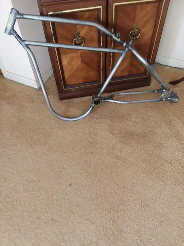

My special dimension Sportsman flyer frame is scheduled for delivery today and a big well done to Pat for interrupting his normal production routine to kick out something special for me. I'll get it up on two as a roller and see where I'm at. I know what the tape measure says but I like to verify the proportions with my eyes. Frame and fork will determine my tire sizing. My vision, at the beginning of a build, always changes when I see parts assembled. So disregard what my intentions are along the way. They are subject to change and I'm just having fun.

My special dimension Sportsman flyer frame is scheduled for delivery today.
Care to elaborate on your special dimensions Rick?
Just asking. Proprietary ? I'm good with that too.

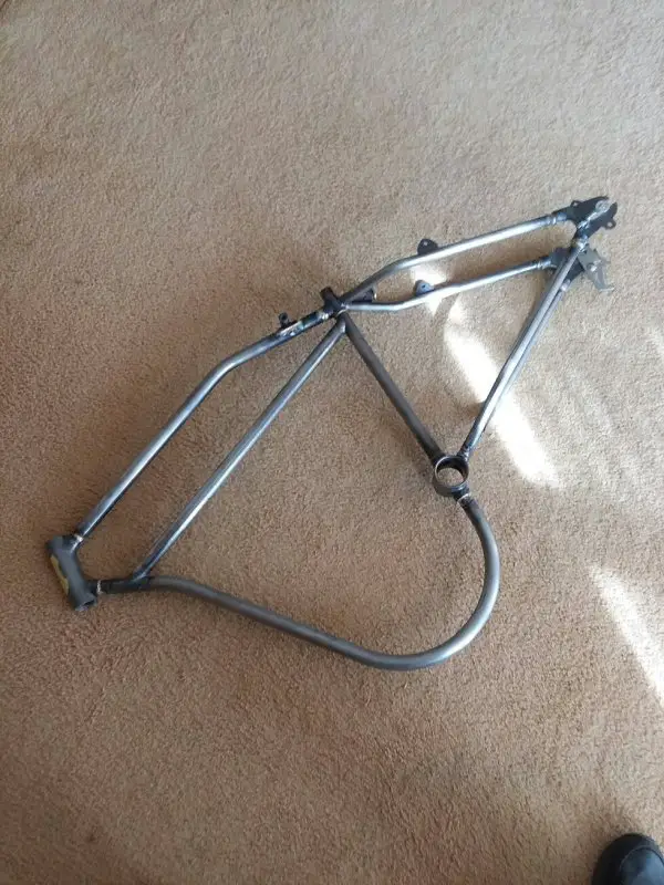

Tom this Flyer frame uses 135mm wide triangle that's on his larger frames and this allows the use of a large "oil tank" box behind the seat tube or some serious big tire on the rear. I asked for a deeper loop that would house the V-twin case and I know he dropped the loop 2". Pat also changed the geometry of the down tube to create extra horizontal length all the way up the frame for the V-twin. How much room was created? The 2" drop on the loop looks much more...so the added length appears to be even more. I just spelled out my requirements and Pat built the frame I wanted, no drama. If my build sucks it won't be because of the frame and that's for certain!
It came in late this afternoon and I got it out of the box to check for damage and there was none. I hope to get it up on some old wheels and tires this week end and check the wheelbase, but my other Sportsman frame, on my Harley "peashooter" is not as long and it's seen 80mph plus a couple of times and tracked well. I'd think this one will be fine too. I'll post some photos tomorrow.
Rick C.

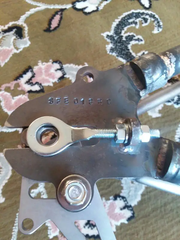

I double checked my recollections of frame dimensions with my correspondence about this frame with Pat, just to verify that the wheel base is longer & it is. How much I'm not certain, but the rear triangle is the same size as the full size "Bonneville" frame both width and length, so I'd think it's several inches longer than his 110mm width standard frame. So when I call this a special frame it denotes not only the custom dimensions of the loop and down tube but also the addition of the wide "Bonneville" stretch triangle with caliper bracket and heavy duty dropouts.
Pat also denoted the "special" nature of this frame by assigning it a new serial number series, of which this is #01 RC (my initials) and that attention to detail surprised and delighted me! Thanks Pat for taking such good care of the Old guy.
Heck of a fine frame.
Rick C.

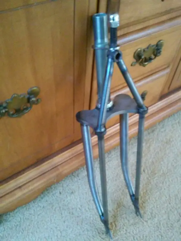

Glad your SF frame arrived safely Rick. What are your plans, fork wise, for this build's frame? 'Cause this is an out and out boardie racer tribute I'm guessing CNOL's rigid boardtrack forks?
Yes Pete shipping can be an adventure, but all was well. That's the fork, I recall you've used it, and I've had this one awhile, mounted on another bike for a long spell , but just lying about for awhile now, good thing is I know it runs true as an arrow. This is a really heavy duty girder fork that looks the part of early racer, not the pot metal version that's crimped and stamped that's been offered at times.

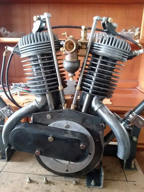

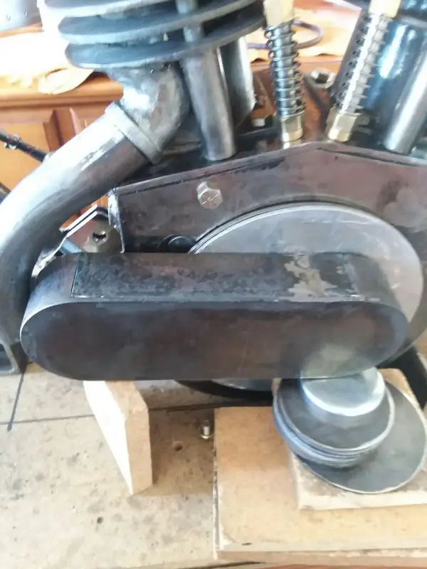

Motor cases completed and mounted both sides of the motor and she runs! No load but very satisfying to see it work in the case. The final look of the motor is a ways off, but the major components are in place.
I'm turning my attention to the frame and getting it fleshed out as a roller with parts on hand and ordering the rest if required. I should have several new bottom brackets in storage and I'll be sorting parts today. I located a base fork race yesterday so if I can spot something that small the rest should be easy. I'll use a couple of wide Worksman chrome wheels to start with till I get the roller bearing hubs laced, same type I used on the rear of my hybrid Grubee, black rims.
The way I've planned this is to easily & quickly transform this frame from convincing racer to daily rider in under an hour. Pure board track for show and disc brakes, mirror etc. for daily riding. Two sets of wheels/tires are the biggest difference, but controls, plugs and cables enter into the changeover as well. I'm not big on participating in shows, but others seem to be and I've obligated three of my bikes again this year and next.
For those who would say this isn't a very good rendition of a Harley Davidson motor I point out that during the engine test. It refused to start, wouldn't hold idle,three bolts vibrated out (check photo below) and a half cup of oil leaked from the electric twin! I rest my "case."

".. those who would say this isn't a very good rendition of a Harley Davidson motor..." just really don't know * * * * .
Even us forumites following along know your twin's true identity and we're all 100% convinced.
Now if you could just rig up a small reservoir to intermittently drip oil below the casing ...
Hi Pete, thanks for the props. Great idea that and I've a couple of simple ways to add this humorous detail. My favorite is the Vets brass or nickel over brass hypodermic syringe, that is seen on many vintage tribute bikes as a manual oil pump, for the total loss system, routed through the crank case to drip on demand. It would be a crowd pleaser for certain.
My thought on a Harley style battery tank is to have twin filler caps, originally one was used for gas the other for oil reservoirs, rather than a fake oil tank separate, one of the caps to cover the actual battery charge port the other as a cell phone charge location. High quality motorcycle bungs and O-ring screw on caps would certainly keep them dry.
Rick C. - unabashedly using others fine ideas-
