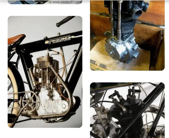

Hi, found these photos in pinterest thought I'd share them

Thanks to Lewis and Curtis for the photos and links. There is just no end to the inspiration these old bikes bring to the game. Also old threads are gold mines of how it's done and just fun to review. I'm going to dig in and read this 1910 Pierce build thread complete as I've an interest in the Pierce and the Yale bikes & motors.

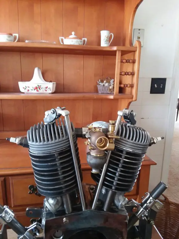

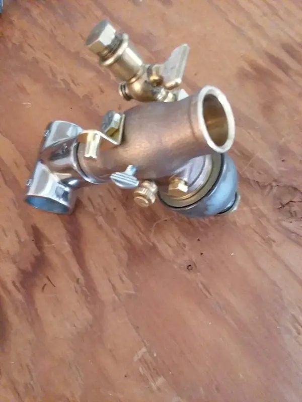

The Schleber like carb is ready for a copper gas line, glass bowl sediment filter and connection to a throttle cable. I don't think I'll attach an air cleaner, race bike and all.

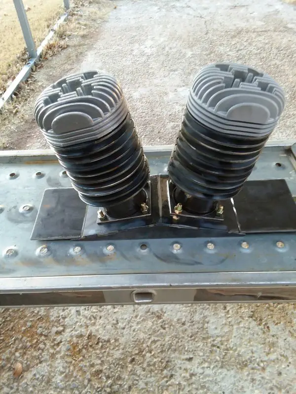

I got a lot of stuff altered to fit; when I assemble the motor case again. Spark plug cups are welded in place and intake stubs securely attached to the cylinders. I also made progress on the OHV drive train and reduction gear sprocket though I still need to extend the internal keyway 5/8" with the broach and drill/tap one key set screw.

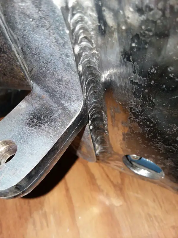

Since I've welded the two motor mounts securely to the case with the much maligned economy flux core (photo) & my miserable vision...doing it the hard way just listening to the sound of fusion cause I can't see the puddle, but I'll clean it up latter. I'm committed to Pat's frame dimensions and I'll be using the Harley tube clamps that I favor for such things. I'll wire brush the mirror finish of these as I've done with the carb manifold & that takes some of the sparkle off polished stainless.
I'll attach both the cylinder heads together with a "bridge" bracket to support the top of the motor via a single frame tube clamp mounted under the fuel (volt/amp) tank. I'm thinking this bracket can also serve as a mount for the sediment bowl.
I'm going to start mounting the case plates on the mag drive/exhaust/ pushrod side of the e-motor case along with brass oil line fitting and oil level sight glass. I've still to decide on whether the OHV pushrod springs should be concealed under the customary tube covers or run exposed springs. Details abound that were, it seems, left to the discretion of each individual HD line worker, anomaly's abound so I'll just wing it!
I'm thinking really short exhaust stubs, black rather than chrome.

I overstated Pete my eyes are open,just see little, my travel speed and standoff are adjusted by ear, direction by sight. I make a chalk line to the side which helps me look ahead to travel straight.
I prefer TIG or MIG on mix, but find many uses for flux wire and of course stick. A few tips about running flux wire that many ignore or don't know. You pull with flux wire and push travel with gas wire. Remove the gas nozzle altogether or get a small flux nozzle, helps you see the puddle. Also most home welders don't have enough wire stick out to pre-heat the wire for welding thicker material. This is especially important on low amp, inexpensive machines. Use less amps & wire stickout for thinner sheet steel. If you have a gas/flux capable MIG remember to change polarity when switching from one to the other wire process. Work clean don't weld through rust, paint or mill scale to get the best welds and a good looking weld. Cut or break the ball off the wire each time for more immediate starts to each weld. Attach your work clamp as close as possible to the area being welded.Very basic stuff...quite a bit more to it of course. Practice some.
