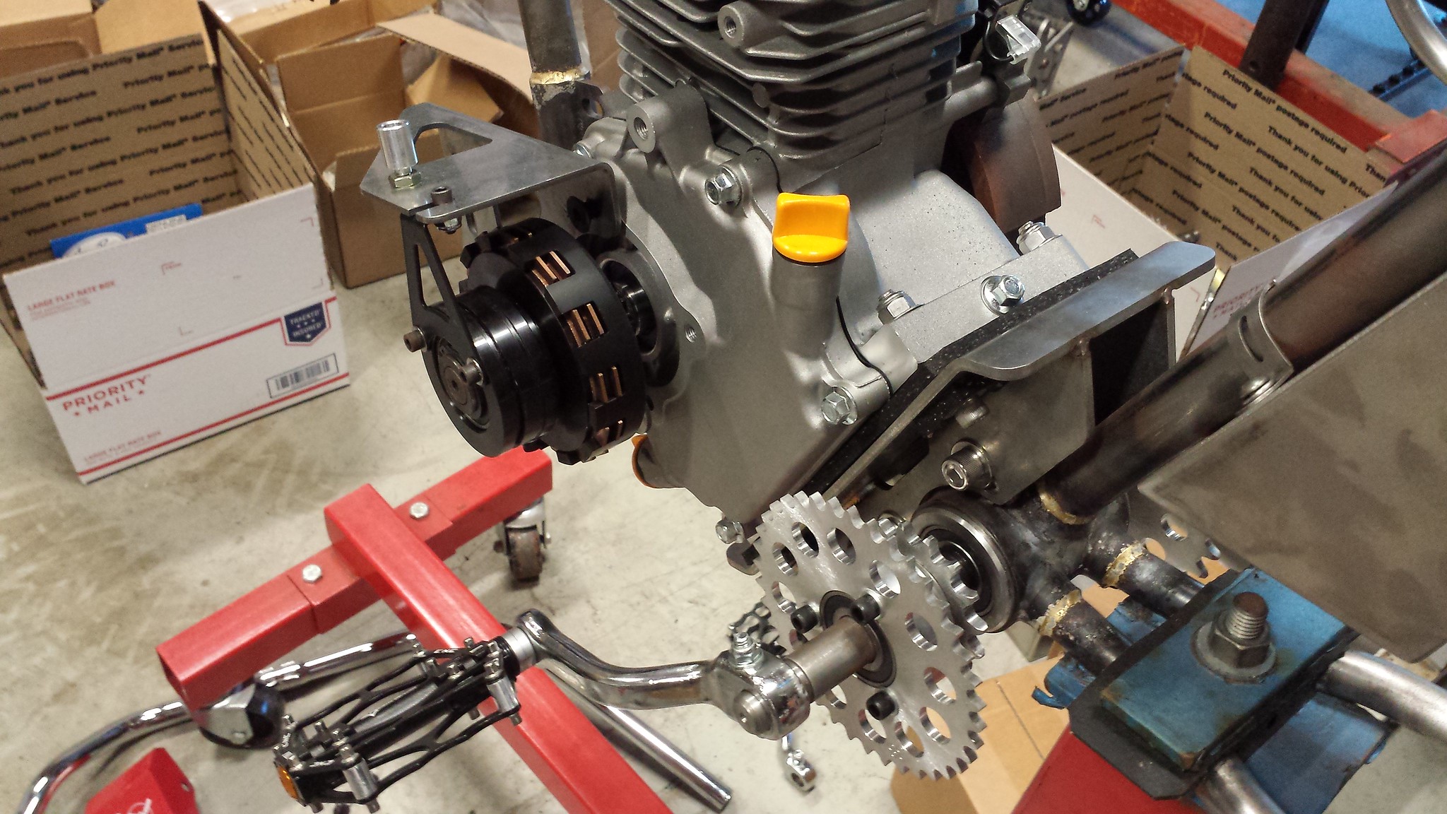

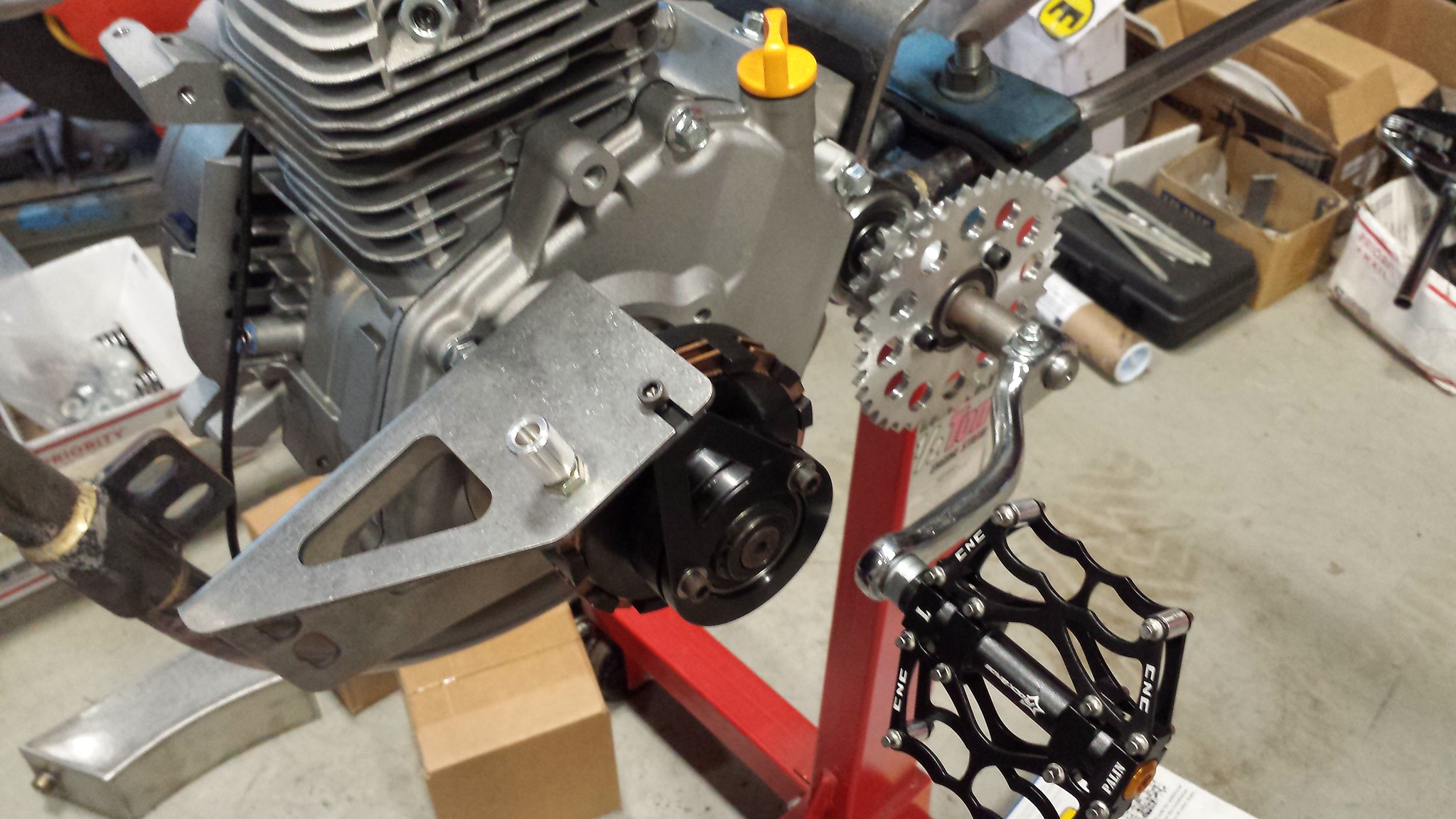

Been trying to get one of these clutches on the road. Since I run the GX200 with the cylinder vertical I had to make a custom bracket to support the cable pull system. In my application the bracket also acts as a front engine mount that ties the engine to the frame. Here is how it's looking.
Manual Clutch by Pat Dolan, on Flickr
The clutch primary sprocket will then feed back to my reduction drive system at the bottom bracket.

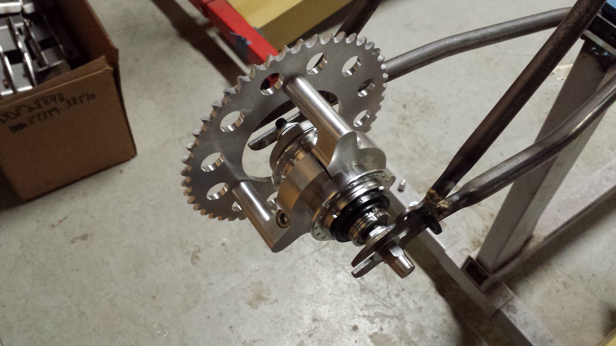

The secondary drive chain will then feed back to a Strumey Archer S1C heavy duty coaster brake hub with prototype sprocket adapter. I will now have a free left side handlebar for the clutch lever.
Prototype by Pat Dolan, on Flickr

Pat, very impressive work as always. Definitely looking forward to seeing this project completed and on the road.

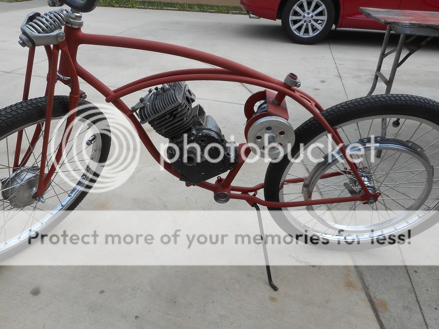

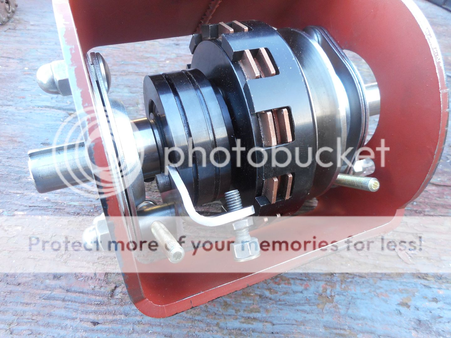

I made this clutch housing for my modified belt drive 3D clutch and I'm ready to weld it in place.
Wow! That is incredible work and some serious ingenuity. Doing a jackshaft like that will really help to keep the total width of your bike as narrow as possible. Your fab skills are excellent. Cant wait to hear how this one works out.

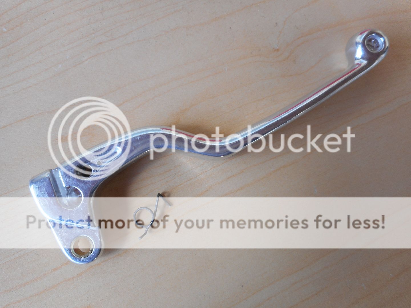

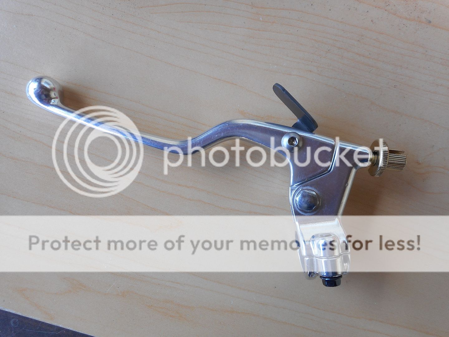

Danny and the 3D team did a great job modifying their Easy Pull clutch lever with a lockout. I thought a spring added to snap it back into place so you don't have to pull to engage and push to disengage would be a nice addition. So I made a spring from .039 music wire and installed it under their piece. I had to drill a 1/16'' hole next to the pivot bolt to accept the spring tang. Works great and while I was at it, I swapped the pivot bolt with a stainless button head and the lock nut with a locking Jam nut to slim it up a bit. With spring tension, I filed the catch a little deeper so it would stay in place better. Little details make a custom build that much better, and when their functional it's a real plus. I'll be installing it on my '54 Schwinn soon.
