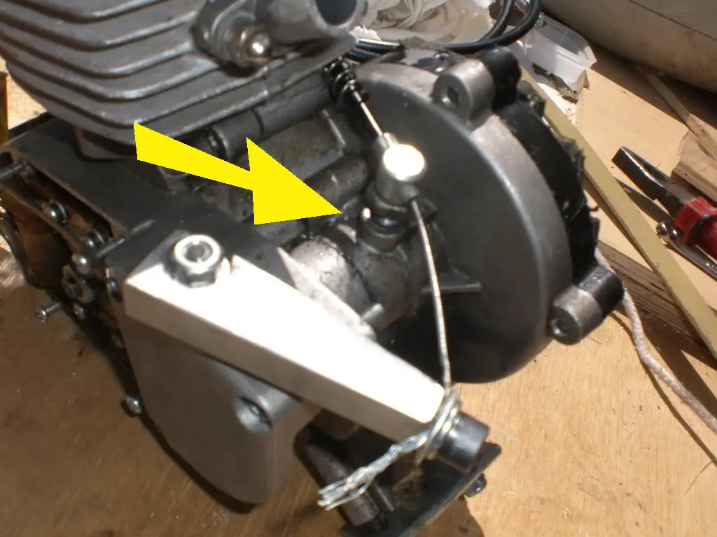

Unscrew the clutch cable stay from the engine and add some grease. Some people use a grease gun and fill it up with grease until it starts to ooze from the bearings.

Remove the cable stay... it is on top, between the sprocket on the LH side of the engine unit, and where the clutch is on the right side inside the large cover.
Remove that, and pack some grease down in there.
And if you do as some have said, pumping it in 'til it oozes out by the sprocket, there will shortly be grease all over everything, and the clutch may stop functioning. My guess.
I'm thinking about a teaspoon should resolve your problem if it is getting noisy.
Try that amount before deciding to put in more.
