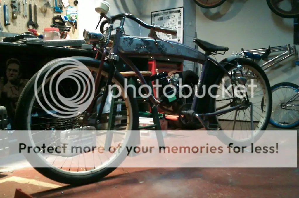

Hey guys, I'm about 3/4 of the way through my build based on a 1948 Schwinn DX with a 4" stretch and a grubee skyhawk motor and I cant seem to figure out the best rear hub set up to use. Currently the bike is sitting on a pair of Schwinn S2s with the original New Departure rear hub... brakes are also becoming a concern so I was looking into a rear drum brake able to accept both left and right side sprockets.... or any good ideas you guys have already come up with. Any help would be appreciated. This is my first motorbike build.

^^^^ What Harry says ^^^ I have a 110 coadter on the back and the Worksman drum up front. Its "OK" I'd try the SA with dynamo. Bound to work better and you'd have the added bennefit of loosing the strap on generator on the back wheel. OH! And we need more pictures..... Thats one cool looking build :)
