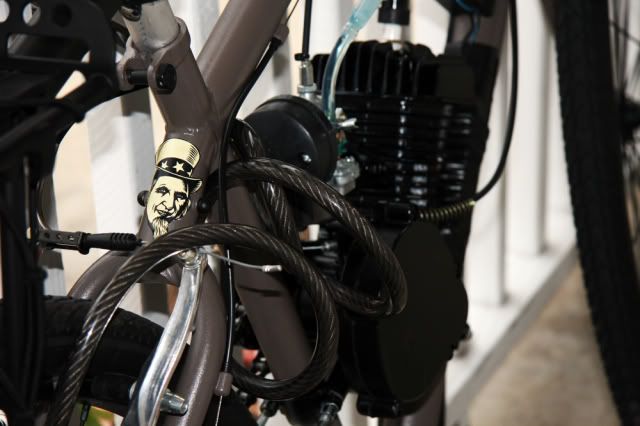

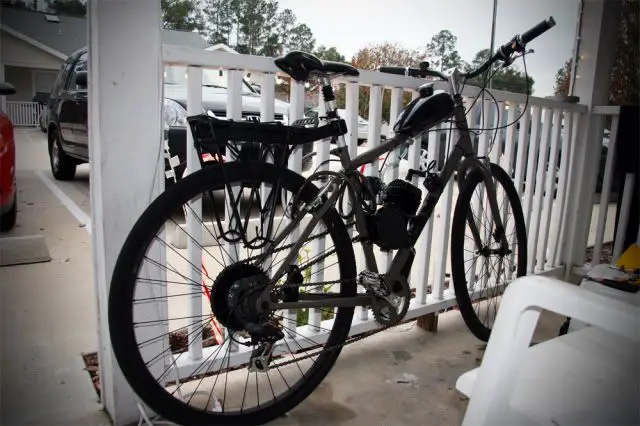

ITS ALIVE!
This was a very frustrating build, however, once it started up it all became worth it. Taking it easy for now, but it feels quite powerful. Need to tighten my brakes up for sure. Thanks for the help and encouraging comments. I'm sure I'll be frequenting these forums often now.
Here she is
