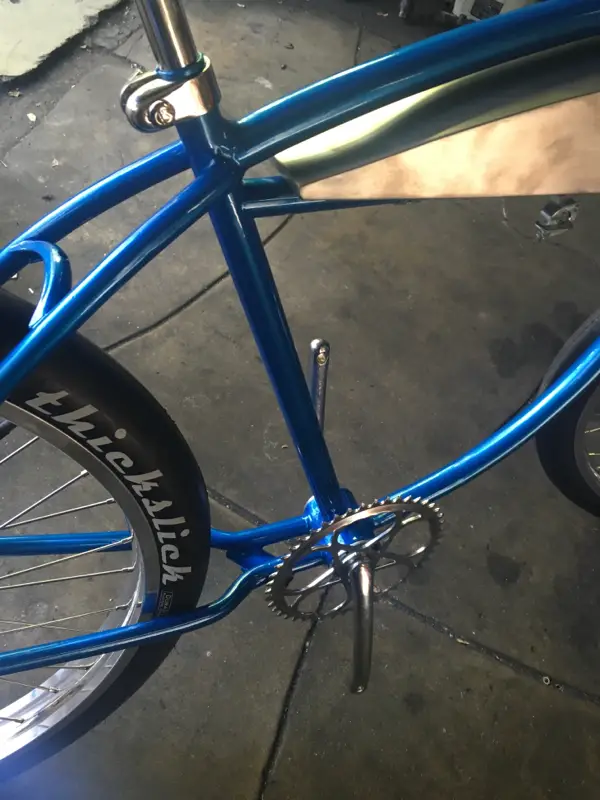

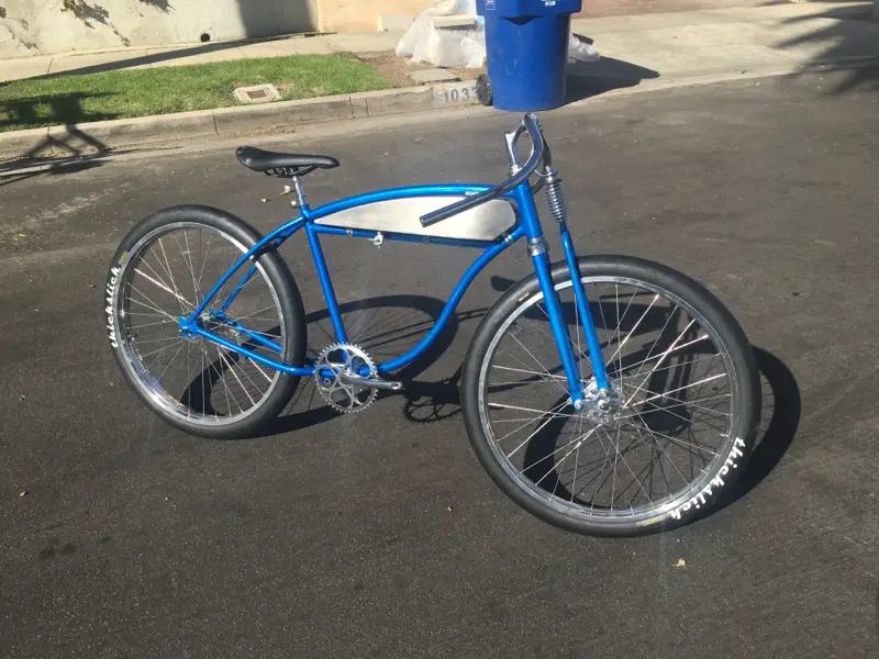

Here's one I just got the parts back from chrome & powder coating & started a test build.
It's another restored 1950s Schwinn straight bar with a Sportsman Flyer tank, VMB Monark-2 fork, Felt wheels & slicks.
First I'll get everything test fitted & then break it down & rebuild it with grease & loctite everywhere.

Here's a couple of setups that I had powdered while I did this....
One's a 1950s Monark frame & fork & the other's a custom stretch Schwinn & vintage springer fork.

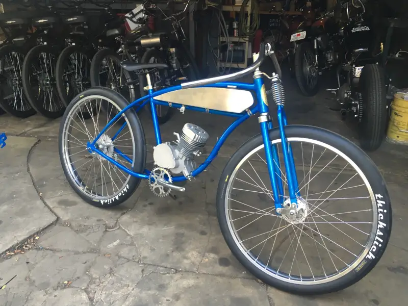

I installed a new engine & took it for its first test ride today... It runs really well but I prefer my bikes to have a lot of extra power.
The next thing to do is to install a good front disc brake & some vintage style pedals.
When I get more time in a few weeks, I'll concentrate on hot rodding the engine with a reed, big carb & a pipe.
I also checked the serial numbers... it's a 1953 Schwinn

Knowing me, you should know that I can't leave anything 'stock'...
I'm completely porting & rebuilding the entire engine for a reed valve, 22mm carb & a CR-80 pipe
I'll post more pics of the progress as it happens...
