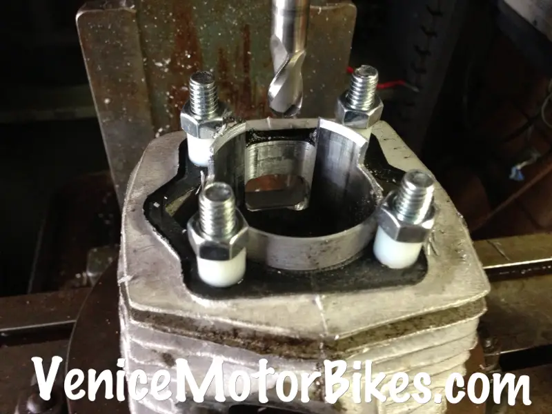

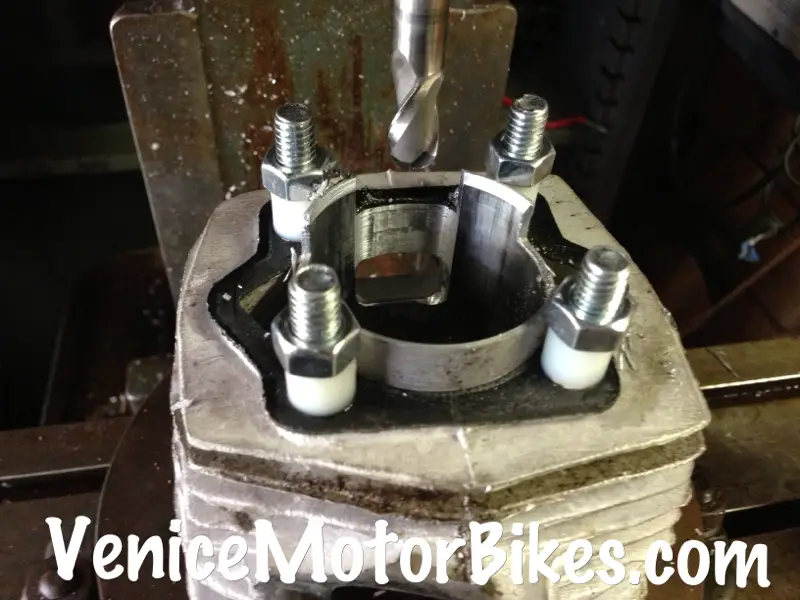

very nice looking. just makes me ask one thing is it a good idea for the port to be that wide? even though Ive built a reeded engine Im still new to them and when I think about the rings that just looks very wide but I know I can and most likely am very easly wrong. so teach me please. then after you teach me and anyone else with the same question I want a price a jug set up like that lol

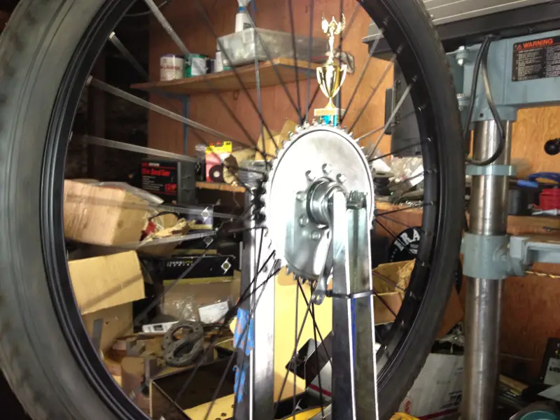

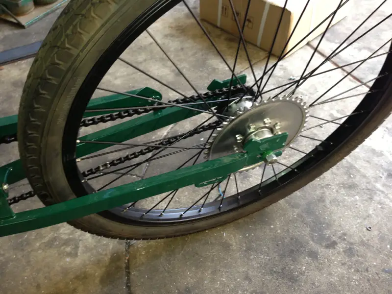

I got my first chance to use the lathe today... I used it to make the center hole of a steel sprocket larger to fit on a Nexus 3-speed hub. (^)
Sweet.
The Nexus internal 3 coaster is a popular cruiser bike hub and a stock kit sprocket that will fit them would be great.
I have a stack of sprockets, mostly 410 chain size from newer Skyhawk 2-stroke kits I jackshafted, most are true, some have slight warps which is noted on them as when you stack of sprockets even the slightest of warp doesn't need to be used, and a couple of 415 chain size sprockets as well.
If I paid to ship you a box full of sprockets you could just have to re-sale or whatever you want would you in return ship me back two 410's and a 415 with the larger hole to fit a Nexus?
I really like that back wheel on beach cruiser and being able to use it on a direct drive 2-stroke kit would be a thrill hehehe ;-}
Scott you took the words right out of my head, I don't know much about doing a reed set up on these engines either and don't know what the overall benefit is other than maybe better low end response or something, which by the way I could be wrong about......?
Reed ports are supposed to match or rise above the stock transfers by 1mm. That huge transfer port, because it doesnt rise above the piston, is perfectly fine (dont worry about rounding the edges, the rings never come into contact with the port).
The reed port is also supposed to be approximately 5mm wide and at a shallow angle aiming toward the top of the cylinder so as to not blow the side transfers straight out, but rather drag the flow up, and through the middle toward the exhaust to improve scavenging. The boost port is smaller so it has more pressure, so exhaust gases wont want to melt your reeds. A good idea is to stuff the crank case after reed porting to keep your pressures up, with the extra port, the transfer pressures drop.
However I would have opted for the piston window rather than that huge transfer, simply because of the weight reduction reducing vibrations, and allowing gas/oil to blow by and lubricate and cool your wrist bushing/bearing.
Still looks beautiful like that, I wish I had the money to do stuff like that.
