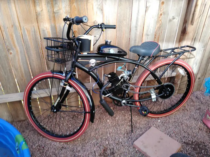

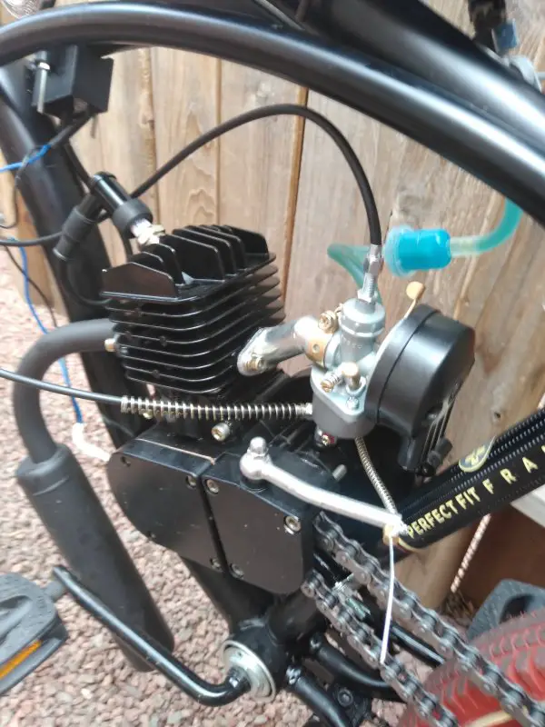

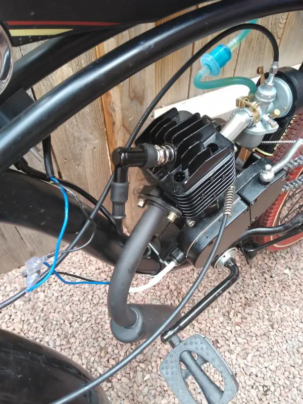

Everything is together I have compression, fuel, spark, air flow, clutch seems to be working well. I pedal and let the clutch out it gets harder to pedal it sounds like it's not trying to start. Like combustion isn't happening. my spark plug is dry but when I take my spark plug out and intake manifold off I see fuel. I'm in Colorado so I'm wondering if it's not getting enough oxygen. I've looked up a bunch of thing and tried a bunch of things. Its been together for a week and hasn't started yet.

darn nice looking bike
Thanks for the compliment on the bike!
I replaced the spark plug with an NGK B6HS and check the gap. Its right at .022. I can try making it a touch smaller. I think I'm going to leave the spark plug out overnight in case it is flooded. I had used the primer before. I checked the choke and it's working. When I pull the lever up it closes and when I push it down it wide open. l feel like my next step is to get a voltmeter and make sure the magneto is creating enough spark. Maybe some silicone for where the carb and intake manifold connect. I've snugged it up pretty good and made sure the intake manifold is as far into the carb as it can go. Maybe some starting spray?

Welcome to the forum, I’m not picking on you but the clutch will work better if you run the cable down the right side of the bike, cable tied to the frame down tube. The tight angle it’s in now will fray the cable quickly.
That's kinda why I haven't tied anything down yet. Growing pains lol. I'll take all the advice I can get and that totally makes sense, I'll switch it over today when I'm changing the fuel.

Good eye Greg. although I looked at her pics, I didn't even notice the clutch cable on the wrong side. Hang in there Sky, you have come to the answer place - so far looks like a great job!
