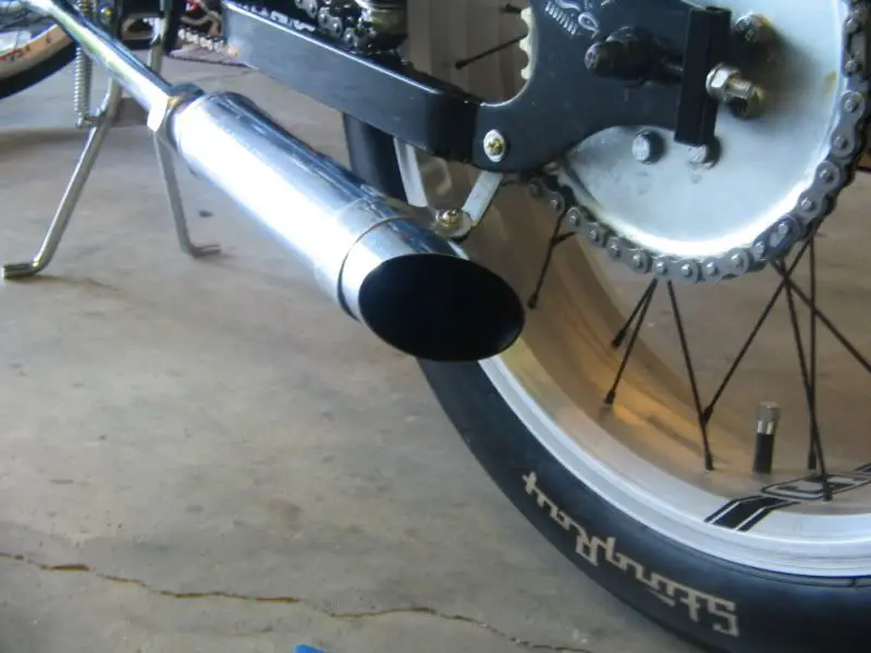

Got my chrome version in yesterday, man this thing is small. It is maybe an inch longer than the stocker and looks to roll off the same assembly line. So last night I dremeled out the flange a bit (same thing I did with my stock exhaust), and mounted it up. One day I will spring for a "real" port matched flange...
The mounting went fine, but it was a close one. There is about 1/16" between the tip of the stinger and my Crow Cycles center stand. When the stand is up when riding there is plenty of room, but on the stand in the garage, it is tiiiiight.
A couple days ago I went ahead and went to the 0.72mm jet and the stock pipe still ran ok on it. Unfortunately since my kill switch died I cannot do a real plug chop. I took a ride this morning with the new pipe and it performed almost identically to the stocker... ugh. I did not have a chance to let her get all the way warm, so maybe she will liven up more after getting to operating temp. I will pick up a new switch to wire in for a kill switch over lunch so I can do a proper plug chop to dial in the jetting. But overall, I have the sneaking suspicion that this pipe will behave just like a stock pipe, but fancy looking.

I've read a few times that you'll have to lean out your jetting with a chamber. Because you're now getting more fuel "pushed back" from the chamber pulse. You could try dropping your C-clip a notch or two before changing the jet, to see if that'll help your mid-range.
Yea that's a tight fit! You could grind an 1/8" off the tip, for "peace of mind" clearance, heh heh.

you could just cut that little nub off the end of the muffler for more clearance.

Yeah, I was thinking about grinding the tip down originally since I thought it was not going to fit at all, but when I found that I had a sliver of space, I just left it alone. If the pipe does live on my bike for a while, I will take a small amount off.
