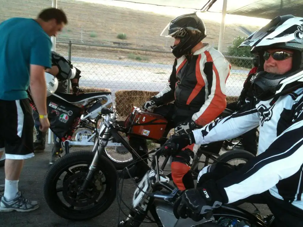

if was going to do custom work i would just get the front fork assembly off a yamaha r6 with dual disk brakes and Brembo calipers. then i would mill the center tube down to 1 1/8 inch to fit my bike. i would even keep the front rim and tire, handle bars and all levers. that would be cool.
here is a picture of a bike with front and rear suspension off a sport motorcycle.
