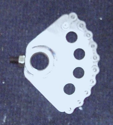

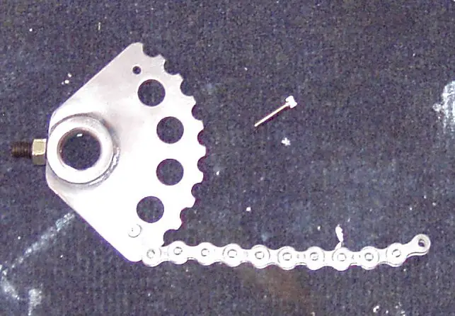

Fabricated a kick starter sprocket component. This component will secure to a pedal shaft.
We are using a piece of the roller chain that is secured to the partial sprocket.

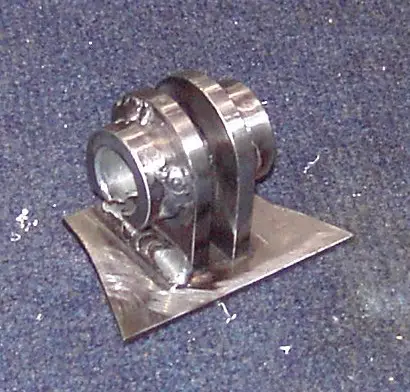

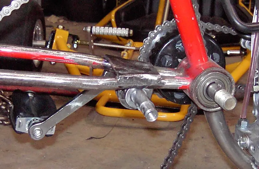

Fabricated a new pedal shaft bracket with bushings for a 3/4" shaft.
Welded the bracket in place right behind the original bottom bracket.
Added a crank arm and pedal to one end of the shaft and slipped the shaft through the bushings.

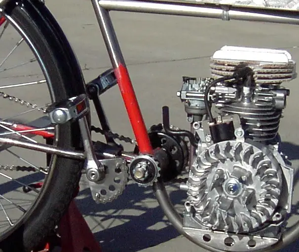

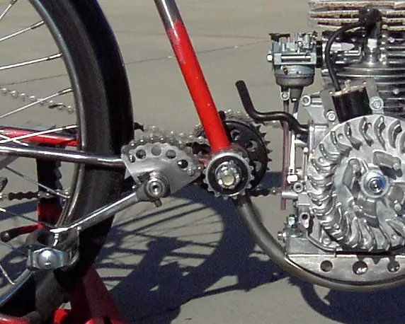

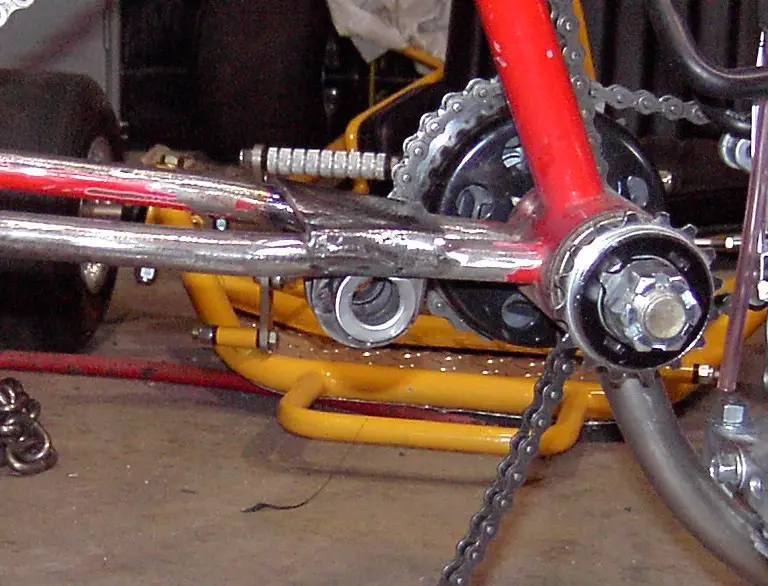

Secured the kick starter sprocket to the pedal shaft and attached the right pedal & crank arm.
The kick starter sprocket engages the freewheel so you can rotate the pedal up to make ready to turn the engine over by "kicking" down on the pedal. The kick starter sprocket will disengage with the the freewheel after "kicking" down on the pedal.
Both the left and right crank arms are secured to the pedal shaft so you could use either pedal to kick start the engine.
We found that leaving the pedals free to rotate was actually very comfortable to position your legs and feet while riding the bike. We had planned to add a feature to lock the pedals in place, we don't feel we will need this.

I am stuck here studying your kick starter.. with questions on my mind.. How did you attach freewheel onto 3/4" shaft? Or what parts did you use to make it all work?
I understand partial sprocket and other.. it just attaching that freewheel is what got me..

Found his build link for the bike. He shows how he did it and the clutch is shown so you can pause it and count the teeth. He answers questions in the comments.
Hope this helps.
Steve.
https://www.google.com/url?sa=t&rct=j&q=&esrc=s&source=web&cd=1&cad=rja&uact=8&ved=2ahUKEwjj3IHUsrPiAhWDnp4KHSJ1BVsQwqsBMAB6BAgIEAQ&url=https://www.youtube.com/watch?v=8Zk-QIZpVLI&usg=AOvVaw1KBEhQCeRRiTHaZCdPVUlE
Thank you for that info on the clutch, I found it to be10 tooth on the pic.
