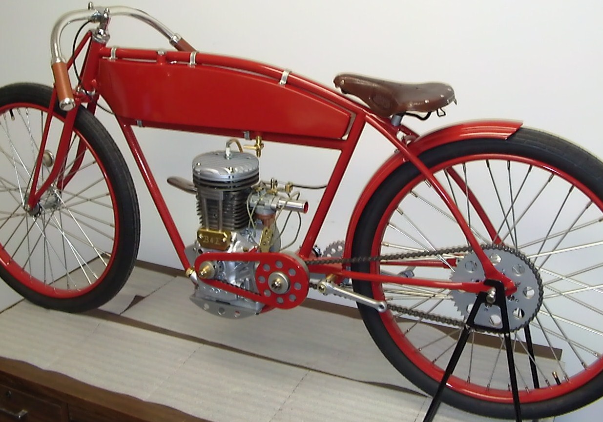

That really looks cool. I can't believe how good you made the engine look. you've got a great look and a quality engine at that. two thumbs up!!
Wayne
I've been staring at this bike for about 5 minutes now.
One suggestion, if you don't mind. That brass plate desperately needs a beautiful engraving. It should at least rise to, or cap off, the quality of your artistry. It is your signature, your approval of the final product.

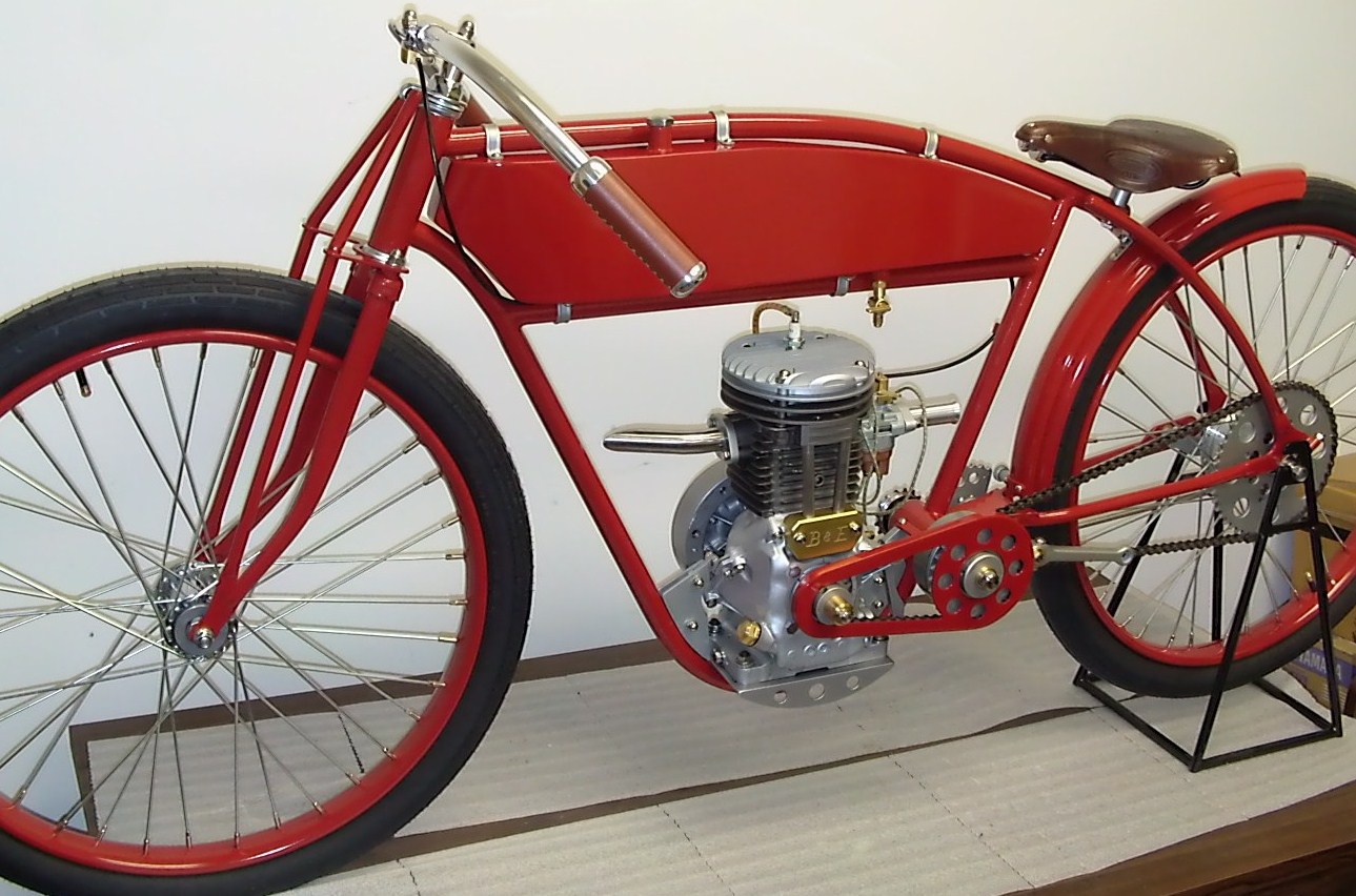

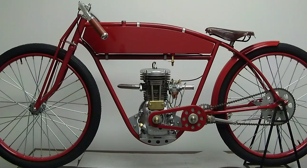

Well - I hated to crop the pictures further but here she is with the tank.
Rockhopper, which brass plate are you recommending we engrave. We did add the B&E logo to the push rod plate.
We have a kill switch coming next along with some period pedals
Mike
My gracious, this thing is absolutely hypnotizing! Very very nice machine work. I only wish I could see it in person to get a sense of proportion and scale but from the pics it looks like a solid, sturdy ride.
Anything in mind for pinstripes or logo on the tank?
Looks really nice, would like to see a photo of this with a great backdrop when you have it all done.
This picture you posted a while back really would be a nice angle. It gives the bike a nice perspective.
But that's just my opinion. Everything looks great! ........Hats off to ya!
