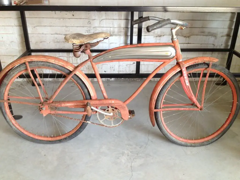

Beautiful! Ol' Bike, if you do decide to stick an engine in it may I suggest that you get either 2 stroke 60/80cc or a small 49cc 4 stroke something that will allow you to fit the engine without cutting or welding the frame, it is a Beautiful piece of history and it probably made some kid very happy when he received it many years ago.
Judging by the condition weather garaged or barned it was kept from the elimates of deteriation.
Nice Score do it justice no matter what you decide to do with it.

Due to the angle of the front down tube you don't have a lot of room for an in frame engine, but enough I think for a China girl which would look good.
As for the gas tank unless you have a friend who can do it, it would be an expensive thing to commission since it is a one off. Your best bet is to consider doing it yourself. Before you nix that idea, look into it here on the forum and ask some questions. I also know that others have considered using a fake gas tank like you have and making it functional. I don't know if anyone has done it or not, but since it has been considered there will be members with thoughts on the subject if you post a treead for it. Nice old Elgin. Do you know the year?

Now Pat at Sportsman flyer makes a behind the seat tank that attaches to the laid back seat post that might be something to consider.
A small 49cc 4-stroke engine would fit in that beauty, you can go to where the search categories are and look to the right and left you'll see all kinds of vendors most offering the at engine and again it all depends on what you want for a power plant

I think you have a great start right there. A nice vintage bike. You could fit a functional tank between the false tank panels. A nice small 2- 3 hp flathead Briggs would work, plus they are plentiful and parts are affordable. Msrfan has a great pamphlet about building a motorized bike with a Briggs. Check out the plans below you can get a quick idea of what you need to do. Are you planning on keeping the pedals? Can you weld?
