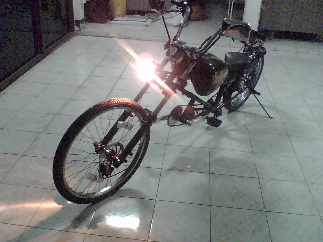

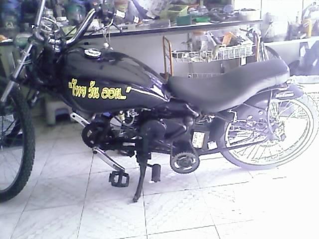

Bike has Yamaha Y80 3 speed power. using 4 free wheels, yamaha Sprockets that bolt up to the 4 hole free wheels I have complete safety..trk
Power from engine goes to left side of bike (where crank used to be) sprocket has free wheel so if engine stalls, rider can just start pedaling.
Left side of bike at opposite location is another freewheel and stacked gears. (This free wheel is not necessary just a safe option if the other fails. One of the gears has chain to rear wheel and of course there is a sprocket here to coast bike and to back-up and adjust parking location. The other center sprocket has chain fed to crank and free wheel gear up front. I am a 6" 1" guy so I need leg room. Seat is lowered 14" so I Lengthened frame 18" and with new location and bearing tube for crank I have same legroom as a 26" bicycle.rmfla
I was using bicycle disc brakes front and rear, but decided to chain the front to a motorcycle unit. Both front and rear wheels have sealed bearing and through bolt axle. (Just like motorcycle) makes dropping a wheel to fix a flat a quick easy endevor!
I chose to use a Honda Phantom Petrol tank for extra fuel and distance, I can cruise at 50 mph use 2 tanks (@ 15 liters each fillup to travel 752 Km's Bangkok to Chiang Mai) I have never been stopped because of no License. Name on Gas Tank in Thai writing says "Thai One On...!" referring to Helmet!
Big law here is for me to wear Helmet as I pay no taxes or vehicle registration fees. If they stop a Motorcyclist not wearing Helmet he gets a bill for 100 Baht (about $3.45 USD) Bill is a ticket. If I pass him not wearing Helmet I can be billed as much as 10,000 Baht (All of which Officer pockets! :) ) go figure at 29.89 baht to $1 USD...
I have 12V battery and all lighting, mirrors, horn as required by law. I also carry a letter from Office of Transportation (in Thai and English) addressing the fact that this is a legal, Motorized Bicycle, further stating that this is a project being reviewed for use to recycle older 70, 80, 90 and 100cc motorcycles for use with 3 wheeled bicycle carts, handi capped bikes, Government Bikes @ Provencial Offices and as long as I am along with any passengers wearing Helmets. I have fullfilled the requirements as requested in Thai Law.
Oh almost forgot this engine is a semi automatic transmission so there is no need for a clutch. I do have had brakes front and rear wheels. All bearing on any of the power sourced axles are sealed motorcycle style. Head tube is still using ballbearing as most motorcycle do also. (front fork is a full suspension Honda triple tree bolted up perfectly with 6" headtube!!

Actually if you go back to my 2nd set of pictures... You will see the Yamaha Y80 Belle. It looks worse then it really was (only 36,200 Km on it). When I desided to use (Try) to motor, 1st because it was Semi Automtic. Meaning I could still use both hand brakes. 2nd because it ws cheap (I already had it! and alot of the parts I would end up using also)
The only things I did to motor to insure reliability after all this work I didn't want to end up with junk! Remember, I am in Thailand and the Baht which it the currency here has been around 31.50 - 29.87 to One USD ($1.00) yes! Blessing!!
I spent 70 Baht new Crankcase seals, 150 Baht New Cylinder, 230 Baht new piston and rings set 15 baht complete gasket set (Complete) 50 Baht Carburator rebuild/gasket kit.
Took me 4 hrs to completely overhaul Engine, including scrubbing down outside of it completely. I changed crankcase oil 650cc, bought a bottle of 2T oil (From Shell Oil!! Yes they are here also..) I cut the Headtube off the Yamaha to use for 2 reasons. First it would fit any fork I chose to use. Further in case I wa going to have issues with Ministery of Transportation it also had Matching Serial number with engine stamped on it!! Just to show in case I needed that the part were indeed from the Belle I had Title for (here they cll it a Green Book)
I also desided to replace the reeds, they were plastic (fiberglass) and bent a little from sitting. The new were stainless. The cage was Aluminum so I polished inside it and throat of crankcase to where piston was. Intake to carb and throat of Carb this took me two days. I also did Exhaust Port opening it as much as I could. By this time I ws wishing it had Electric start...nope! not that lucky, wasn't even available!! I looked!! :)
I also used the body section that included the Engine mounting holes This was going to make hanging it easy, as I was the only one interested in what was happening in my Garage! haha! As long as I wasn't spending alot of money my wife was happy!! and stayed away, I knew if I asked her to help me and push the bolts through the mounts she was going to start asking questions!... haha!
I took the original Yamaha seat and removed cover and foam. Cut out 12" in length and put back together. Used a heat gun to form the shape I wanted (to look like a Sportster 2-up seat) ended a little shorter I actually took athe cut away section and cut it in 1 1/2" strips and melted it over to custom base I hd made. filling voids and thickening where it looked it need it. I added 6 bolts to base to in rear to fasten to frame and 2 in nose to fasten to metal strip that slides under rear of petrol tank. using the two seat spring from the bicycle I fastened them to the last two bolts. Then I took the foam and original cover and mess I thought (My wife thought I had made) I had to a MotorCycle/Bike shop and as I walked it he pointed around the corner and smiled. He knew what I was doing and had been at the house several times to drink a beer (Singha) and help when he could. His shop was a Harley Chopper area. He kept telling me that if it looked good... it was going to ruin his Business! then he'd say nuther beer... and smile!
To get seat finished... cost me 150 Baht! (they wanted 250 USD for the smallest Harley Sportster 2 up seat and it was used, also!) Wow!
I used two Murry Steel Ladies bikes to build my frame, or at least to get the basic look I wanted. the cross bar actually fit perfectly inside the down tube so I took one frame and cut it off at seat post and BB. turned it over and layed it down. The other frame I cut the Headtube off and top tube off at seat post also. Cut off the top fender fork and took out 14" from seat tube. This was going to be the height of frame from original BB.I hd alread found some tubing that fit inside the top tube and had cut it to the length I wanted to stretch the frame to.now laying what I had left of this frame to the right of the first one, with the sections I had cut for length I slide everything together (rubber mallot help here alot as it was also 2130 hrs :). with frames on concrete floor I ws able to keep frame aligned. I needed to bend top tube up to top of seatpost position. Using my feet to push little at a time and then stand on frame to realign it at times. I ended up heating tube at headpost to get it in a nice bend. wasn't worried about crimping headtube as I was going to use the Yamaha's. I use a front fork to position where I wanted BB for pedals and then remove from discarded section of 1st frame used about 10" of seat post attached and spot welded everything in place turning frame over a couple of times to insure straight.
So guys that how the Bike became a Chopper (The Belle had grown up!!) haha!.trk

To oil chains I have a plastic oil bottle with side cut out and a mix of grease and oil/petrol and small paint brush. with motor in neutral... pedal and tip bike so rear wheel is off ground easy to do all three chains in two minutes!
(I used all 428 M/C chains and sprockets, the 2nd set of sprockets on chainwheel/crank and center location is what gives you the ease of using pedals to overcome any weight. Weight lets bike ride smoothly even for a "Hardtail".)
