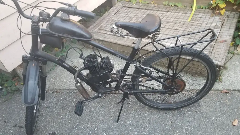

So after a motorbiking hiatus, I pulled the ol bike out of the garage and set to it. she has gained a patina of rust, I would almost say ratrodish. I think I left off when my engine from Cheese sheared a mounting stud.
So I had the engine off and the bike sitting there when a buddy needed a ride because his had been stolen. He is the guy that helped build and get it running in the first place. so he mounted my original zoom motor (pk80 i think) with my port and polish work and the modded piston and used for a few months before he parked it. The whole time he ran it, he used opti 2 at a 100:1 mix.I picked up later and parked it in my garage.

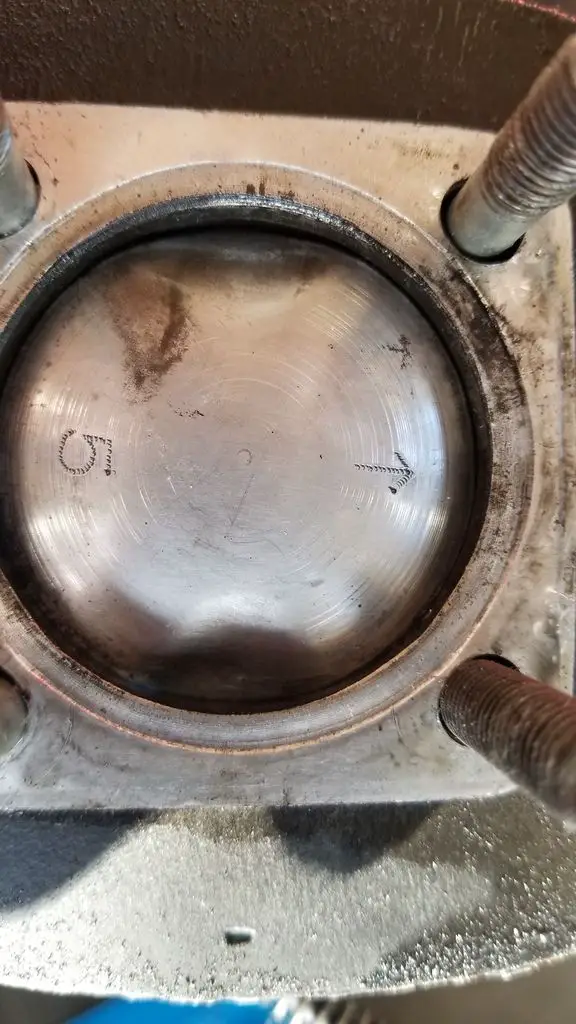

Last summer I drained the gas tank and cleaned the carb, wouldn't start. never got around to checking spark. Last week I went and sprayed her all down with a penetrant and let her sit a few days. Then I remover the head and dumper a capful of opti 2 on top of the piston, and let it sit a couple more days.
Pulled it out last night, checked the spark today. it was good. Pulled out the mag and found a trace of oil. popped out the seal and replaced it. Not starting last summer loss of compression? I dunno, it wasn't a lot of oil, but I had seals buddy gave me so I replaced it. smeared white lithium grease on anything moving, including both chains. gave the jet (66) a gas bath and used a burned clean twist tie to clear it. tightened all the bolts.
this afternoon after a few go's she fired up, it wasn't tuned. I dont have any filter or housing. just rainsock clamped over a short wide mouth v stack kinda thing and a stock muffler. so I put some pollini filter foam I had bought for my ruckus under the rainsock material and clamped it down.
she ran pretty good tonight, 54 kph (33.5 mph) topped out so far. I believe the best I ever got out of her was 60 k. I'll probably replace the chain, I have a couple in the parts pile. and investigate a noise I dont like.
