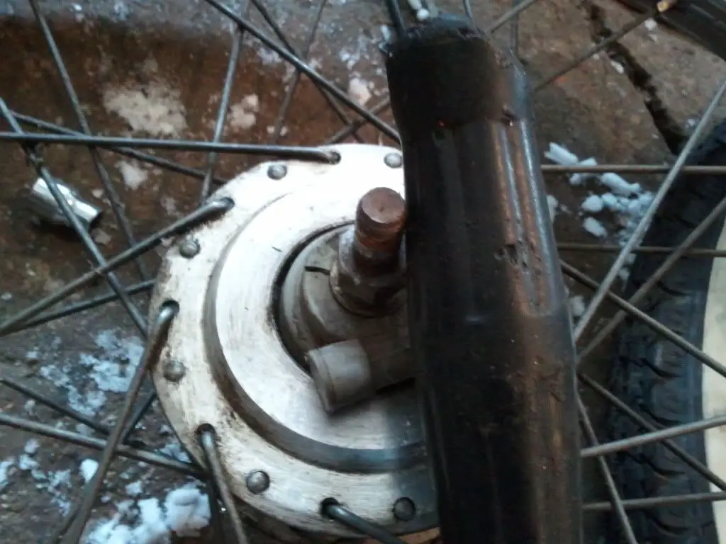

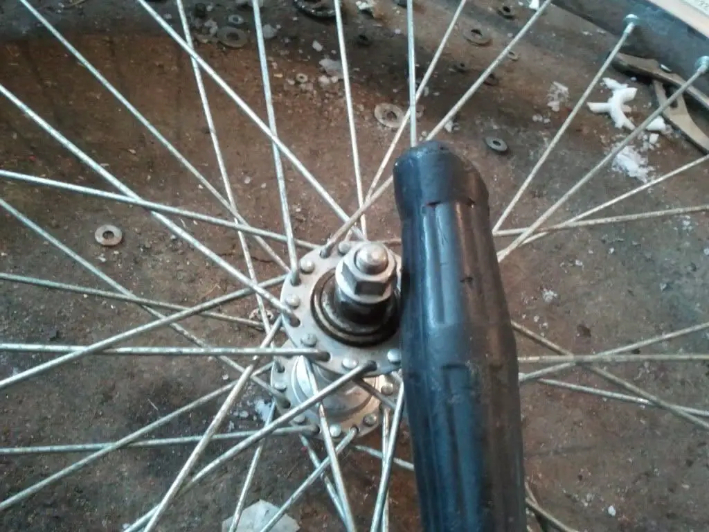

Shopdogs- I know how to build wheels, but I needed to have my spokes rerolled down from 265 mm's to 250mm's. And I don't have a die set that small. And I am not sure if Iccould even use the front drum, because the axles are significantly bigger than standard 3/8 axles. I can just ask pete at the bike shop to roll down the spoke threads for me, and I can build the wheels at home.
If I had the cash, I would invest in maybe an old worksman drum or a sturmy archer. I'll post a pic of the front drum and my front wheel in a second.

Heres a couple pics of my drum brake hub and the stock one
in the rim currently
drum brake with large axles
stock hub with normal axles
I got to looking at the sturmey front hubs, and I'm not sure if they would accept the large gauge spokes I'm using. I'll search up the worksman models now

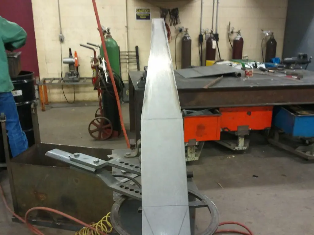

On friday I got a bit of work done on the tank, got all of the panels cut out on the plasma and sanded to shape. But for some reason all of my pictures turned out way out of focus, or had a split down the center. Here's the only pic that wasn't messed.up
I'm going to start tig-ing the thing together on monday. Hope I have enough mega-magnets to hold everything true and nice.

I have refit one strumey hub for (what i think were 12g) spokes . Nothing to fancy ,we just ran a long twist drill thru the existing spoke holes . It's only a dressing really ,just a few h thousands . I took the hub guts out and fit a quick relaese into it , that and a couple of large washers allowed the hub to cam down onto a small block. The block was held by standard drill press vise . This setup makes it easy to align and dress each hole . Hardest thing was finding the right drill? If i did it again i'd prob just use a reamer.
The strumey is very nicely machined ,there is a champher around the hole ,positioned to accept the button head of the spoke . If drilled out ,it's rather hard to redress ,but some heavy guage spokes (think wheel chair) dont have that type of head and should work?

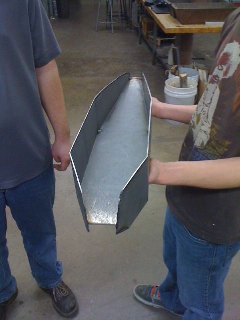

I got the side pannels of the tank cut out, bent, and tacked together. after some fine adjustments, and some tig work, I'll have a pressure testablle tank. ive still got to bring the top pannel over to the machine shop and have them bore the hole for the filler bung (which i cut out of my old china kit peanut tank) and Ill tig that in. this tank is quite heavy.
here's a length view of it, the angle of the picture is what makes the bends on the sides look off kilter.

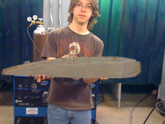

Here's a pic of me holding the tank, got my jimi hendrix shirt on.
