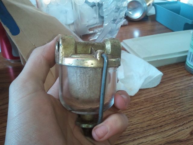

Glad it got there in one piece ! Hope she works for you . The filter is replaceable ,from fram ,i never found one . Maybe you will have better luck up there? My only concern with that filter was vibration lossening it up ,guess youll just have to check it during preflight?...

Shopdogs, my dad actually bought me the briggs and stratton filter & petcock. But, we do need a new filter identical to this one to use on our big minneapolis moline G-1000 tractor. So it'll still be helpful.

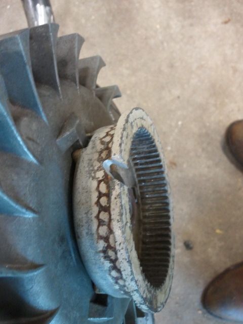

But I was able to start up my governor-less tecumseh, it looks much better without any shrouds than a briggs would. my carb needs a bit of a cleaning, as it only runs smooth on full choke. I've got some pictures this time, I'll just need to go get the img links from photobucket. I'll just edit them in in a minuet or two

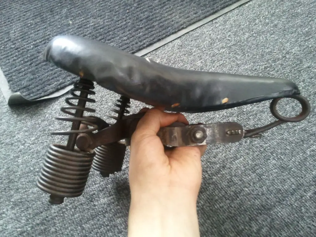

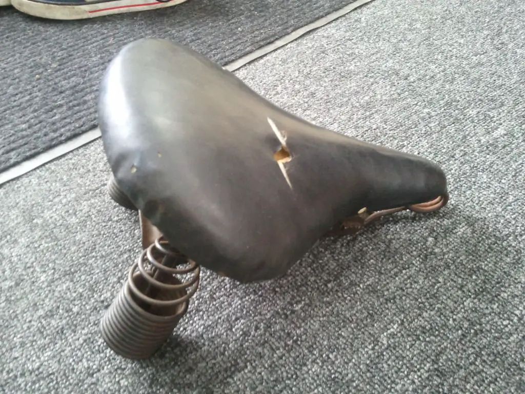

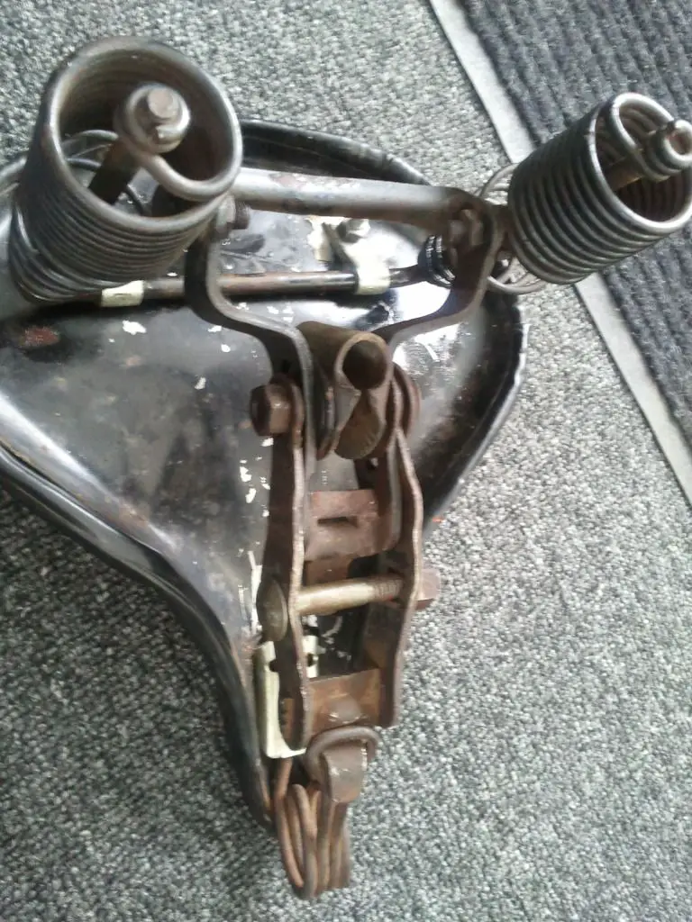

Built myself a seat today
Used a 50's mens seat pan and covering, 30's womans spring hardware, and a few other pieces
Tadaa
if it holds together, I'm thinking of asking a girl in the sewing class at school to cover it in some distressed brown leather (which might actually be horse hide from what my dad says)

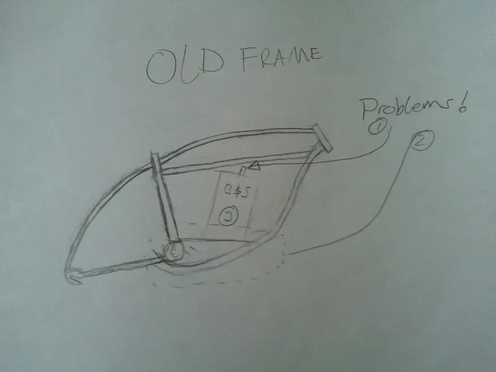

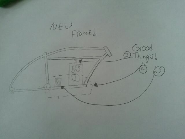

Here's my plan for the new bottom half of the frame;
Old frame
New frame!
The new bottom piece will be a "U“ shaped length of metal, with a new motor mount plate welded on top with a mount for my jackshaft bearings. I also might eliminate the american sized bottom bracket, and weld in a new bottom bracket piece that a set of bearings could press directly into to use my ultra wide crankset on here so I can still actually call this thing a motorized bicycle.
Here's a key to all the numbered lines in the drawings
1. Spark plug clearance. With the way the motor sits now, I have to use a very short plug so it does not hit the frame. I'd like to use one of my 40's era plugs
2. This... Whole general area. I don't like the way this place looks, with the upward sloping tube that was suppose to be level with the ground originally, it just needs to go
GOOD THINGS
3. Good plug clearance. Pretty self explanatory here
4. frame bottom. This will make mounting many important things, vastly simpler. From the motor mounts, to foot pegs.
5.decent jackshaft mount area!. Previously, I was going to run the jackshaft through the bottom bracket. But I could not get good drive chain alignment with that configuration. So, I'll ixnay that plan and try a bit more conventional set up, possibly I might even buy the jackshaft kit from AGK.

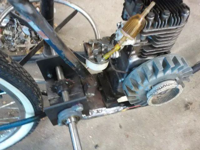

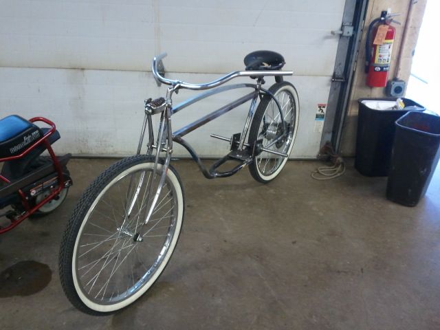

ask and ye shall receive! school has ended, and summer has begun. inbetween mowing lawns and fishing, ive mad a bit of progress, and ill let the pic's do the talking for me.
tadaaa
motor
the frame
how everything sits back here
home made rope cup
still slowly plucking away at it usflg
ccd
Ahhhh! That's better! I was starting to think this one was dead in the water, glad you're still plonking away at it. It's looking good.
