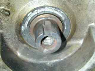

Exsample: This is what the keyway would look like on your shaft after removing the mag rotor

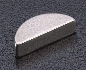

This is the woodruff key that goes in the keyway on the shaft and rotor
If the woodruff key is not holding the mag rotor in it's place, the rotor will spin on the shaft and throw your timing off.

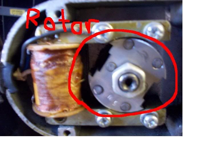

this is what i was talking about, is what your talking about behind this?
