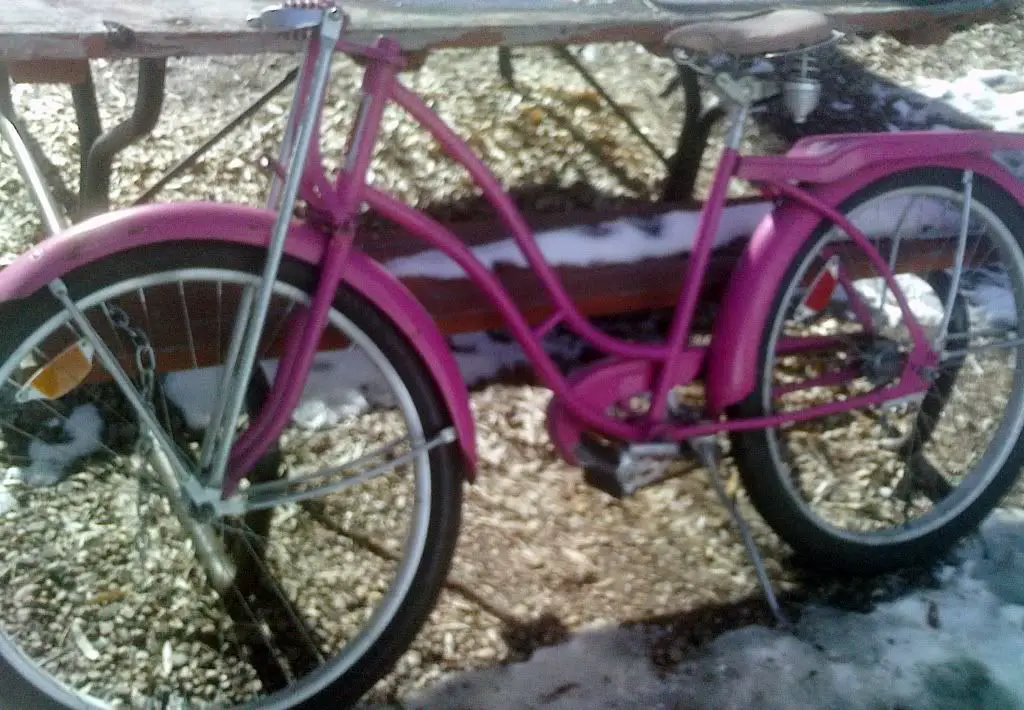

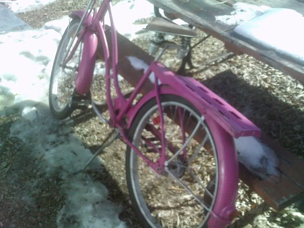

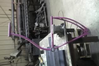

Hi,

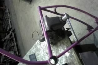

I am currently building 2 boardtrackers. One is my version, of a modernized bike, the other is going to be a more traditional vintage look. Here are pics of both. The modern one is in a second mockup stage, waiting for the engine to come. The vintage version is in the very early stages, with the frame work almost complete.( more pics of frame this evening). Yesterday, I cut, inserted, bent, massaged, and tacked, the frame, to include a bottom engine loop. I didn't weld yet, because I want to ft the engine, and make sure the frame will wrap it ,with a good looking profile.
Pic #1-Mod bike before
Pic#2- Mod Bike 2nd mockup
pic#3- vintage bike frame being worked
pic#4- 1955 Huffy before

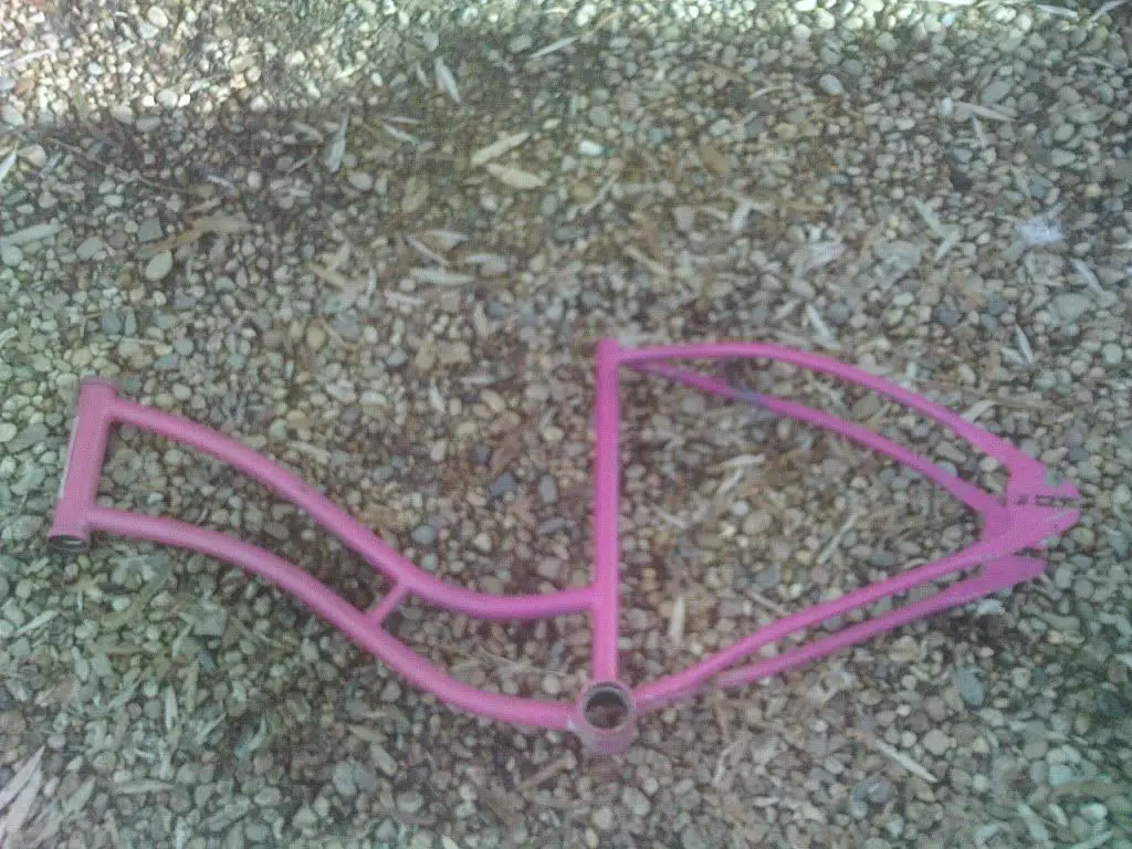

Pic#5- bare frame after tear down

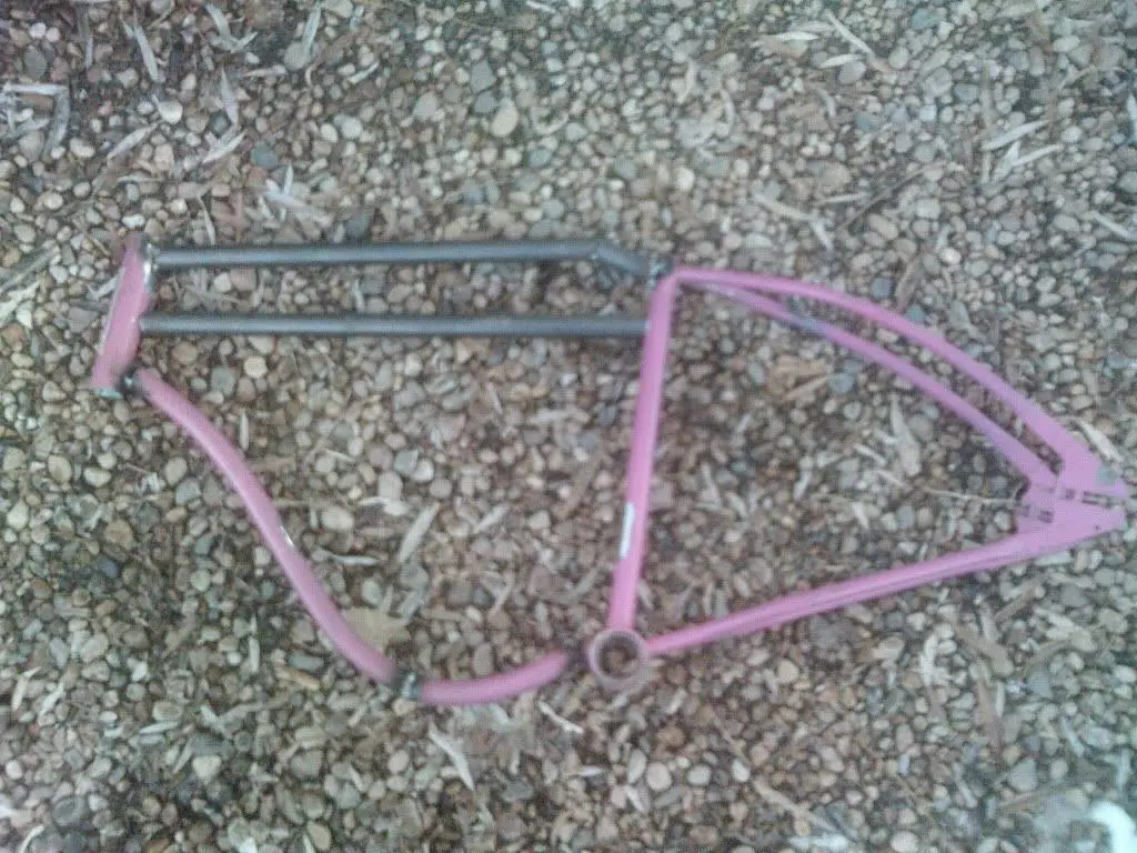

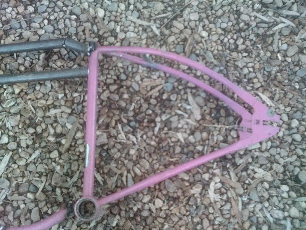

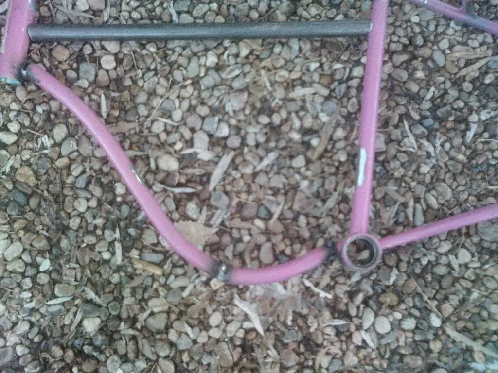

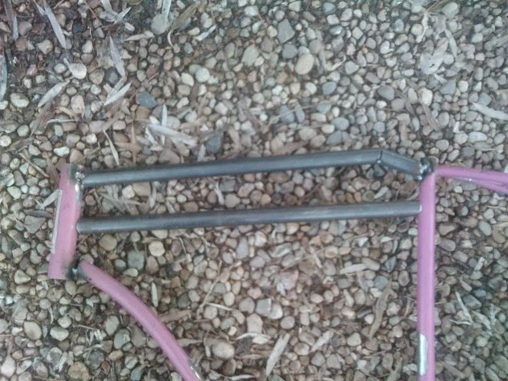

OK, I think I have this pic thing down. Lets see if this is better. These are just a preliminary fitup, to see what I come up with. When I decide the frame is ready, I am going to do my slices and connections with inserts and plug welds, to make them stronger. More pics to come.

Youre off to a nice start.......... but if you want my $0.02 i think the lower toptube would look a lot better placed a little lower, providing you have room with motor installed.
Thank you! It isn't welded in yet, lol. I just stuck it in there for the pic. I am still waiting for my engine to come in. you are right. My plans are to position it as low as possible, without interfering with the top of the engine. I am going to fab my tank once it finds it spot. I can always redesign the bottom hoop, to lower the engine a little more, if needed.

Another 2 cents. I would bend the top tube instead of cut and weld. Also the bend or weld joint should be about 6 inches foreward from where it is now. The angled end of the tube should make a strait line parallel to the 2 rear downtubes where they meet the seatpost for nice flowing lines.
The difference in angles there now sticks out like a sore thumb.
This is just an initial fitup. Everything on the frame is just there to explore different looks. The frame will more than likely, look totally different when I decide to do the final assembly and welding. You can not build a frame without the engine setting in it, to achieve the looks you are going for. I am waiting on my engine to come in, then the real looks will emerge.
My end bikes that I build are my design, and I go for looks that are not "cookie cutter".
