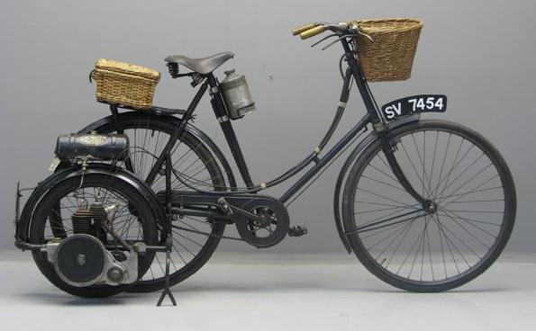

Another thought real quick-20" wheel to bring the fork tubes closer to level,then a shock in between those? Still suggest the support bars,but maybe add shocks to them too?
I don't know what I'm talking about really.
