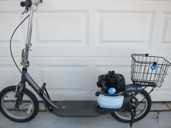

Here's mine;
It was gas to begin with, but the motor was cutting out so I put a 33cc Tanaka on it.
Works good now - :)
MikeB,
Nice scoot!
I've geared mine to max 28-29 mph...but I'm not sure how it'll handle at those speeds?
What are your impressions on the low & high speed handling of yours?
Thanks,
-Lowracer-
This is geared low, so 20 is as fast as it goes. But it pulls great.
Handling? You are joking right? These things are as squirlly as it gets - :) I got this one because of the big wheels. I rode one of those small wheel models and near fell off.

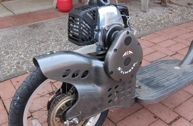

Here is a pic of it today w/chain guard detail
-Lowracer-

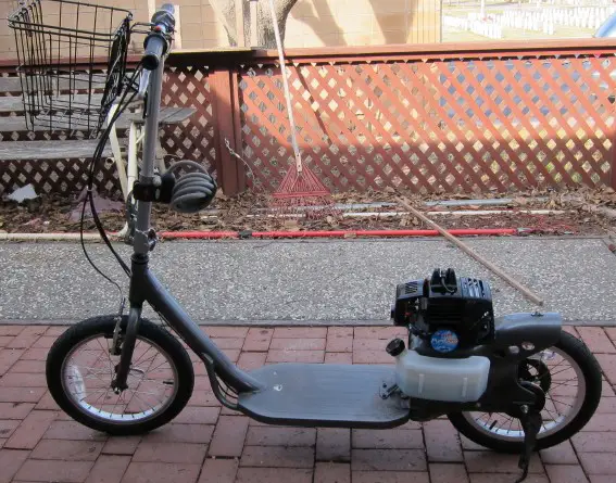

Here's a pic of the foam grips installed & the top to bottom...
-Cheers-
Lowracer
