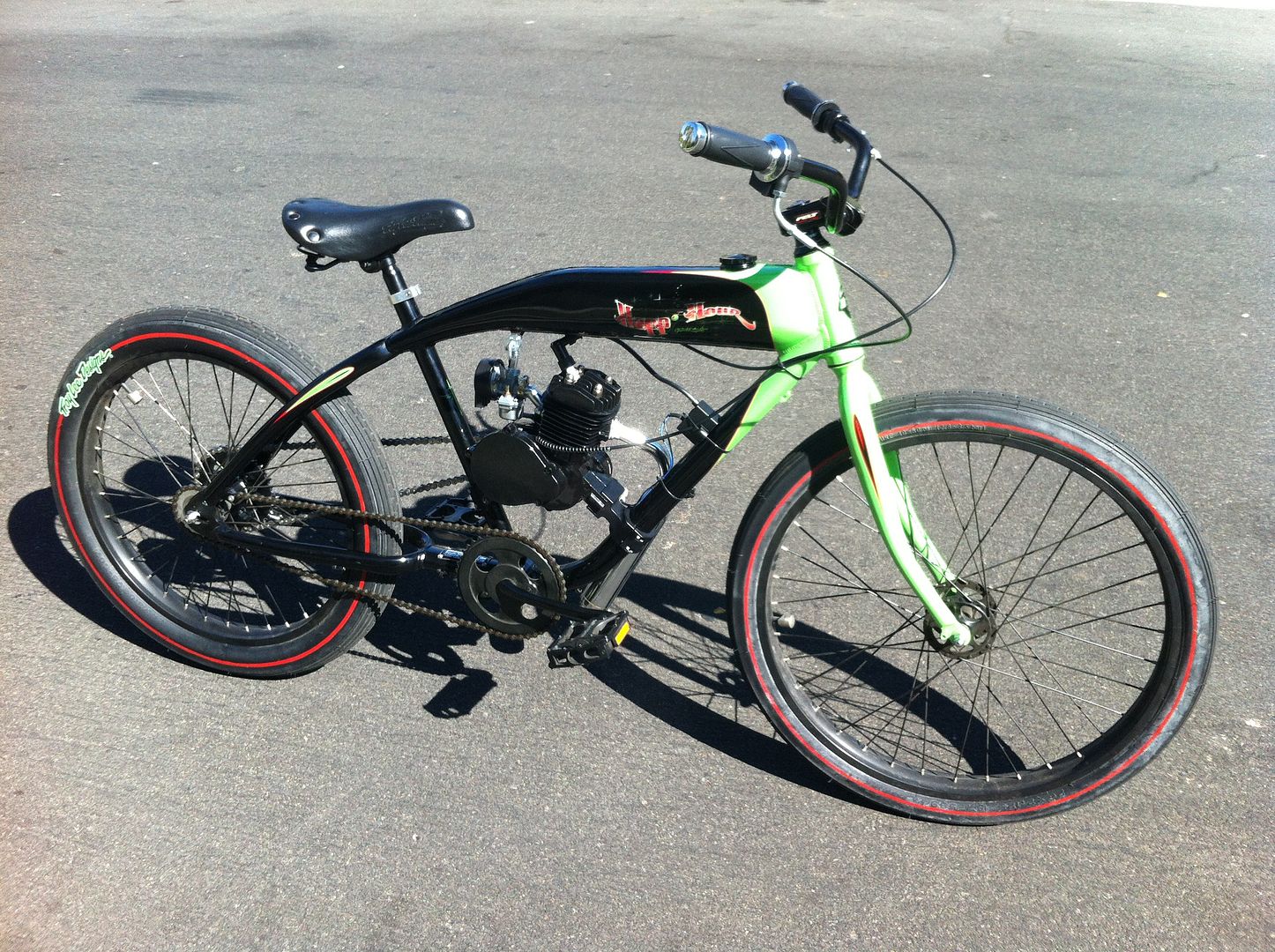

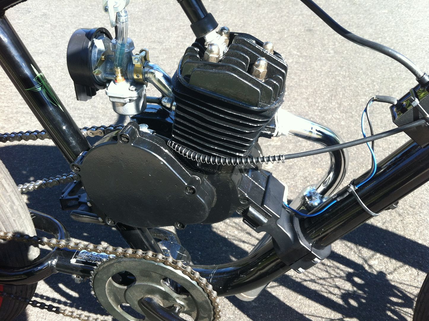

I finally got around to installing the engine on this Felt that I've slowly been building in my spare time... The bike is a 2007 Felt- Troy Lee 'Happy Hour'.

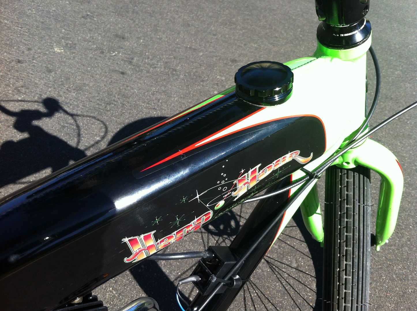

I converted the top tube into a gas tank using a black anodized KW Machine filler cap, & I also used their billet engine mounts.

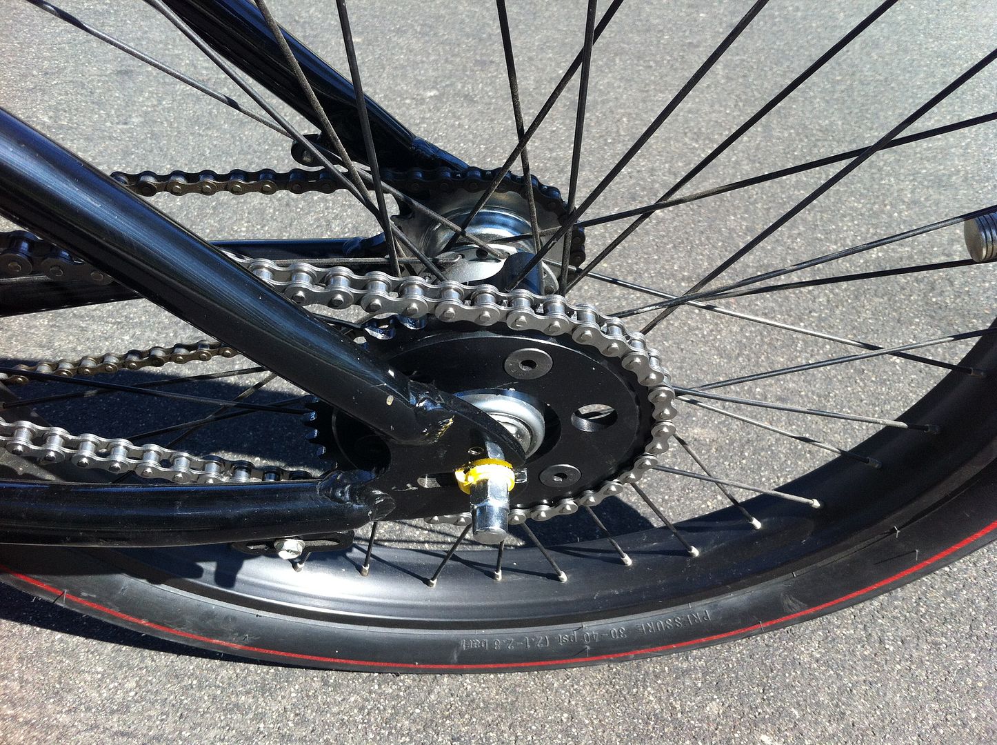

The bike also has a Sportsman hub adapter with a 36T sprocket that was custom machined for a Nexus 3-speed hub.
This is all only temporary, because I plan to install a good front brake & give the engine a full porting, reed & a custom exhaust.
