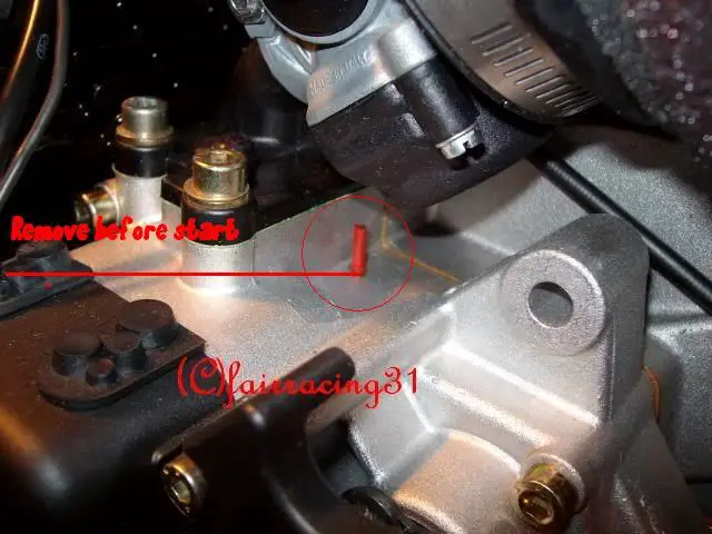

hey goat i gotta question for you. I was reading another thread and they said to take the crankcase vent out before starting. like in this pic.
welll i noticed on my engine the previous owner jb welded this hole shut. Is that how its supposed to be or could that be a huge mistake he made? Im guessing the crankcase needs to breathe.

That vent needs to be there. The wrong oil expands big time and turns to foam getting all over the bike. Oil approved for these clutches has anti foaming agents to them and don't make a mess. Somebody did not know what was going on... lol
When I pore in my Maxima MTL fluid I put the level flush to the top section of my fill plug.

f1, that vent is for the clutch area only. not the crankcase. it's just a breather to relive pressure from all the clutch and gears splashing oil around. the s-5's dont have a breather so its not that big of a deal. you might want to take the cover off and find that piece or at least change the oil. a small piece of jb might act like a piece of steel but prob. not. dennis

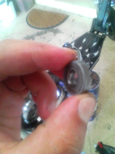

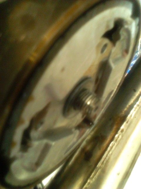

dammm so i got it running perfect!! but... i messed up i guess i didnt let the red loctite dry enough and as i was coming back to my house i heard a bad noise and stopped. I noticed it was smoking so i just walked it home. Opened the clutch cover and the freakin clutch nut came loose and stripped the crankshaft. omg am i screwed now? It wont even go on and it has like 2 or 3 threads. Im guessing i could just somehow get it on and lock it up with some jb weld but... thats pretty ghetto. Do i need to buy a new crankshaft and nut? check out the pics.

Dang sorry to hear that man.. Guess I should have said to let the lock tight set up for a few. Bottle will say something like 24 hours.. Got to get that nut pretty tight too. On my bike I was always impatient too. I will not use blue lock tight on my crank nut anymore. What happened to me once was that my nut came loose upon deceleration. It ruined my nut. I did not have a left hand die to chase the threads.
Ended up with a needle file set forever trying to dress up the crank shaft thread end.. My nut was garbage no sense of even attempting to to try to use it at all. I grabbed a new nut after cleaning things up and had to toss my flat washer to grab some more threads. The good news was that the kick start sprag still reached ok..
You can save it. Darn man and everything was going so good too.

it looks like you got some room to save it. get a new nut and a thread file and try goats solution first. if that fails call motomx.com 239-566-9666 and see if they can help you. [cranks are $200] if you cant find a LHT dye. i'd buy 2 nuts and make a dye out of one. if that doesent work chase the LHT nut on and weld [tig] the nut on and hope for the best. that happened to me too. so dont feel too bad [theirs a long line for the dunce cap so get in line behind me!] good luck dennis

Why even try to tig it yet? I think am convinced you can save it! Even if you have to shave a tiny bit off the end of the crank.. It will take patients.

well ive been trying all day to get the nut on and unfortunately i was not able to save it. The threads are pretty much DONE for. I havent tried tiging it yet as i do not have a welder. But i will be happy to pay someone to weld it on for me if itll save it... I just wanna ride. Do you guys think if i part the whole engine out i can make back some money?

goats right got the new nut's? you cant use a bent/crushed nut your wasting your time unless you ran a LHT tap through it. get a good dye grinder and grind the bent threads away and leave the good ones. as log as the threads have no bouggers missing threads are no big deal [like a keyway slot] if its too much for you find a shop. here in so cal we have a place called ''the hole shop'' they lazer cut broken studs ect. that ph # i gave you is in fl give them a call dont know what elts to say. maybe a good tig shop can stick in on for ya. and have fun till it breaks. sorry good luck dennis you tig on the inside of the nut to the crank only tig will weld hard steel to the nut
