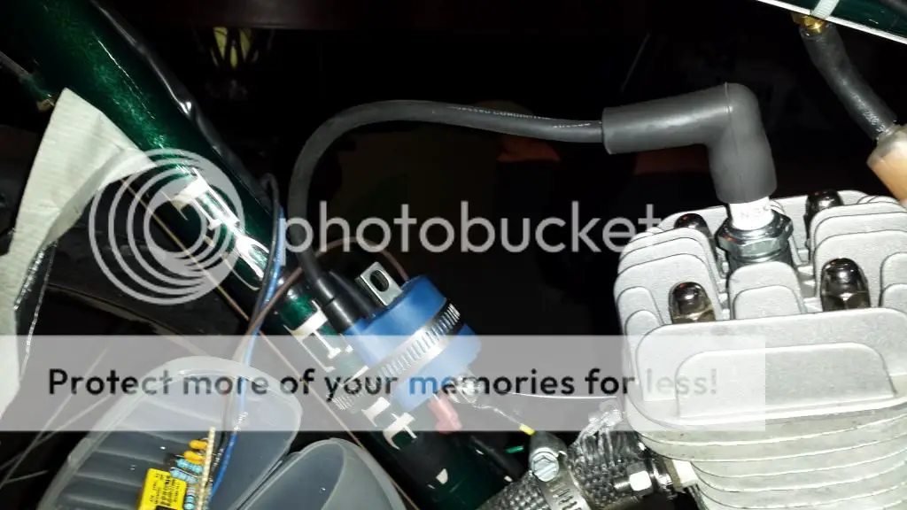

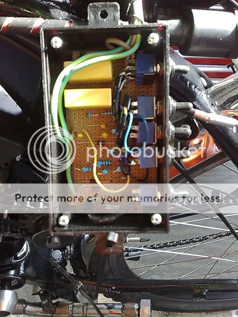

here is a pic on of the CDI I made.
fully adjustable. lots of trouble.

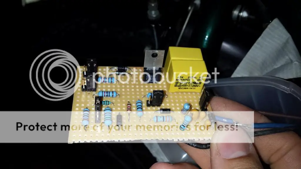

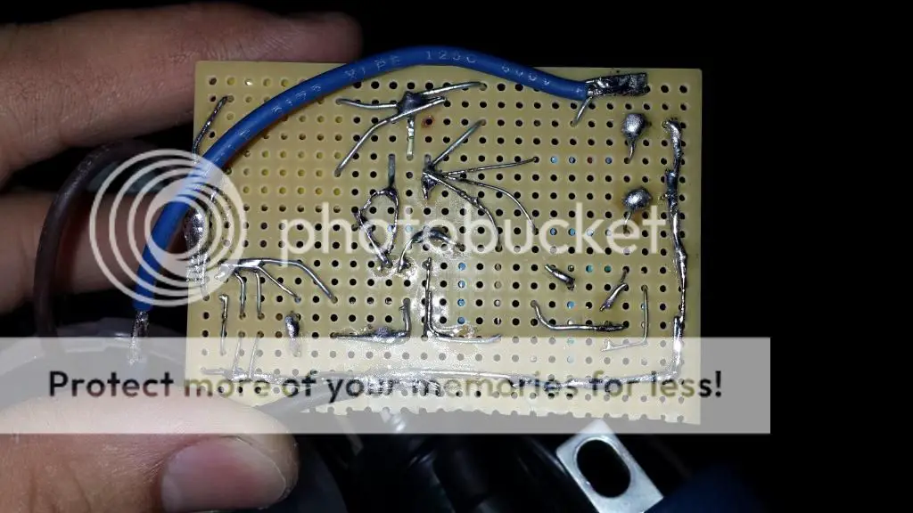

Hey, hoping somebody might still be around that could help me! I've put together a cdi pretty much exactly as Draco laid out in his post. Yet I am getting no spark. So I double checked everything and found out that one of my tantalum capacitors was backwards, but still nothing. Sooo I made a 2nd one (seemed to be better made than the first), as close to the design as I can possible make and still nada. Yet when I put my old "simple cdi" back on, sparks perfectly. Please, somebody take a look at my pics and tell me what ya think! (the brown wire in the upper left is supposed to be the red) lol.....hugely frustrated.
The rocket cdi is a very compact version of this.
At a reasonable price.
And is non encapsulated, so can be modified to suit.
Minus all of the satisfaction of learning and building one yourself (....only to have it not work....help...) Not to mention the cost savings and the added benefit of possibly being able to fix it yourself if ever need be.
And yes, I would be willing to make and sell a couple if I can just work out the kinks and get it working!
Try buying new caps.
This happened to me, no spark that is. I rebuilt the circuit and still no luck.
Replaced the caps. and spark spark spark.

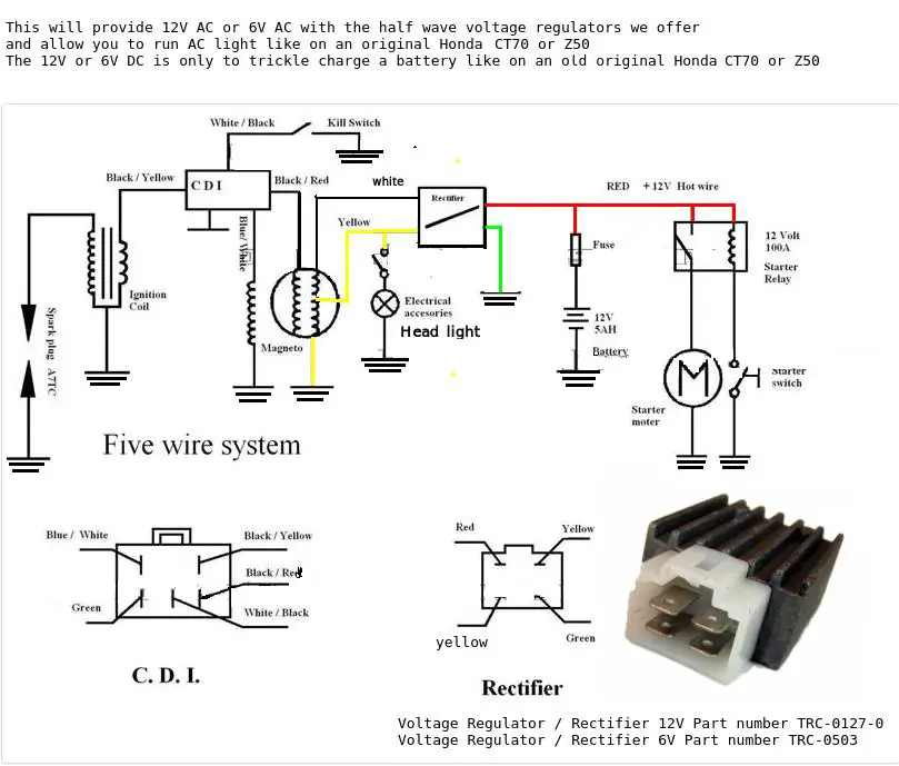

Good evening , congratulations for your article, kindly ask for your help because I would like to install the unit on a bike. In my motorbike with two stator windings, one ac generator coil and pulser coil as shown in figure(1). just connect them as figures (2)? or you tell me how to do. Many thanks .
