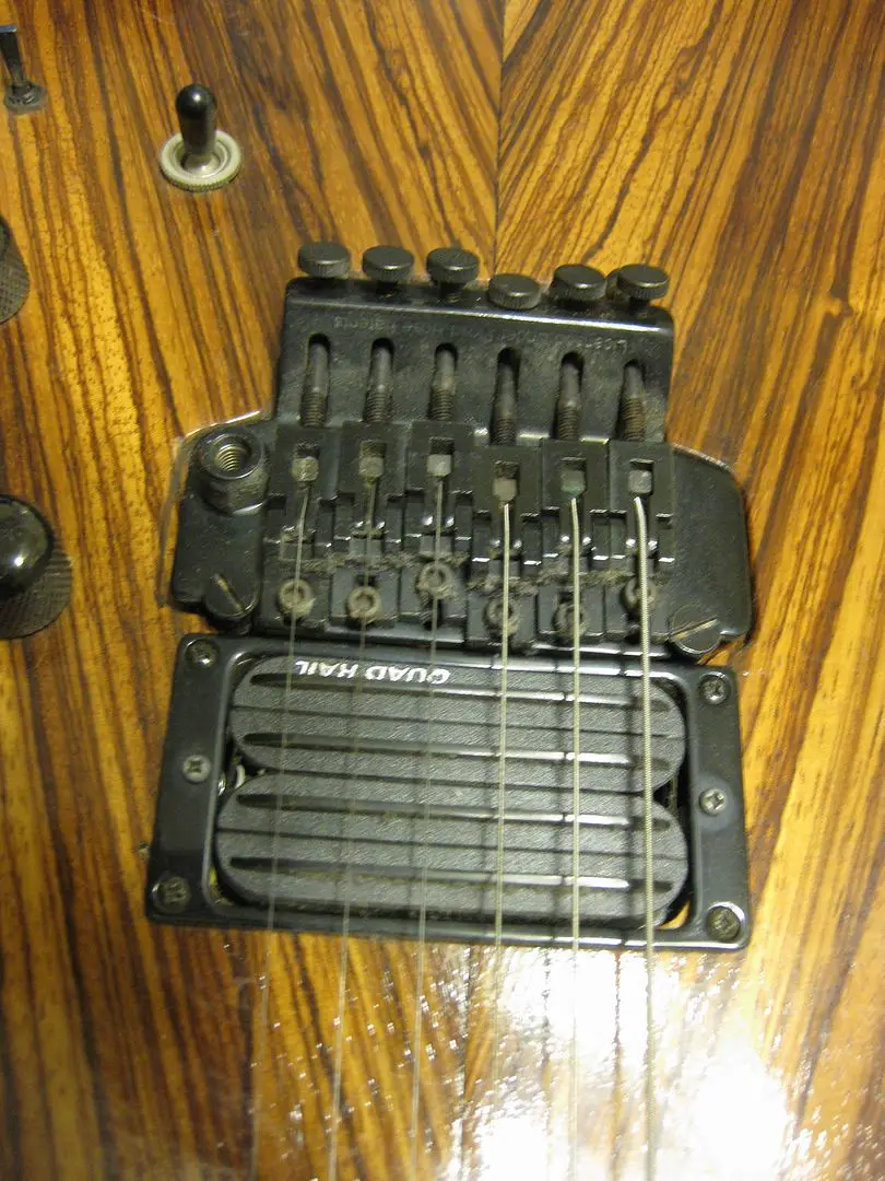

Nice ol' engine! I'm not quite sure why Mike, but that pic reminds me of a guitar I built several years ago.......?
The guitar is made of zebra wood......not sure of the wood the whizzer is resting on? Rock on Mike!

Wow where to begin? Worked all day on the Monark, pics to follow. Scotto, yeah I see why you are feeling that way, the table that matches that nice custom guitar, is Oak Veneer on a table in Wisconsin!
I actually bought an Orange and Black Squire single pickup Hardtail with neck changed to Hockey stick w/locking nut that I am gonna hot-rod, I have a p-90 dog-ear, with humbucking coil below, and phase options!
