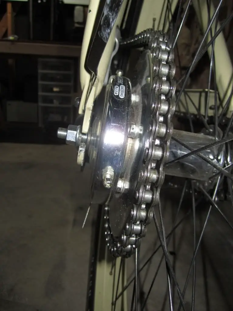

FINALLY Rear brakes =) I had this laying around forever and finally got around to installing it.

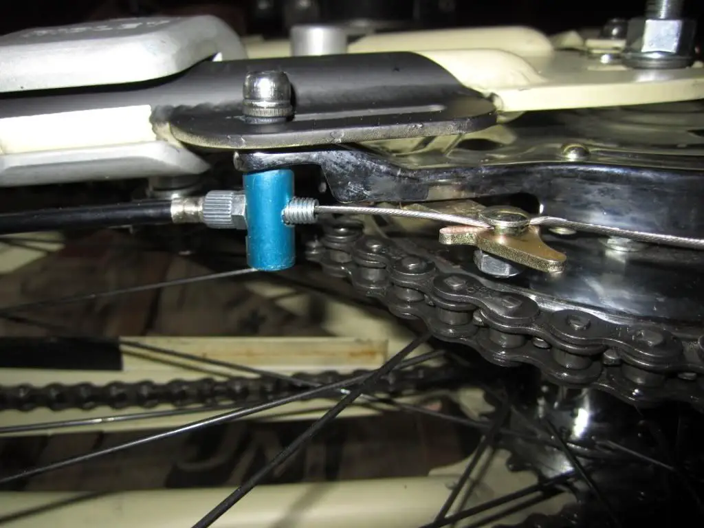

I jerry rigged the mount to use the coaster brake bracket to hold the drum brake and cable mount.

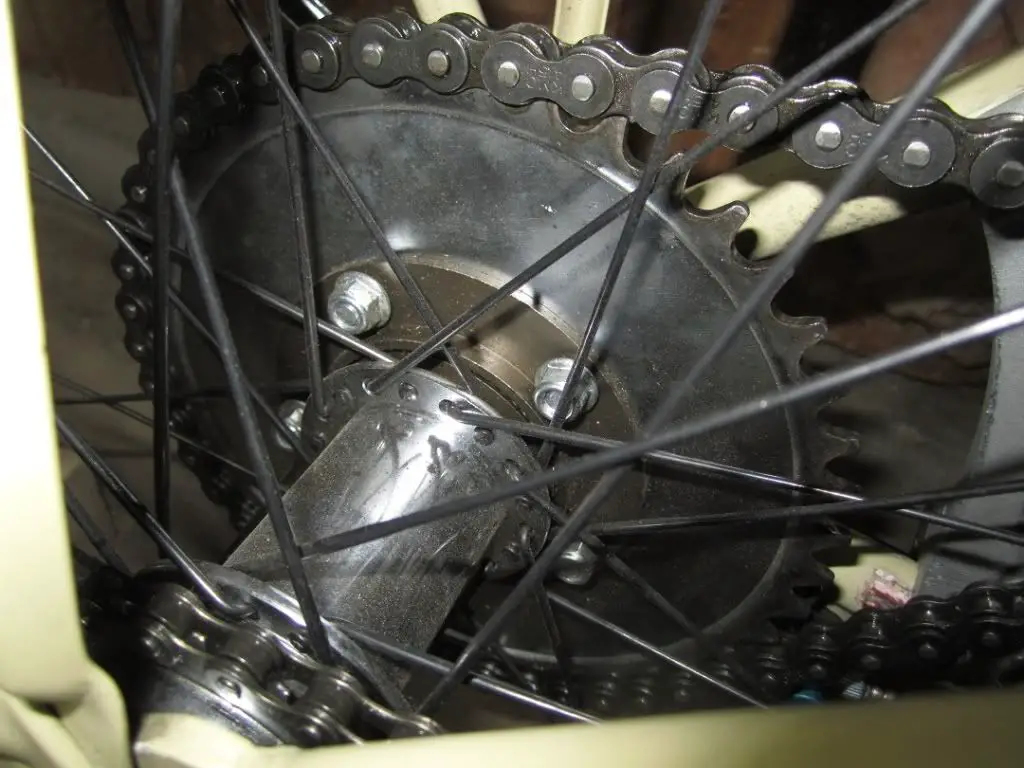

Back shot of the sprocket and drum brake.

what kind of rear brakes are these?

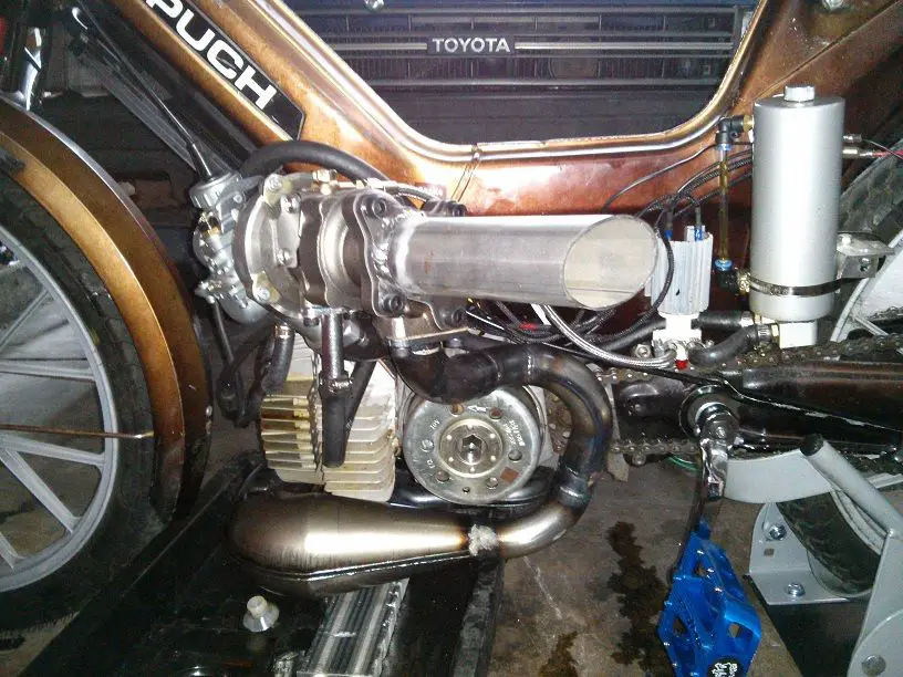

Because i've been working on this:
Hehe.. that is a turbo on a 50cc (kitted to 70cc)
WOOOH!!! show me more! case induction? oil 2 turbo? timing retard? seals? fuel? more! more! more! take it to grange!!!! drinks/food on me! dennis
