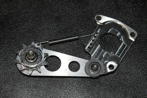

Machined Aluminum Spring-Loaded Chain-Tensioner

Hey,Guy's it worked slicker than snot on a brass door knob!
What I did first was scribe a line 1/4" along the outside edge where I wanted to cut then with a band saw,I cut as close to the line as I could.
Then I just finished it to the line with my belt"grinder".
Worked great!! even brought the gear cover below the surface of the mag cover.you can use your supplied hardware and clutch pusher bar nooo-problem!So clearance isn't an issue...Kip.

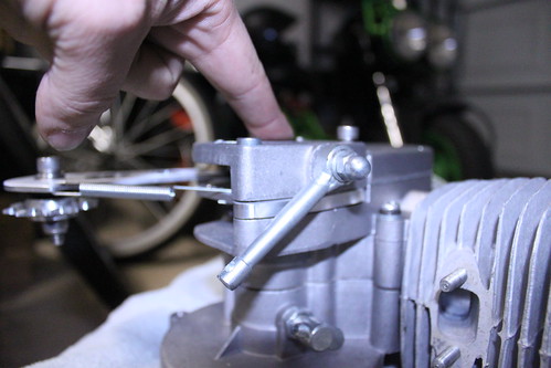

well done, so stupid question but the clutch arm still works right? Looking forward to getting my hands on one.
Hi,Miked.The only stupid question is the question never asked! Sure the clutch arm works just like the tensioner wasn't there.Pirate Cycle's is gonna have some the first of next week! Kip.

Does this only work with the narrow chains? Since the mounting platform is sandwiched under the gear cover, it looks like you cannot use the fat chains.

I would think that if you used it as an add on there would still be the same amount of space because the clutch cover comes out so far to acomidate the chain idler,(unless u trim the cover to size)
