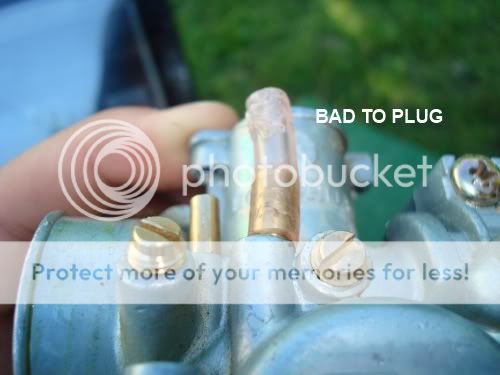

how exactly do you tune this carb, I bought one and it never worked properly, it would rev up and die as soon as the rpms would rise. so i just did what you recommended and capped all but the overflow but now how do I go about retuning? where do I get jets and which ones do you change other than the pilot?

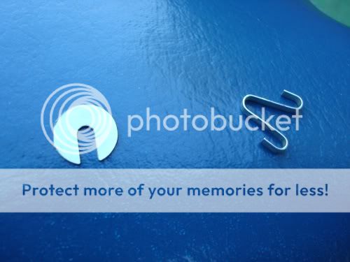

Old carb washer for clip/needle on left, new A style spring retainer thing from the CNS on right.
and combine the two so now the needle is getting pushed down, seems this fixed high idle, tomorrow will tell.

venlaw , do you have your left or right tube capped ? , as when i capped my right one it wouldnt run and wants to just die like yours was doing.

thanks for responce venlaw , in your last post there , new style spring retainer thing is it supposd to be sitting up in the air like that or laying down flat i realize you added the old clip as well just wondering position of the new clip if it should be up in the air like that from factory or somthing your trying out , as mine is laying flat down i hit 40 yesterday on flat road with no hills or air so shes running pretty good , just started my seccond tank on the 49cc from zoom , speed takin with my garmin oregon 450 gps
Venlaw
Apr 7, 2010
30
Canada
When I first took it apart it came out, so I have no idea how it was. :)
I guess lying down makes sense as it might be pushing on the c-clip then...meh, I like the old washer style better anyways.

I just bought one of these carbs too But I haven't have the time to install. I agree that the intake that it comes with seems cheap and very restrictive. Have we come to a concensous on which ports need to be capped and left vented? I understand that the bowl vent should be left open. Are the others capped?

right now i have the left sie one capped but heard i should be capping the right hand side one , bu when i do i bog down rel bad so not sre yet on this one :)

Because of all the feedback in this thread I decided to do a lil experimenting jus' to see wassup... and as it turns out I may have advised ya'll incorrectly. I removed the cap from the right port and stuck it on the left - and got a slightly better idle o_O
So I beg to be forgiven *shame*
It's interesting tho, I suffered none of the problems others had when they capped the right hand one... it was while I was doing it's initial tuning & break in & then I jus' left it be... but still, thanks guys for your insights - I'm glad for it as everythin' is as it should be with my carby now (^)
