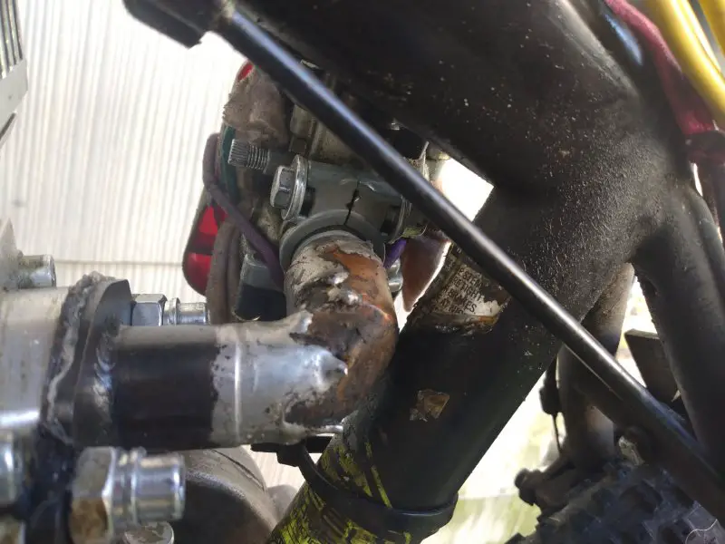

Something doesn’t sound right, 25 is more like a out of the box 48cc engines speed. I have two 48cc engine bikes that both do over 30 , I would think your port timing may be wrong, any carb should supply more than enough mixture to reach 30 mph.
About the only way to get full adjustment is like this.............Curt
I don't know how my timing could be wrong, I have a Athena 70cc cylinder on my bottom end? And how come I see people with same setup as me doing 40+mph on YouTube? Only diff I can see is our carbs?

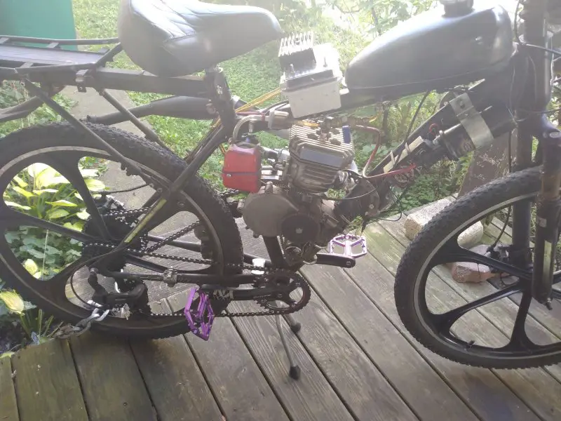

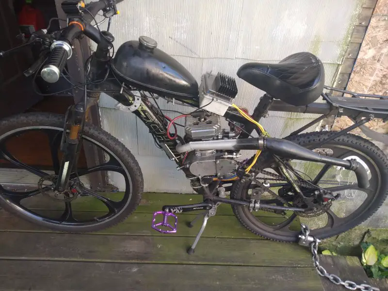

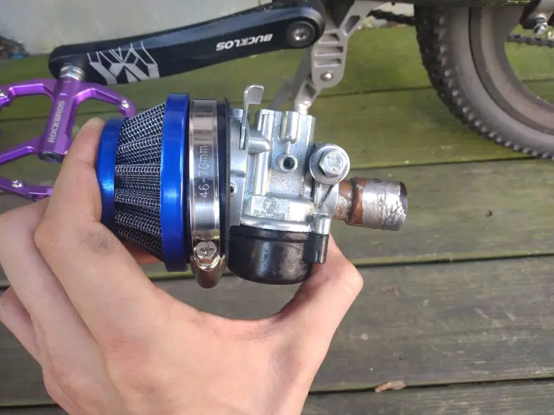

OK this is my 70cc Athena build with alternator (yes I know alternator affects top speed ..I only lost 4mph with it).... That aside

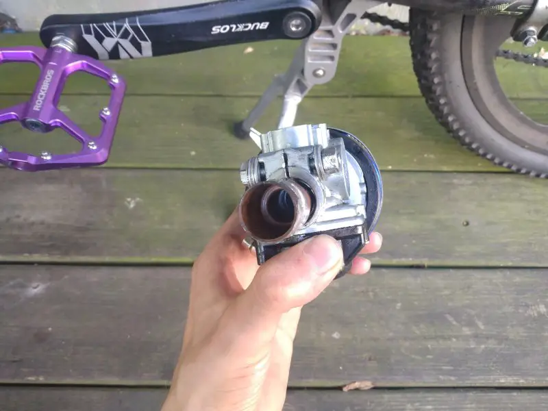

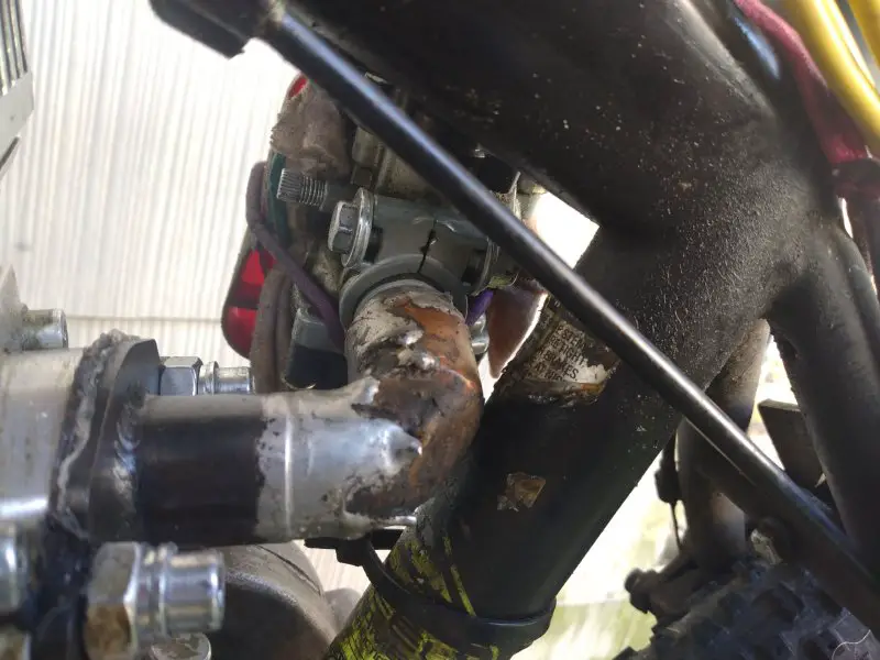

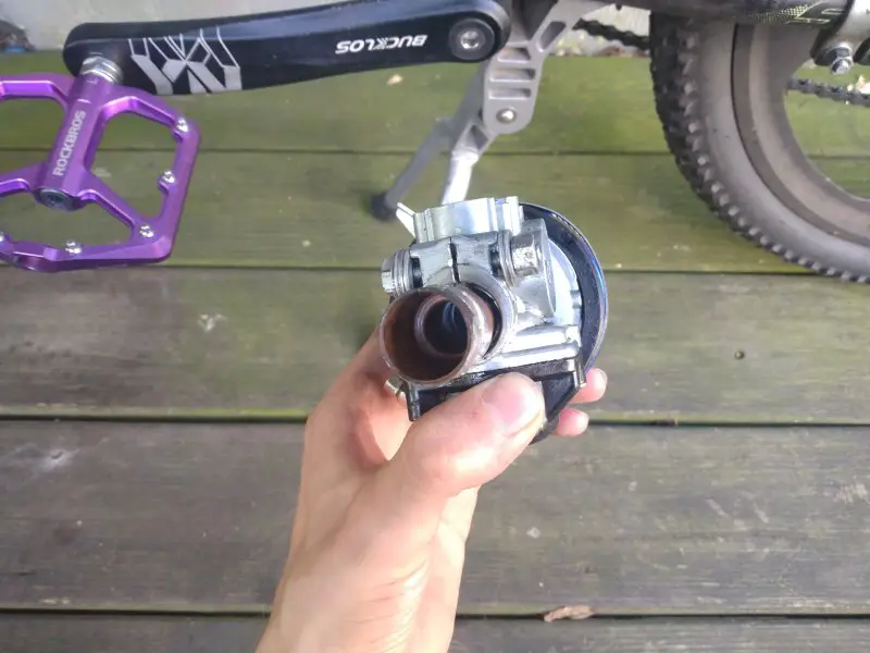

As you can see I'm using a VM18 manifold braised to brass fitting, I have no vacuum leaks!!!!
As you can see the brass fitting in the photo to accommodate the carb size is tapered compared to the actual VM18 size.... In comparison

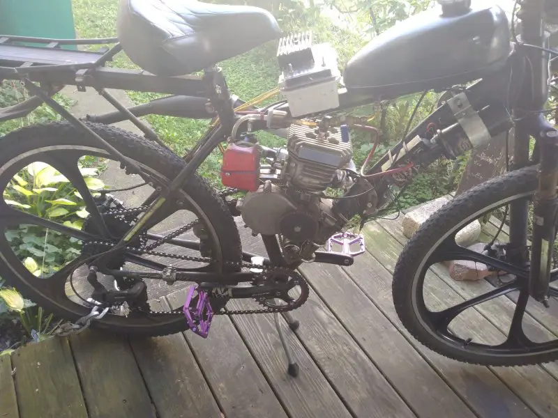

Slime tubes, tires with Kevlar lining
Bikeberry super magneto and stage 2 CDI
36 tooth gear sprocket
420# drive chain (motoredcycle chain)
This build also has ceramic full complement stainless steel crank bearings

I think my bike alone is almost 180lbs in weight
Its originally a thick framed
Shwin sidewinder mountain bike from Walmart
I tried one of those carbs and the only good thing about it was the auto choke release. Everything else was worse than my original. If you can’t beat 25 then you have something fundamental wrong. Try a stock carb for a reality check.
