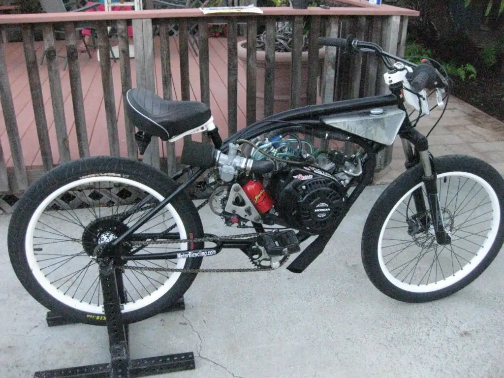

Here is mine...
Running a 36t and I can only get about 1/2-3/4 pad on it. But works great best thing I have ever done to this bike was add rear disc.
oh, and the rotor is a 180 the 203 was too big to fit in the space I had. So I run a 203 up front and the 180 in rear.
