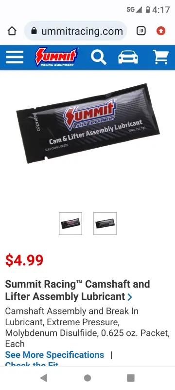

I've used joe Gibbs and the real deal leaded gasoline... The 79cc predator I've been collecting parts for has a decked head so it gets 98L... Even if the seats are hardened and the valves are stainless plus it smells like 1970... Should make an old school Briggs sing don't forget the cam and lifter assembly lube and the valve train likes it everywhere...

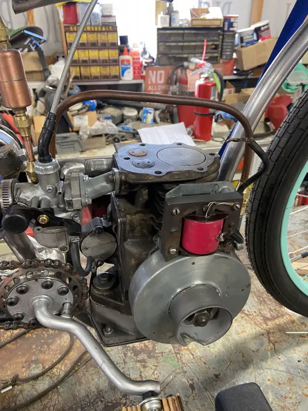

Well, two steps forward and three steps back ! I fired the engine up, tuned it, had it running like a sweet machine. I took it out for a test ride and and discovered that the Briggs 5S is just underpowered ! It just wouldn’t pull, so back to the shop and another engine. I have a 6S Briggs which has a 1/2 “ longer stroke and has been bored.020” oversized. Pulled it all apart, cleaned, inspected, ordered a gasket set for it and now I just need to get it reassembled. One thing I am going to do is shave .050”(thickness of head gasket) off the bottom of the head to increase compression. This engine should raise my HP from 3/4-1 to around 2-21/2. Time will tell.
I think I see the problem, your primary drive output pulley is to small, should be about 6" with about 2.5" one the engine, maybe even 2". My old 1.5 hp did about 25 mph. I judged mine after my factory made Monark twin, after engine fail.............Curt
I was looking at the pull-up set up as well. The 6S has a larger output shaft so I will need a new drive pulley anyway. I’m looking to go from 3 to hopefully 2.5 or 2.75. The driven pulley will go from 3,25 to 4.5. I want to get the engine together and running, check RPMs , and tuned before I make any major changes.

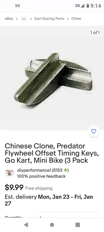

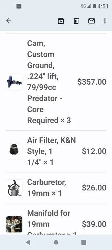

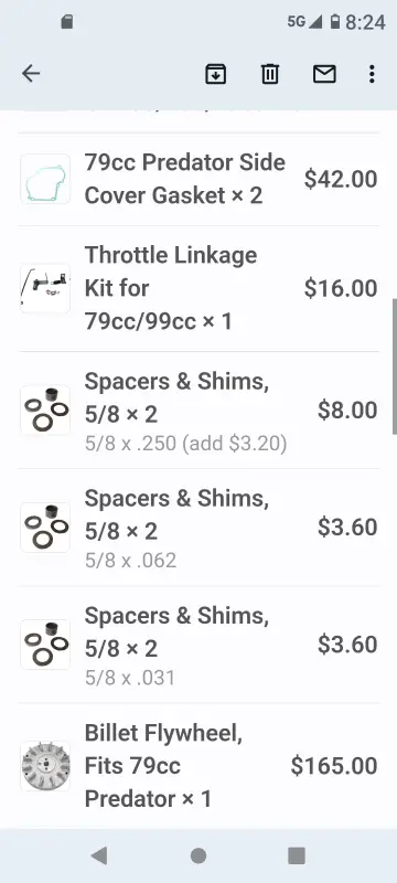

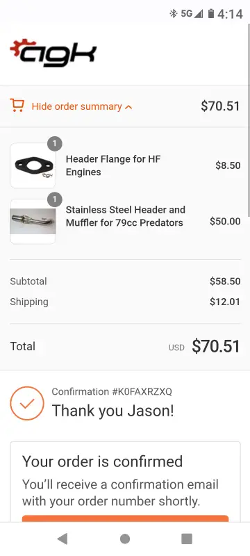

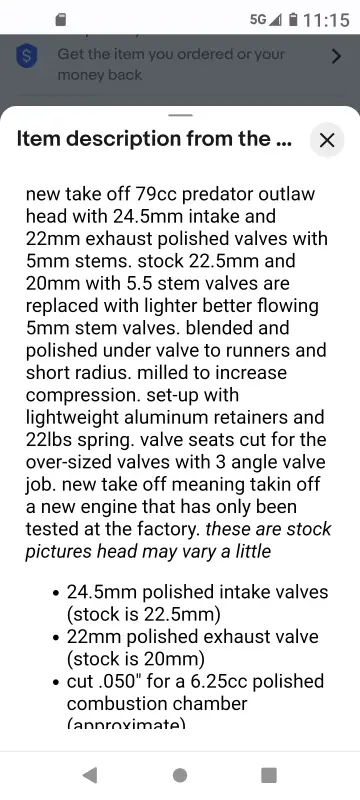

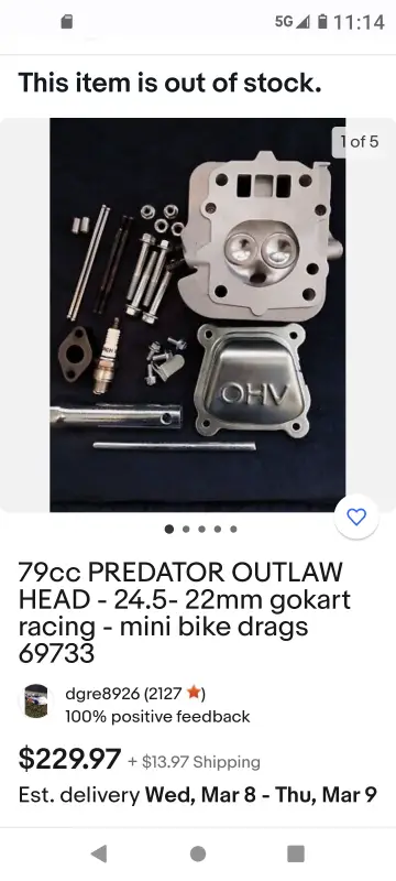

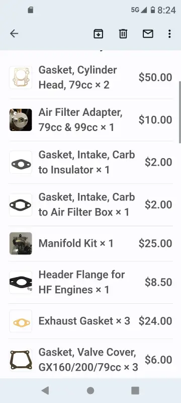

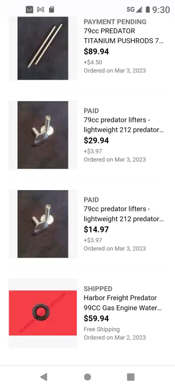

I'm putting together parts for a 79cc predator build from 3 to 7hp @6500rpm... AGK and ARC parts... It's a basket case another member lost interest in

I would have loved to do a flat head Briggs... the parts are just non-existent or in very tight hands... Same as the Maytag 72... But I feel better knowing that If something blew up I can find something for it... I don't have a shed full of old motors to paw through ;)

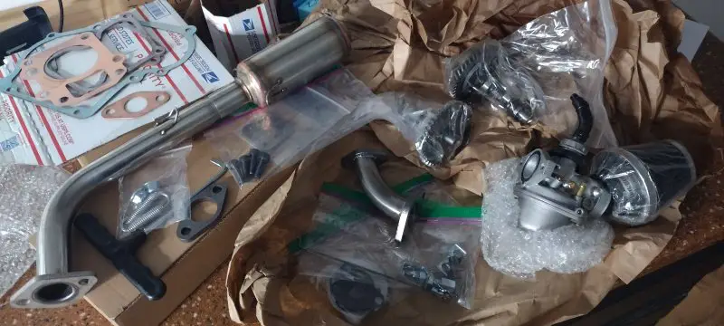

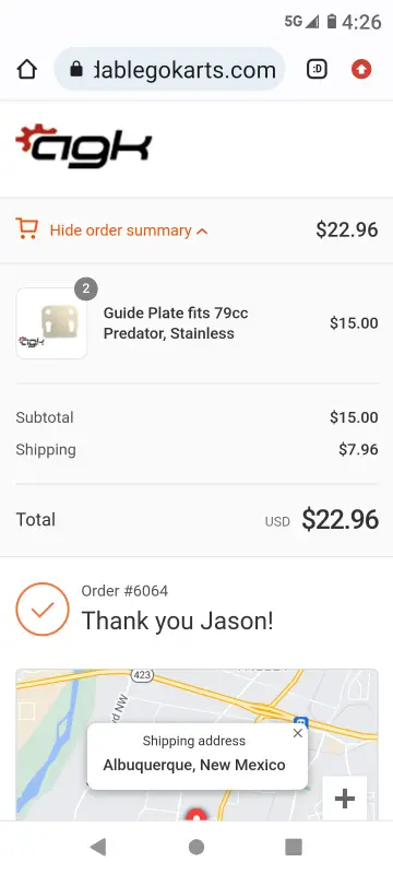

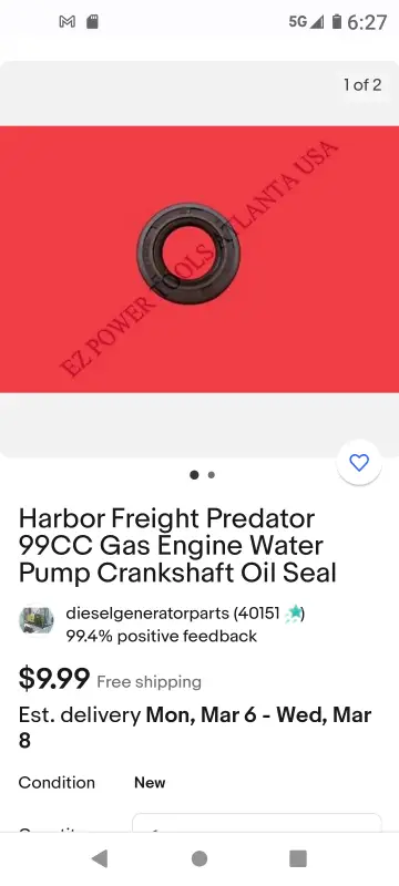

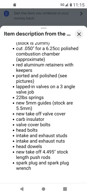

I ran out of room.... The build specs... Everything came from Degre8 on eBay and AGK and the impossible to find seal from diesel generator shop eBay

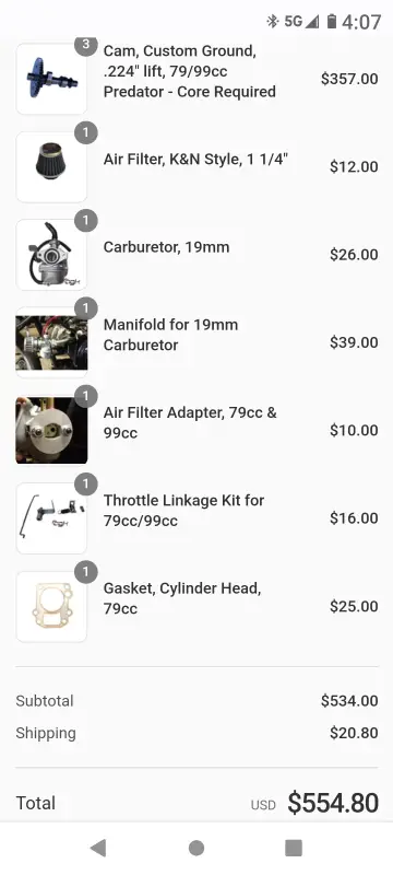

This was the final order... The engine and 30seres comet is the next bite... Those are plentiful so I go after the hard to find stuff first...

Every little bit helps... I'm hoping the 19mm carb and bigger valves make the most difference... I'm looking into 1.2 raito roller rockers for the 212/gx200 and a spacer for the valve cover... There con rod bolts with holes for wire I haven't researched few other things I can't remember ;) polishing compound for the crank... 1/4x 20 bolts for the governor holes... It's always something

Well I’ve been working on my replacement engine and I was in for one mild surprise today. I had the piston out and was inspecting the bore and rings. Bore still had cross hatch patterns from the last honing and the rings and piston looked great. Put the piston back in, went to torque the rod bolts and pulled the threads on one bolt. Pulled it back out and installed a HeliCoil, reassembled and retorqued it !! Found out that it had a 2 1/4 bore with a .020 oversized piston. All along I thought I had a 6S when actually it’s a model 8 which was rated for 2 1/2 hp. Bigger bore, longer stroke, bigger intake valve and intake port. My buddy picked up my head today and is going to mill .050 off the deck, which is the thickness of the head gasket. This should raise my compression a bunch and hopefully raise the HP up closer to 3- 3 1/4. My new pulleys should be here sometime next week or first of the next. Going to have to do some machining on the one pulley to press in a new bearing, and make a spacer to go between the two pulleys before I can weld them together. Getting more excited every day as the weather keeps warming up!!
