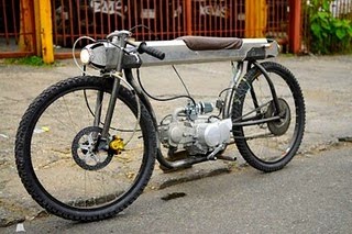

Supercharged Honda Dream 50 Cafe Racer 4 stroke racer

The Honda Dream 50 is one sweet looking ride.
Wouldn't mind having one
