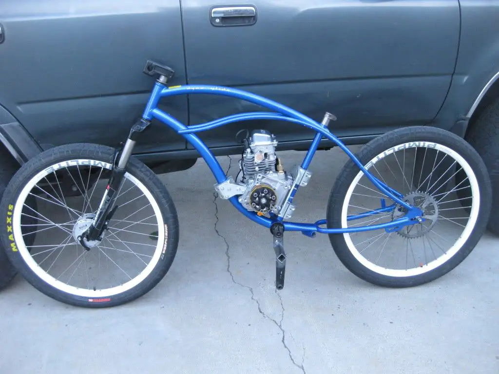

Is anyone interested in my version of a lay-back seat post? It is made from 1.5"x.375"x 5.375 long steel both ends are radiused and drilled thru,the stock size is, seat post 1.062 or 27mm 6" long. Set back is 5" and the seat stub is 2.75"long x .840" or 21.35mm, both the seat post tube and the seat stub are Tig welded top and bottom.They come primered ready for paint. I can make them to fit any bike.$20.+$10.shipping. The one shown on top is a custom order.I now can do Paypal.Kip.

What an awesome frame, sweetest I have ever seen I think. What is the brand name & year if you don't mind. The motor brackets are cool too.

And what motor, and mount is that on the blue bike above?
