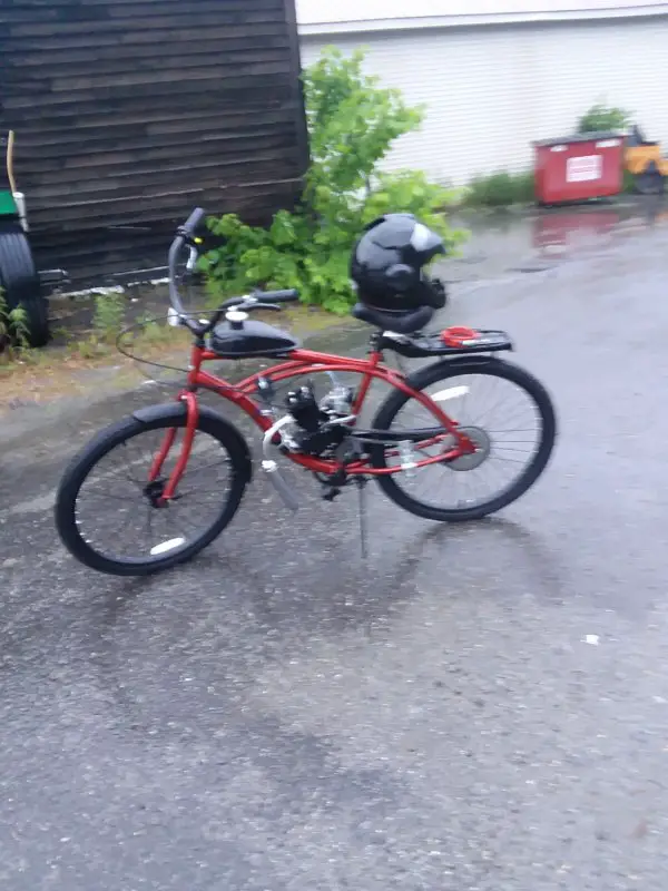

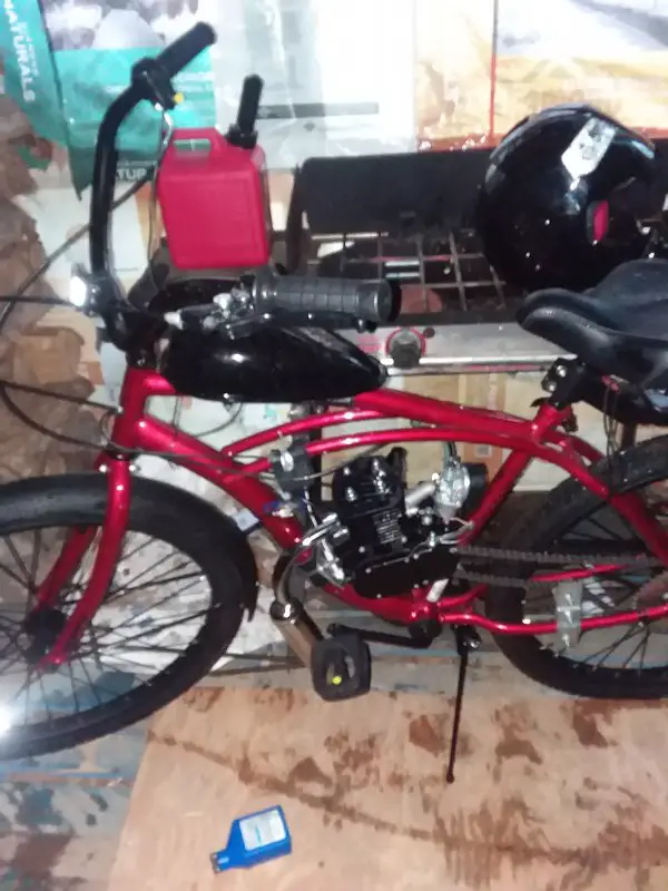

Hey there everyone! My name is Dave. I just finished building my first motor bike. Man is it fun to ride! Anything I should watch out for? 26" Huffy Cranbrook beach cruiser with 66/80 80cc motor 44t sprocket. I know I'm gonna have to upgrade the brake. (It's a coaster brake.)

Welcome Dave, I too have a cranbrook. You are right the brakes are a weak point, I added bmx style front brakes to mine, it made a big different. 96mm reach will work, mounts with the fender. Speaking of fenders keep a close eye on yours, they crack due to vibration, I removed mine to start .
