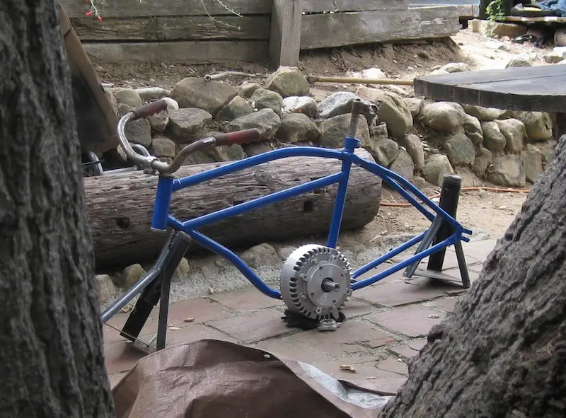

Jackshaft made with pillow-block bearings. You can see a shiny hole on the 1/8" mounting plate which fits over a weld bead on the frame. The plate also has a semicircular cut-out on the bottom that the horizontal part of the frame insets into. These features keep the jackshaft assembly from twisting around the frame under stress.
Possibly a novel location to mount a tensioner/idler. The idea was to weld on the frame as little as possible.
I'm quite proud of this petcock-style 3-way switch.

Nice job ;)
but the pics are just a little to close Stand back a little and click again so we can see how all the chains etc link up.

I used to use a jockey wheel on my trike chain tensioner, are you running the bushing or bearings? if the bushing you prolly noticed its quite loud? As you prolly seen i am now running a roller skate wheel for a tensioner, the noise, well...there really isn't any IMHO far superior method than the jockey wheel... perhaps a future 'upgrade' ?
Nice job all up anywayz...now..VIDEOOOOz haha
