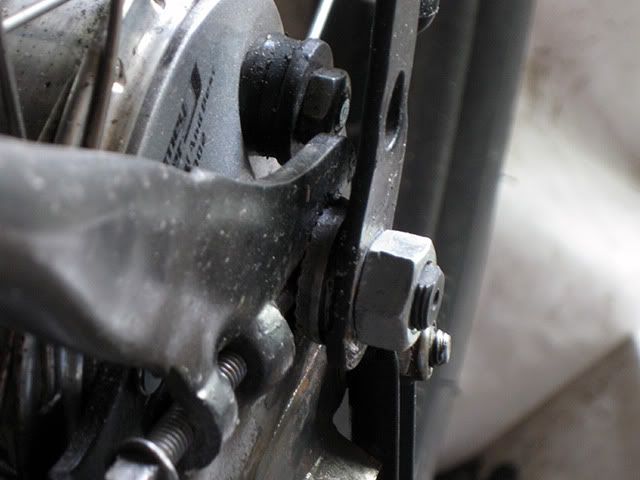

A somewhat common cause of tertiary chain derailment (crank to hub) is rear axle misalignment... With my ride the torque of the engine's pull will push the axle back out of the dropout a little on the non-drive side (horizontal dropouts BTW). While I've axle locks - they only keep the axle from moving forward so they don't help the far side from moving back :(
Tightening the axle nut more is the obvious solution and it does work - but it's a decidedly fine line between tightened enough to keep it from moving and stripping out the nut entirely.
I wondered how folks were fairing off on that style of drop out . I avoided that with my Morini j shaft set up. I can't help but think there is a fix for that? Somebody could be selling it if they drummed one up.
...erm, I shoulda clarified a bit - sorry 'bout that heh
With a regular axle, horizontal dropouts are a blessing (chain tension) but I've a three speed hub so it's got flat spots on the axle shaft to keep it from rotating - reducing the available threads for the nut to grip on.
I don't think torquing the nut down enough w/o stripping would be an issue with a regular axle, but that it should be checked is all.
