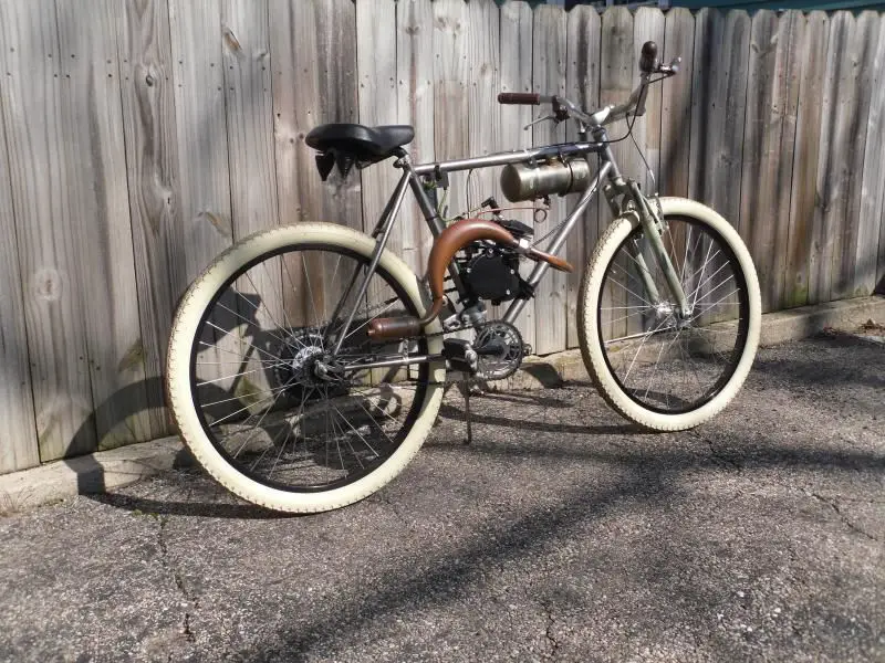

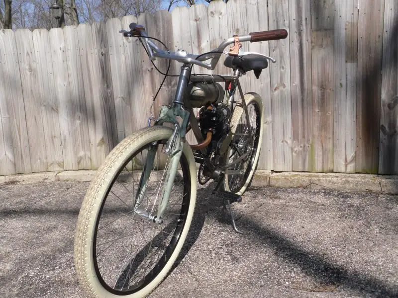

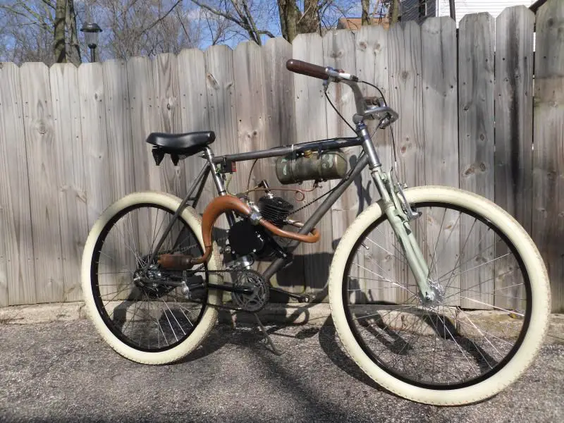

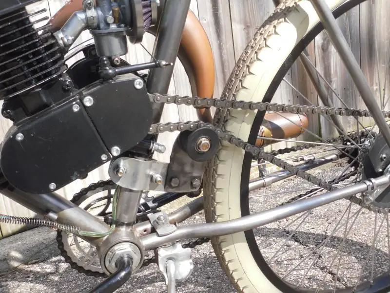

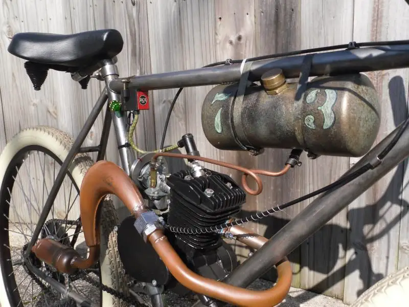

I am always looking at the forum but really don't have much to say and the very knowledgeable members are way better at answering questions then I would be. But I finally have my bike looking decent and about 90% of the way I would like it finished so I thought I would post some pictures , I know we all like pictures! Started with a 90's mountain bike and ending up looking like this, so it not's vintage but I have tried to give it a vintage look. Some ideas I got from the forum was the gas tank, its made from PVC pipe and end caps. Another Ideal I got from the forum was the modified chain tensioner, and clutch cable roller. As you guys know there is really a ton of work put into making one of these right so I wont bore you with all the details. Future plans are to make a head badge and maybe a sprocket adapter and slightly smaller sprocket. I bought a whole kit for my first build just so I could see how it all went together, but after just using the engine and sprocket from the kit, my next build I will just buy a engine!

Very nice! Great vintage vibe with very little actual change to the functional bike.
Looks old! (in a good way)

Ditto: You captured the vintage flavor. Nice work and thanks for sharing it with us.
Very unique and innovative motorized bike build.

Its been I while since I painted it but I think I remember. I first sprayed on a coat of black, then in some areas I sprayed green to look like aged copper or brass. I then painted the whole thing with brass or bronze spray paint. While it was still wet I smeared the paint with a balled up plastic shopping bag and a wire brush. I just used some stencil I had to paint the numbers on the tank. I then coated the whole thing with clear polyurethane to help keep it fuel resistant.

I'm Liking this soooo very much. Your exhaust and PVC gas tank look like old brass, nice job. The white tires tie it all together. Simple aliquant classy...

The filler is a brass piece used for joining garden hose together with a brass cap. The fuel shut off is for a lawn mower or garden tractor. I drilled the holes slightly smaller then needed, and being PVC plastic I cheated and let the parts thread them selves in. The tank has been holding gas for over a year with no leaks. I will try to find the original thread that I got the ideal from.
